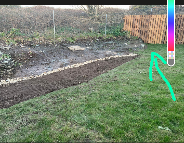

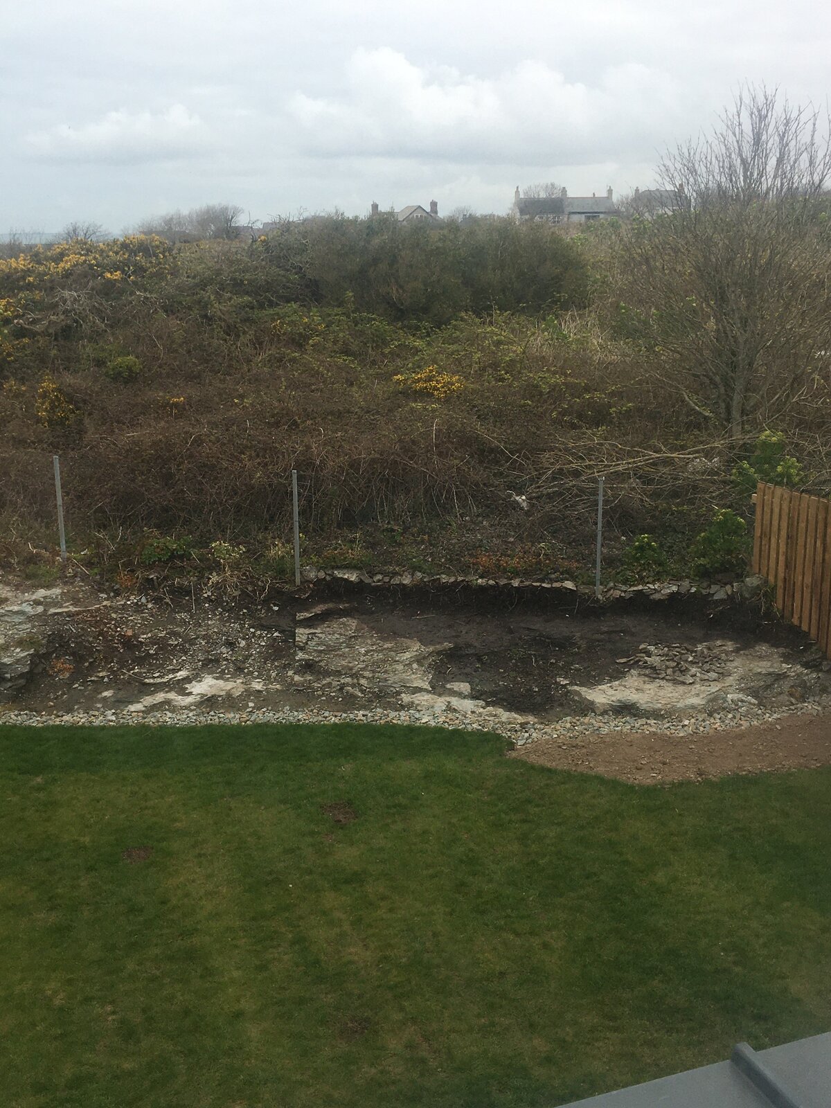

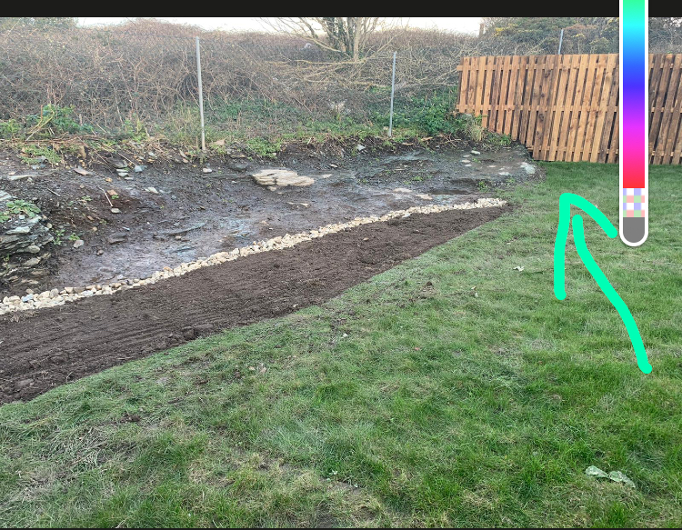

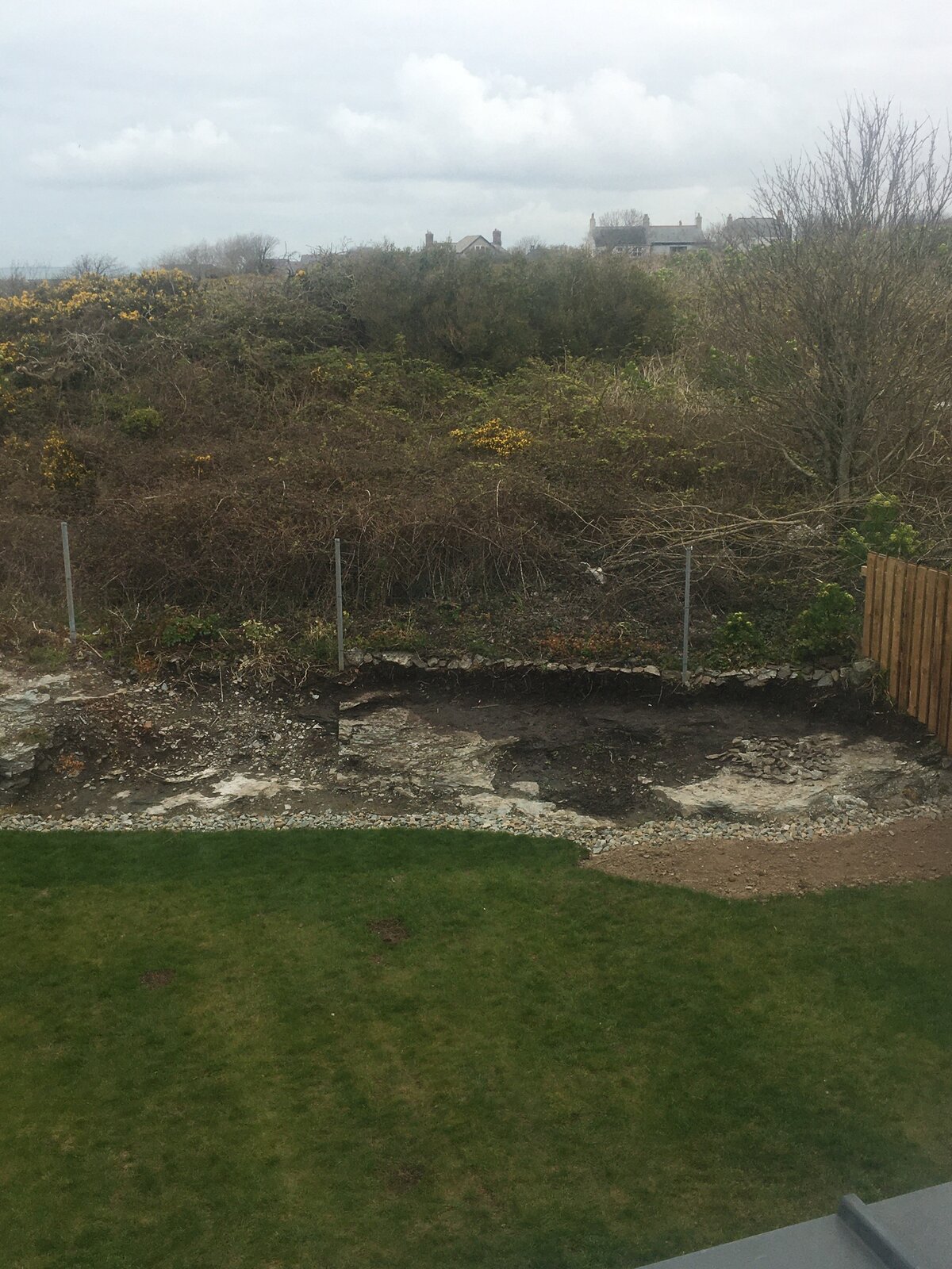

From where would the measurements for planning be taken if i were to put decking over the tock in the photo.
I’ve measure and it would be under 30cm in most places, but due to the slope of the ground, it may be higher as you move left.

yes to avoid the need for planning from the highest natural point it covers [adjacent to]
but be aware many in planning dont read the rules correctly so expect a battle even though they wont be involved
Does that mean it could be measure from the rock it covers?
