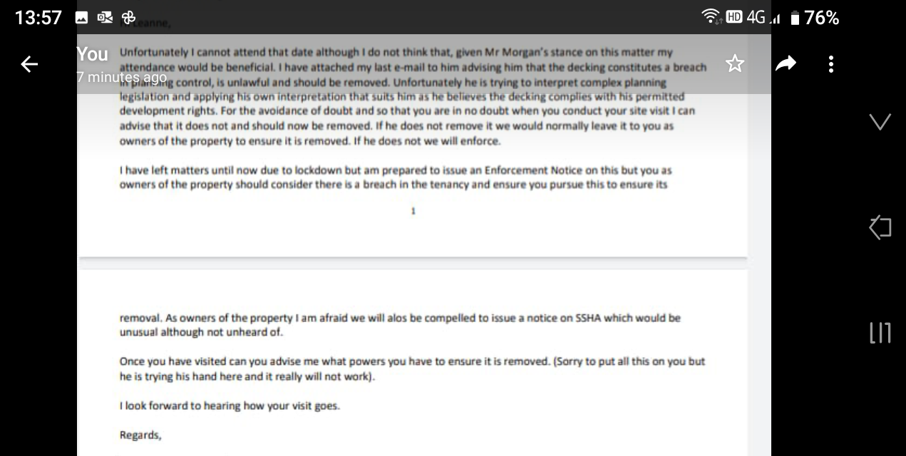

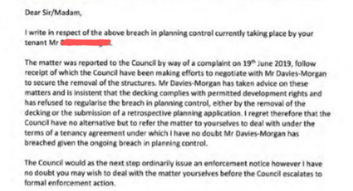

Did a subject Access request found these
Planning enforcement officer writing to housing association

Again, just sit tight. Do nothing and only respond if they actually issue enforcement. If they thought they were on solid ground they wouldn't be trying to get the HA to do their dirty work. It all seems a bit unethical to me.
Another interesting sar request has produced more planning enforcement bullying tactics
