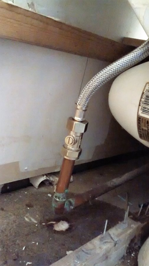

No, but I can call a local plumber, who might be sorting it all out tomorrow for 50 quid. Plan is to lower the water pipe, add a new valve, and use a flexi hose.

The end result:
Just need to put the boxing and carpet back together so it all looks like nothing ever happened...
