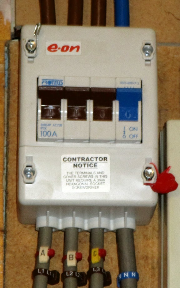

That's all true, as far as it goes, but it still doesn't answer my question ...
... why do they feel a need to put on an 'official seal' to prevent/discourage access to the supply-side terminals of an external isolator, when they obviously don't (couldn't) do anything to prevent/discourage such access when the same tails (always live, unless cutout fuse is pulled) are connected to the supply-side terminals of an isolator within the CU?

I can't disagree with any of that, but I'm not sure that even that explains the plastic seal (if that's what it is) on the cover over the load-side terminals of my isolator. I haven't bothered to examine it closely, but I'm not convinced that it (bottom-right in photo below) actually is a seal - is it perhaps some sort of 'clip' that can be removed without having to cut it? ...

I think it's a "tamper-evident" seal - very easy to remove, but shows when it has been. They are sometimes like a plastic padlock with a locking loop having barbs on it (like a cable tie) so they can be pushed in but not pulled out. Sometimes they have serial numbers, or have company initials moulded in. It is not unknown for people to cut them with great care and glue back together after.
Yes, that's what it looks like, but I was wondering whether it might not even have the barbs. I'll have a closer look sometime!
However, it still begs the question as to whose 'tampering' one wants to be 'evident'. Why would there be a perceived need for 'tamper-evident' seals at that end of the pair of conductors but not at the CU end?

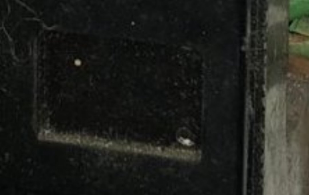

I can confirm this was a knockout - and despite it not being obvious in the original photos it looks to have been knocked out quite some time ago :whistle:
"not being obvious" would seem to be somewhat of an understatement! Are you saying that it had previously been 'knocked out' and then somehow 'knocked back in' again? Do I take it you're saying that you can get to the terminal screws through it?

I may just be seeing things, but when I look very carefully at the photo (and clean the area of my monitor) I can barely see what look like two small circular features on the recessed area that seem to line up with the terminals. I guess these are holes allowing access to the terminal screws.

Yep, and it just fell out when I brushed past it, odd isn't it. I can confirm that it is now possible to reach the terminal screws.
Your eyesight must be a lot better than mine (or your screen much cleaner!) ...
