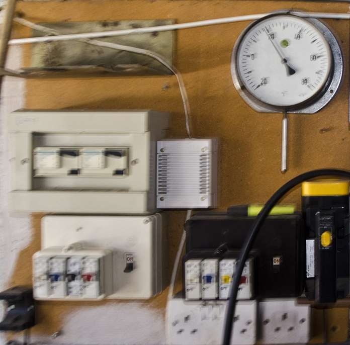

The Best practice guide 4 issue 5 has been taken by most as what we should do, I will admit there are some things I don't agree with,
to my mind this could be temporary, for example the builder drying out house after plastering as as not part of the fixed installation it does not come under the EICR. However this

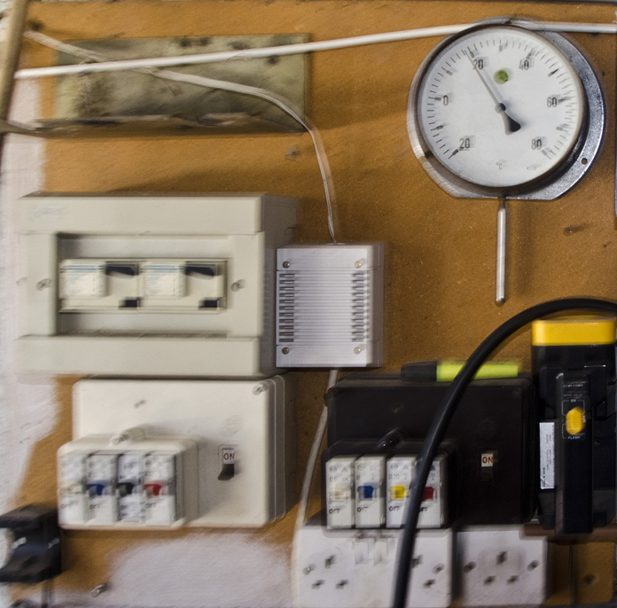

is still in issue 5, there is no way in real terms you can still provide satisfactory service if you need RCD protection, OK I know my old house Wilex-board-with-RCD.jpg did have two RCD's above the Wylex fuse boxes, but that enclosure for the RCD's is not type tested so could not be added today.
It actually has a section headed "Non-compliances with the current edition of BS 7671 that do not give rise to danger and do not require reporting" as I have repeated many times, C2 and C3 do not say "Does not comply with current edition for a new design" that was 4, which has been removed.
