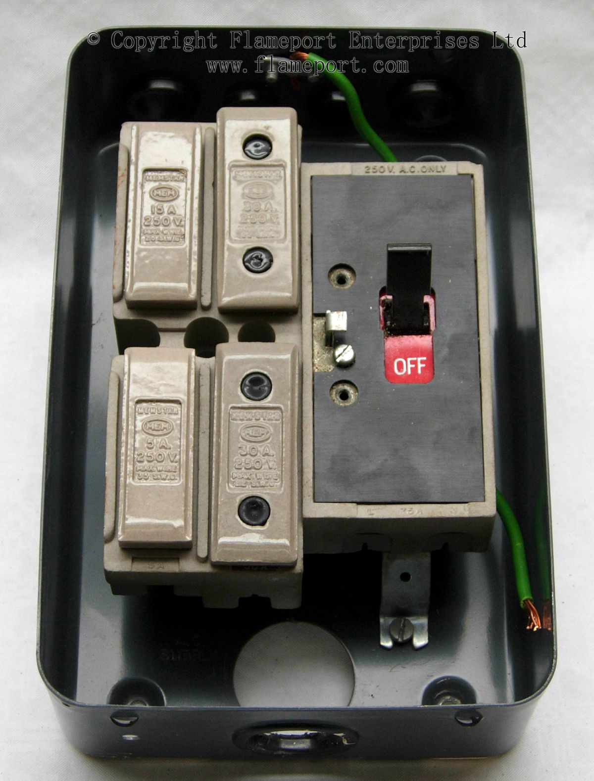

I don't have an issue with metal CU's per se, one only has to look at the larger (commercial) units to se they have pretty much been since the year dot.
Domestically they started as a board then enclosed in wood then cast iron then sheet metal. I have worked on all of those.
I don't know when the bakelite fronted Wylex originated but we changed the wooden fusebox in a 1951 house with metal Wylex about mid 70's.
My first house I fitted 2 bakelite versions 1983, one had wooden frame, t'other had Plastic.
Current home1994; I changed
to 8 way bakelite Wylex and about 2003 to square D plastic split load and then fitted mostly RCBO's about 2010.
In recent times I have been party to fitting dozens of metal CU's, although the stupidity irks me I just treat it as the silly neccessity it has become.
Given a free hand to fit a CU in an installation, metal or plastic wouldn't particularly bother me either way, both have advantages and disadvantages.
