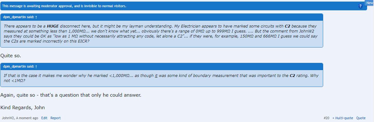

There appears to be a HUGE disconnect here, but it might be my layman understanding. My Electrician appears to have marked some circuits with C2 because they measured at something less than 1,000MΩ... we don't know what yet... obviously there's a range of 0MΩ up to 999MΩ I guess.
But the comment from JohnW2 says they could be OK as "low as 1 MΩ without necessarily attracting any code, let alone a C2"... if they were, for example, 150MΩ and 666MΩ I guess we could say the C2s are marked incorrectly on this EICR?
But if they're <1MΩ then it's a problem and I do need to find out if he (or anyone) will take on the remedial work if I don't want to have the Tenant leave the property?
If that is the case it makes me wonder why he marked <1,000MΩ... as though it was some kind of boundary measurement that was important to the C2 rating. Why not <1MΩ?
There appears to be a HUGE disconnect here, but it might be my layman understanding. My Electrician appears to have marked some circuits with C2 because they measured at something less than 1,000MΩ... we don't know what yet... obviously there's a range of 0MΩ up to 999MΩ I guess. .... But the comment from JohnW2 says they could be OK as "low as 1 MΩ without necessarily attracting any code, let alone a C2"... if they were, for example, 150MΩ and 666MΩ I guess we could say the C2s are marked incorrectly on this EICR?
Quite so.
Again, quite so - that's a question that only he could answer.
