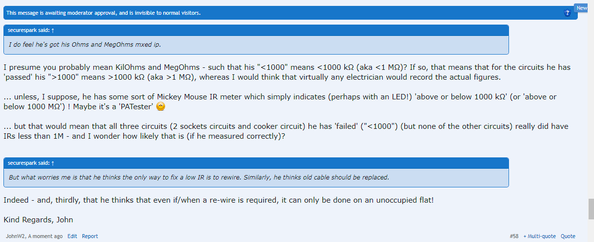

I do feel he's got his Ohms and MegOhms muxed ip.
But what worries me is that he thinks the only way to fix a low IR is to rewire. Similarly, he thinks old cable should be replaced.
And he cannot ID aluminium cable.
I do feel he's got his Ohms and MegOhms mxed ip.
I presume you probably mean KilOhms and MegOhms - such that his "<1000" means <1000 kΩ (aka <1 MΩ)? If so, that means that for the circuits he has 'passed' his ">1000" means >1000 kΩ (aka >1 MΩ), whereas I would think that virtually any electrician would record the actual figures.
... unless, I suppose, he has some sort of Mickey Mouse IR meter which simply indicates (perhaps with an LED!) 'above or below 1000 kΩ' (or 'above or below 1000 MΩ') ! Maybe it's a 'PATester' :)
... but that would mean that all three circuits (2 sockets circuits and cooker circuit) he has 'failed' ("<1000") (but none of the other circuits) really did have IRs less than 1M - and I wonder how likely that is (if he measured correctly)?
Indeed - and, thirdly, that he thinks that even if/when a re-wire is required, it can only be done on an unoccupied flat!
Kind Regards, John
