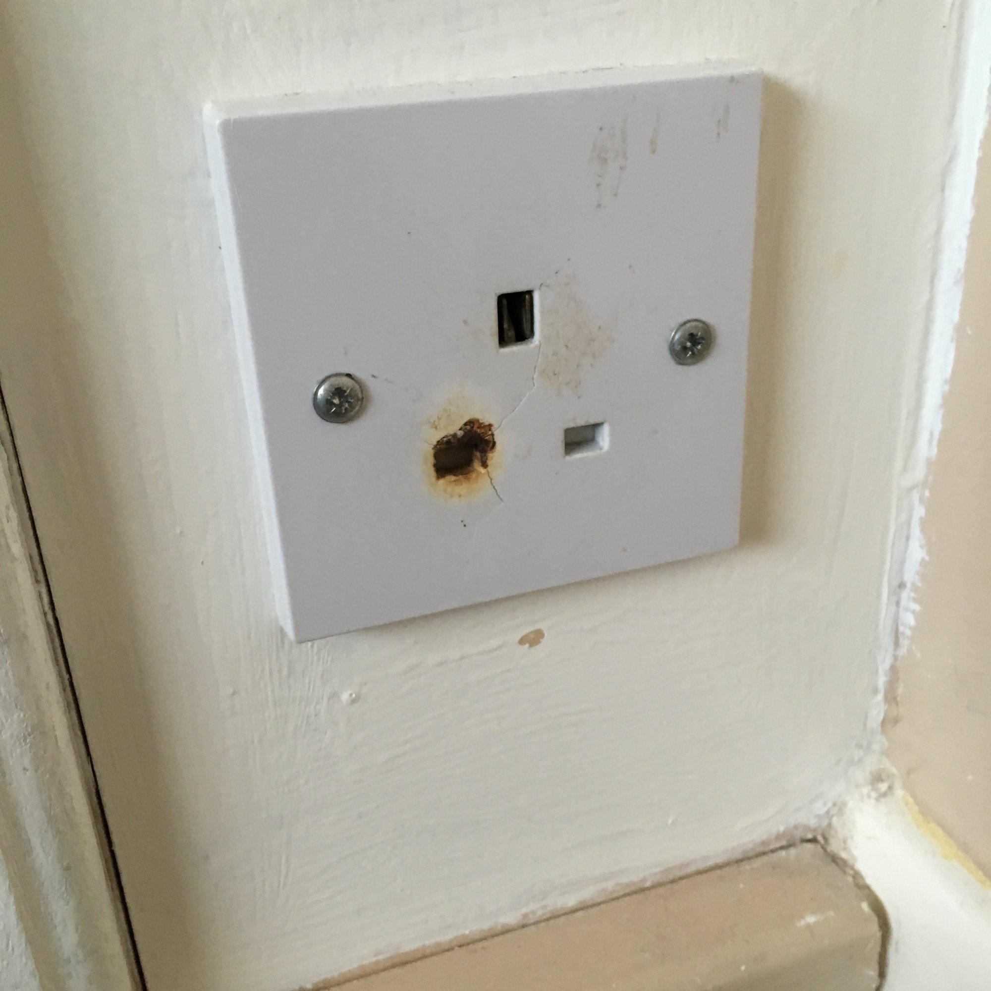

I've also noticed one of the bedroom sockets doesn't look too healthy but this wasn't picked up on the report.

The socket is code 1 (cracked and signs of heat damage)
It should have been picked up if it was present/accessible at the time of test. It is unlikely/though possible that it has occurred since the ECIR. However it might have been behind a heavy piece of furniture which could not be easily moved (the limitations section should have wording to cover this situation)

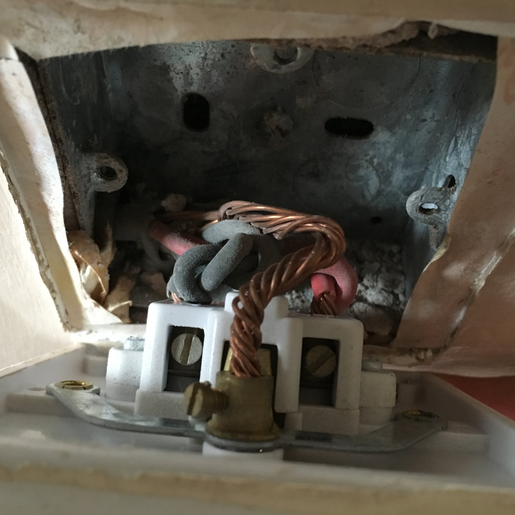

It also looks like it might not be on a proper back box

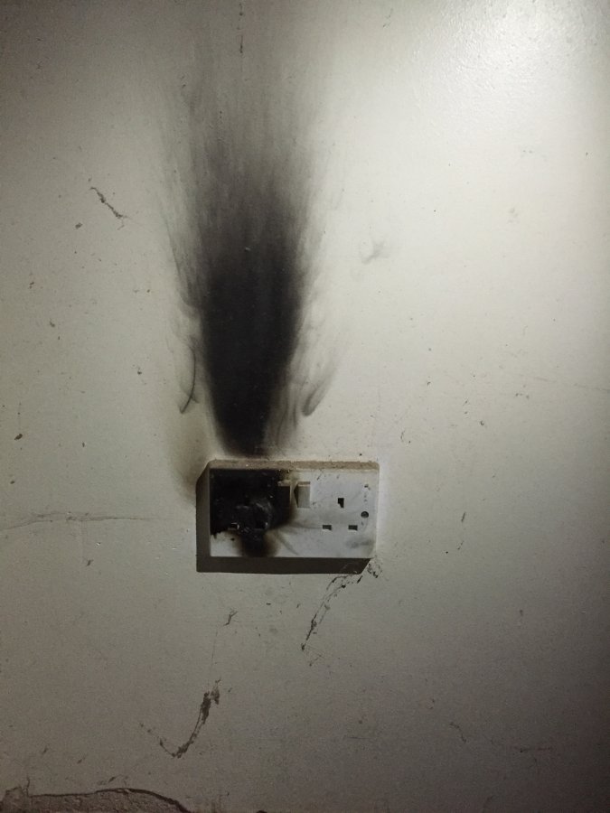

Nothing wrong with that socket! :eek:
Found this one on Friday....

Clearly that socket needs replacing. What we ask is how good was the EICR? One of the most important tests is if the ring final is still a ring final, then we look to see if there are any unfused spurs from spurs faults there can cause overloading, we also look that there is an earth to lights. After that point it depends on the guy doing the EICR many electrical firms will do a very good report as it can generate work for them, however there are also firms which specialise in doing the report and some times the report is a little lacking, they give the electrician a time for the job it does not matter if he spends 4 hours or 8 hours he is paid by the fixed time and he is given a list of properties so if he is fast he may squeeze in an extra test so giving him more money, it is not called a bonus but it is in real terms and it encourages the electrician to miss items.

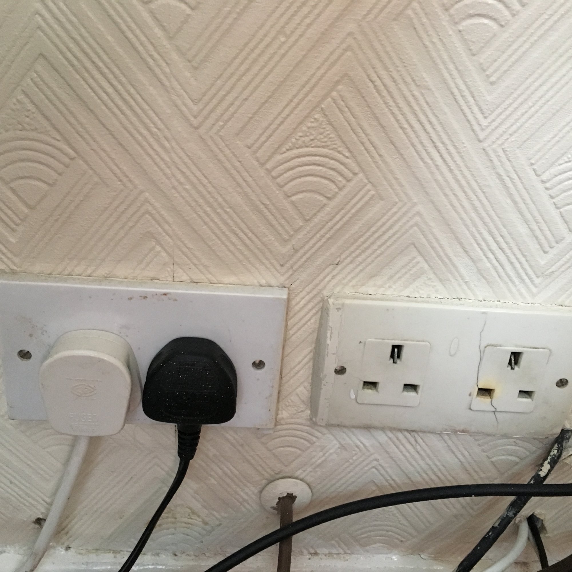

Sorry, I wasn't being clear - satisfactory overall, general condition satisfactory. Both in section E.
I've rechecked the pictures of the house pre-sale and there was nothing in front of it. There was a bed in the middle of room and looks like they didn't bother walking round the other side. The socket is actually in the housing next to a wardrobe door.

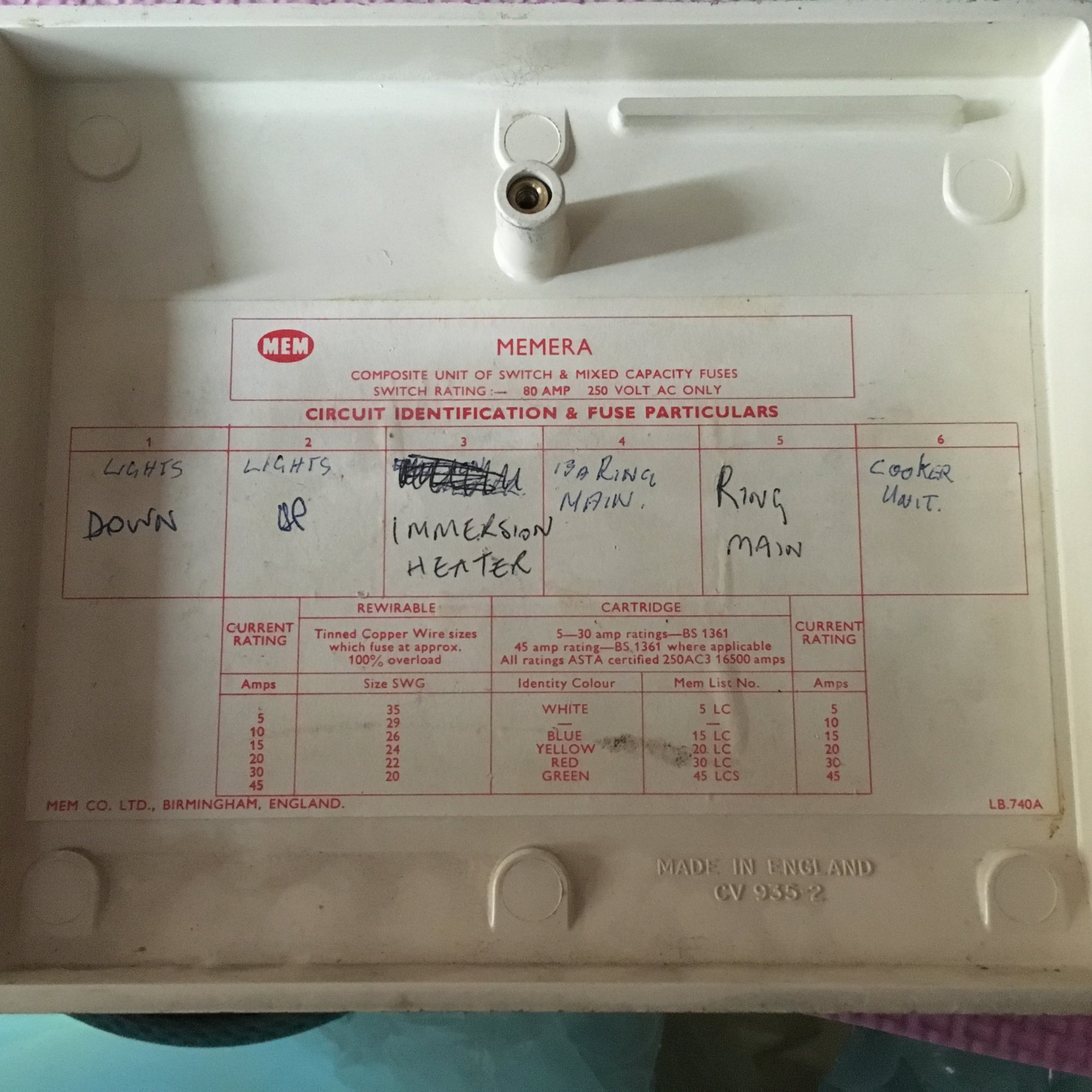

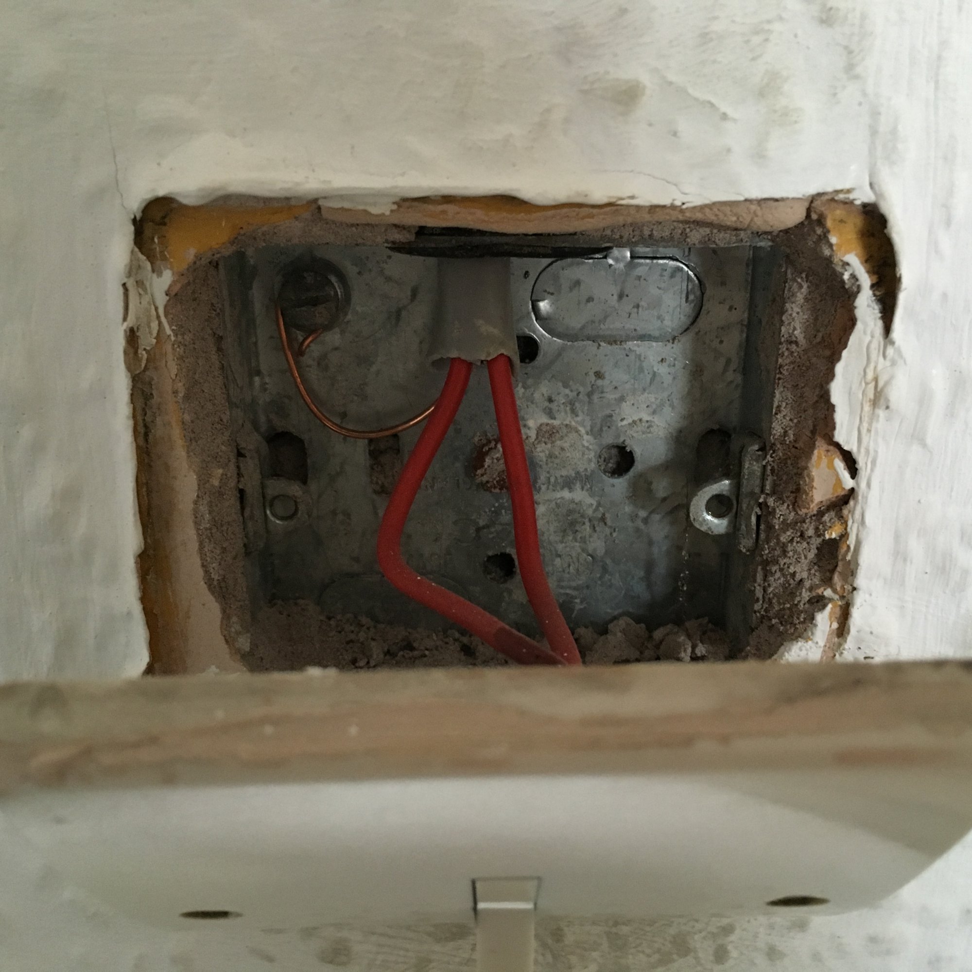

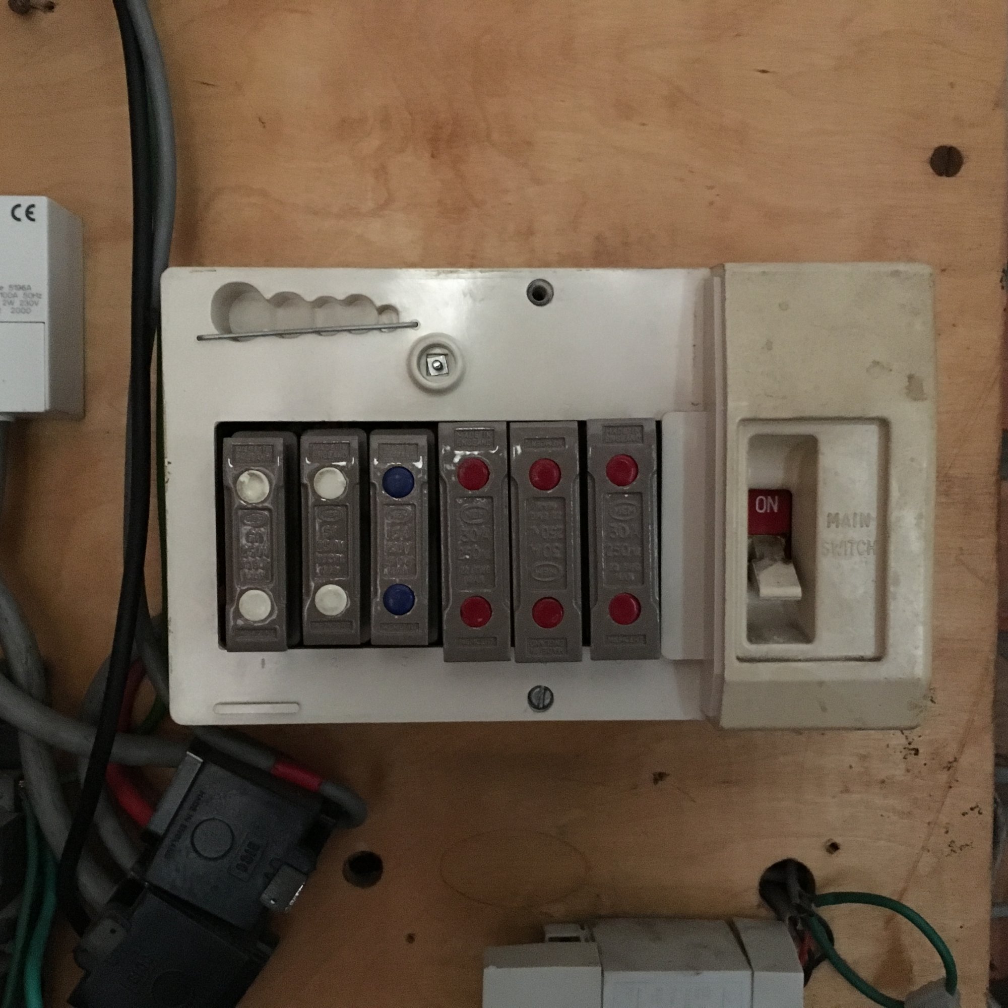

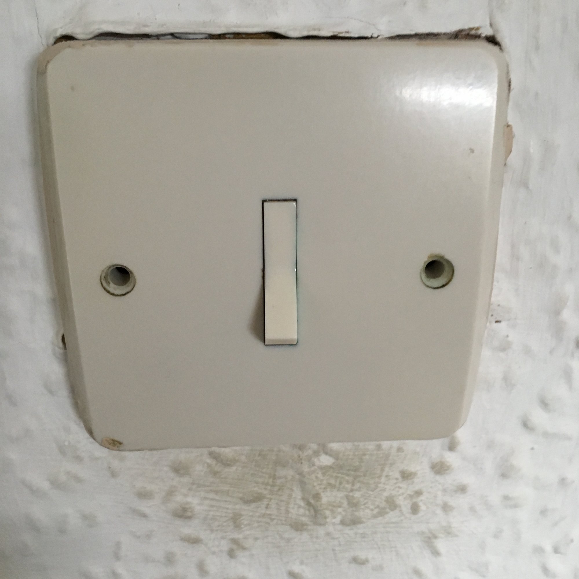

Some pics

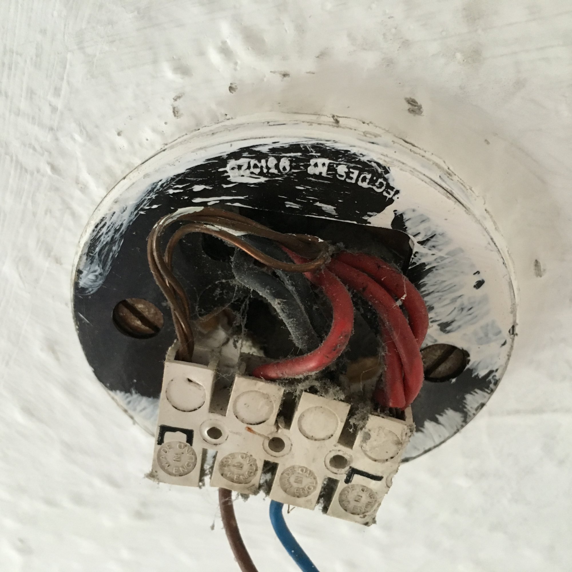

Upstairs light
Upstairs single socket on landing

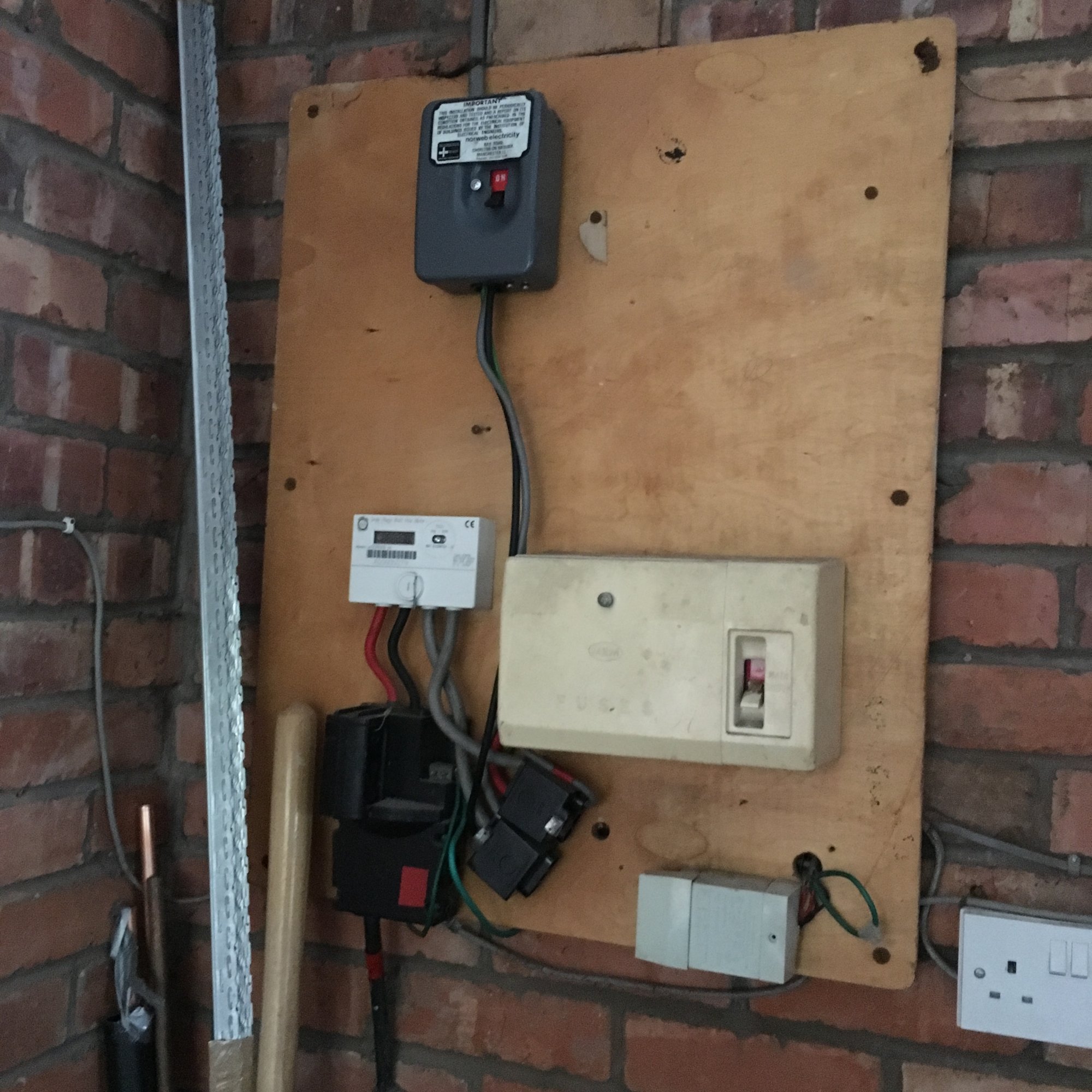

Distribution
Also found another socket in lounge that looked a bit damaged

The other thing worth mentioning is that from talking to the firm who setup the EICR, it had to be done over two days, the vendor was not being co operative with the power being shut off for long periods as he was trying to do some work at the same time!
Those Henley blocks look amusing. And the cables running from them to that metal isolator look rather undersized, as does the bit of T & E coming out the top of it (all only protected by the main supply fuse). Be interested to see what the EICR has to say about them :)
Not sure them mem boards were around in the 90's id quess nearer late 70's, i think unswitched sockets and 2 core red were a 70's thing too, id say theres room for improvement from what you show
That label on the switchfuse, is there a phone number, the area code sometimes dates the label
