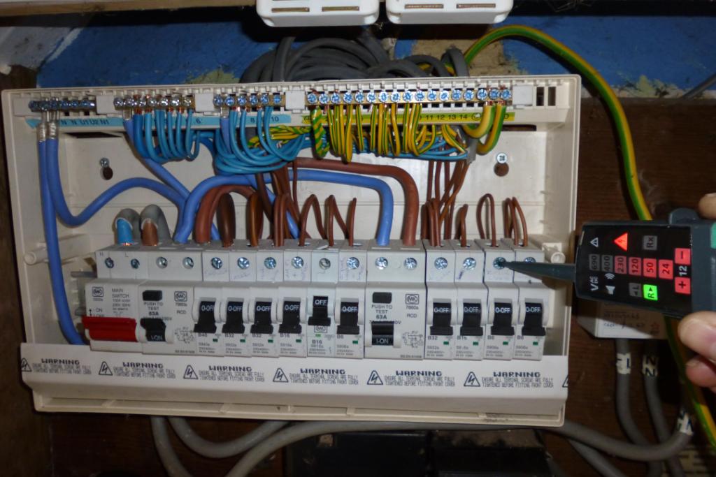

I wonder if our man would have identified the fault I came across today during a t+i.
MCB terminals tightened to the point of breaking the mechanism and preventing the contacts from opening. I also replaced MCB 5 as you can see in the photo the terminal at the top has been over tightened and buckled.
Interesting to see an example of a failure caused by overtightening.
There don't seem to be too many examples, other than that DB fire in that National Trust property. Strangely enough this CU was in an NT property...
