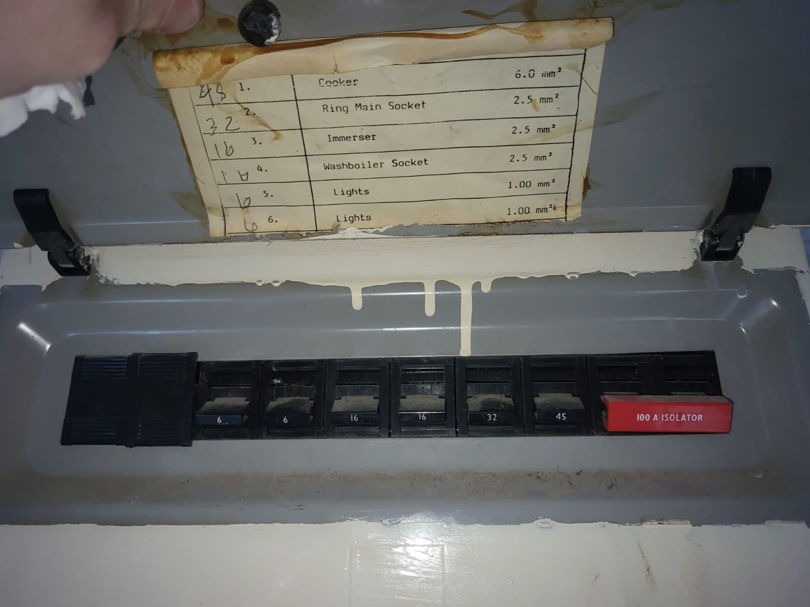

One guy spent his time only at the CU and the other walked about turning off water and not doing much. He didn't have a machine to test anything. Just walked about.
Did the guy at the Consumer unit have any kind of tester? How many circuits? Regardless of the time taken this wasn't done correctly if the guy walking about didn't have any Test equipment, he'd need to check socket measurements/polarity at the very least and RCD trip times if you have any? Why they had a need to turn the water of is very odd.
Do Not Pay them
Yes the guy at the Consumer Unit had a tester with him.
But just everything else and the short time taken clearly was a scam.
I asked the guy why are you turning off the water? He said we will get in trouble with the boss if we don't.
There do not appear to be any RCD's..
Extremely odd, and I cannot imagine any valid reason to do that - perhaps they were part-time trainee plumbers?

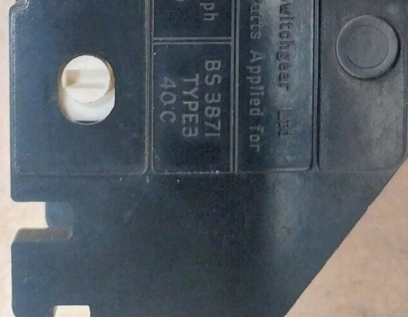

There was a similar thread on another forum where we got a picture of the consumer unit 1712564145864.png which seems to be the old Dorman Smith LoadMaster type. I have seen them listed on the internet as C curve and type 3 but the problem is they need removing to read the type 1712564537856.png as written on the side. I know it was 1 to 4 before we went to B to D but I can't remember off hand what a type 3 curve was? and clearly we have no idea what the type is. I remember using them in the early 90's but even then they were old. As to young lads knowing the old system!
But the guy at the cooker would have needed to test the loop impedance.
I would recommend a change of CU, as to if code 3 or code 2 not so sure, I know the regulations say what date they apply, but that's OK if one is given paperwork stating the design date, other wise one must consider it was designed yesterday.
