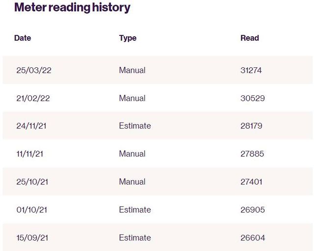

Has anyone got any thoughts on how we can monitor electricity use at home. For over a year now we seem to be using soooooo much electricity, even before the price hike and us being in a fixed contract we ended up in £600 debit on electricity only. We dont have a smart meter, well we do but its not active on with EON, it was installed by First Utility years back and EON wont do anything with it.
EG: see image for meter readings! I have some single smart plugs with energy usage tracker on them but i think we have something else going on thats churning them units and i have no idea how to work it out. Ive looked at smart meter equivalents:

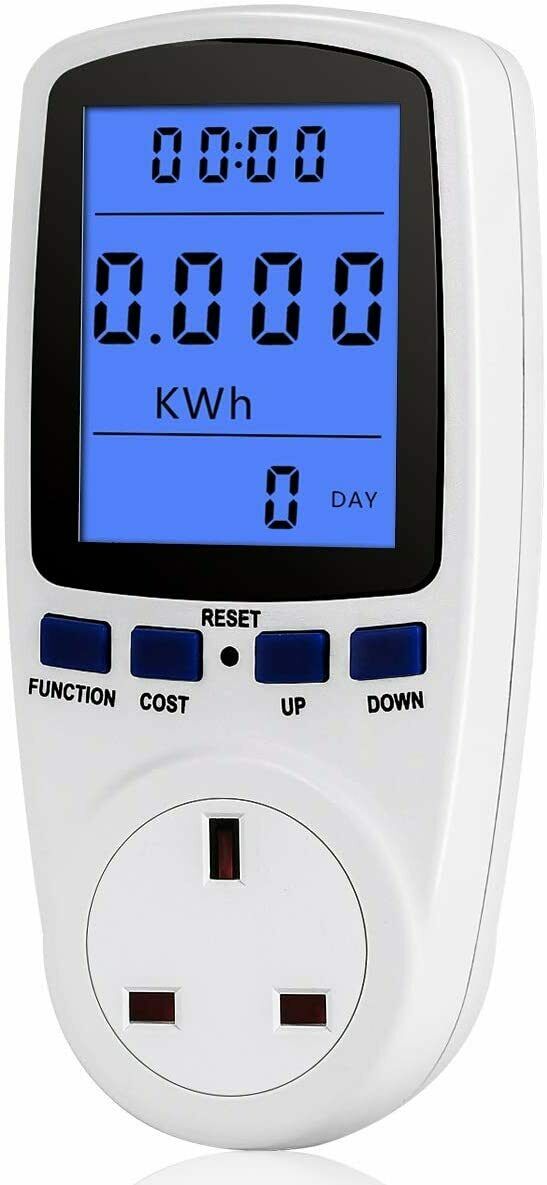

like this?
so you can use one on your fishtank.
I have one and they are well worth while having and using, just so you know what you are paying to run what. Plug your tank into it for a week and see what it is costing you to run it. In time for next autumn, swap every regularly used light for an LED version.
If you have one of the older smart meters, you will have an indoor display, which will still show what your instantaneous consumption is.
However - those consumption figures do not seem excessive.
~20 kWh/day doesn't seem excessive at all.
I have just looked again at the figures and I make it 26Kwh / per day, which is quite a lot. Mine, on my own at the moment - 3 bed semi, gas heated, gas cooker and hob, electric shower with gas heating available 24/7, but lots of electronic gadgets averaged 5.4Kwh per day.

I am a bit surprised that your UFH only uses 0.70 kWh/day
It looks like you have only identified about 8kWh/day so far
so where are the other 16 going?
