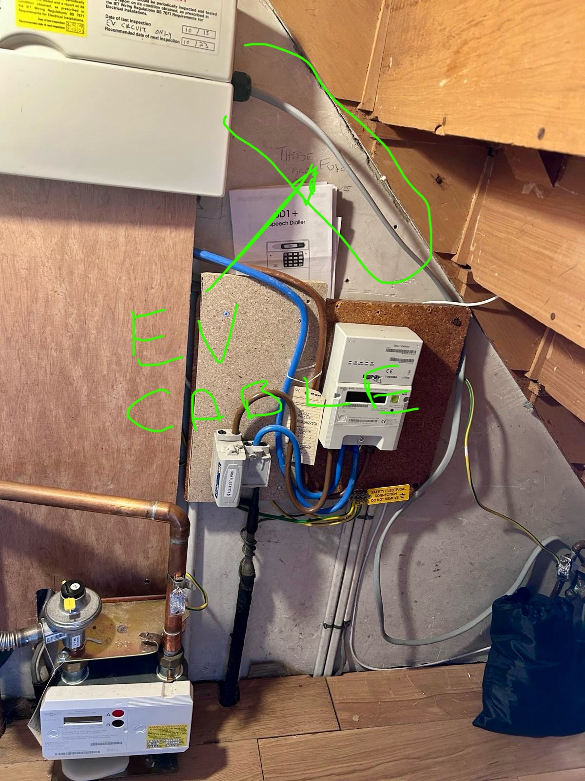

The way my install is, the consumer unit is under my stairs in the middle of the house, and 6mm twin and earth (2x6 +2.5) was used and all signed off, and tbh, have never had any issues.
The cable is chased into the wall slightly, then drops under the floor and is clipped along, to the front of the house, where it then is chased up the wall slightly, and out into a junction box.
From the Junction box, I’m assuming they have used SWA cable for that short run upto the charger.
I want to get my electrician to replace the unit, which he said would be an easy swap, as the cable is capable of carrying 47A and there is minimal loss as the cable is not insulted in walls or conduit.

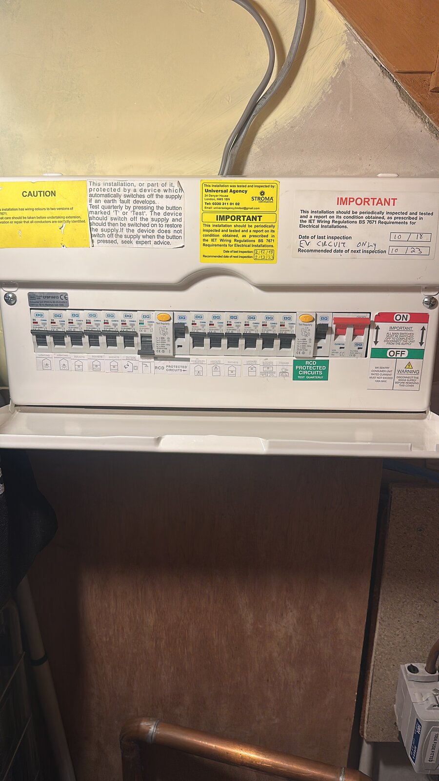

First things first could you post a photo showing your consumer unit / fuse board?

But my query is the actual Twin and Earth (2x6 +2.5) that is currently there going from the consumer to the EV junction box.
Some are saying it has to be 3 core (all 6mm), but others saying the current wire I have is fine.
So basically it will be Twin + E run from consumer unit to Junction box under the EV unit, then 6mm SWA to the EV unit.

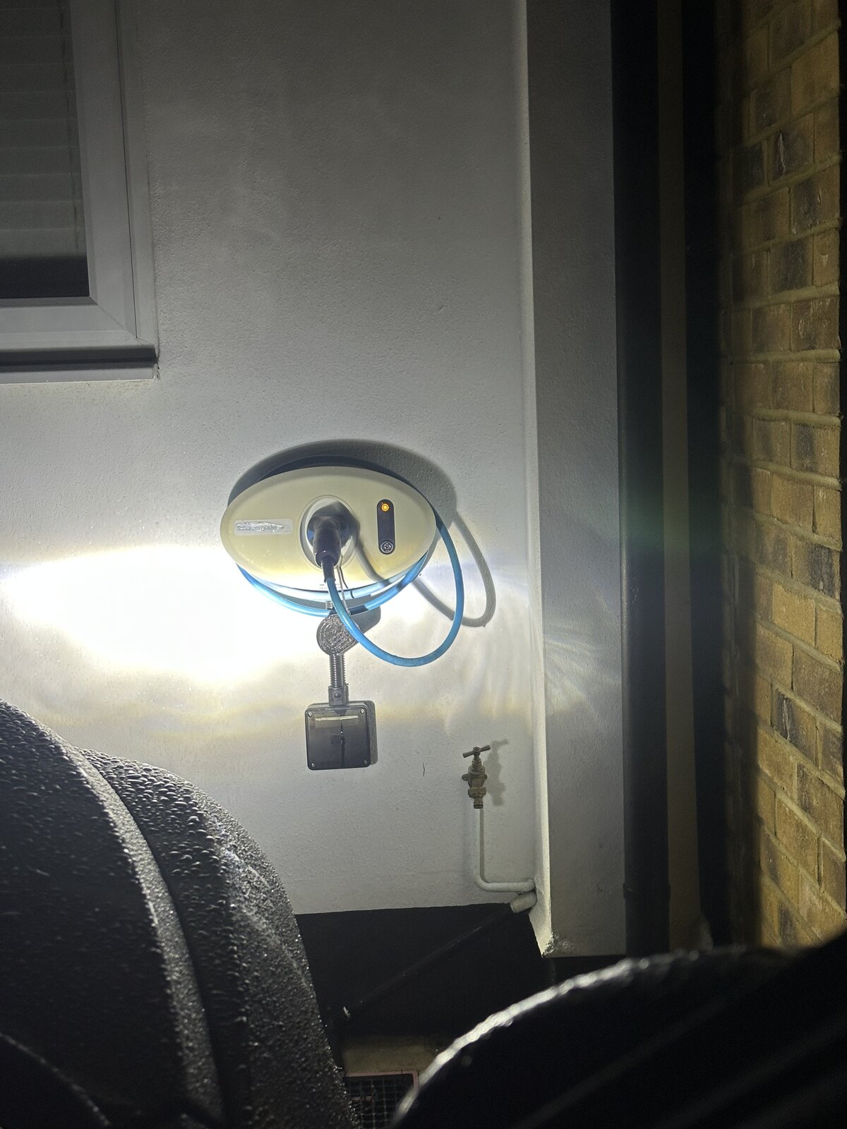

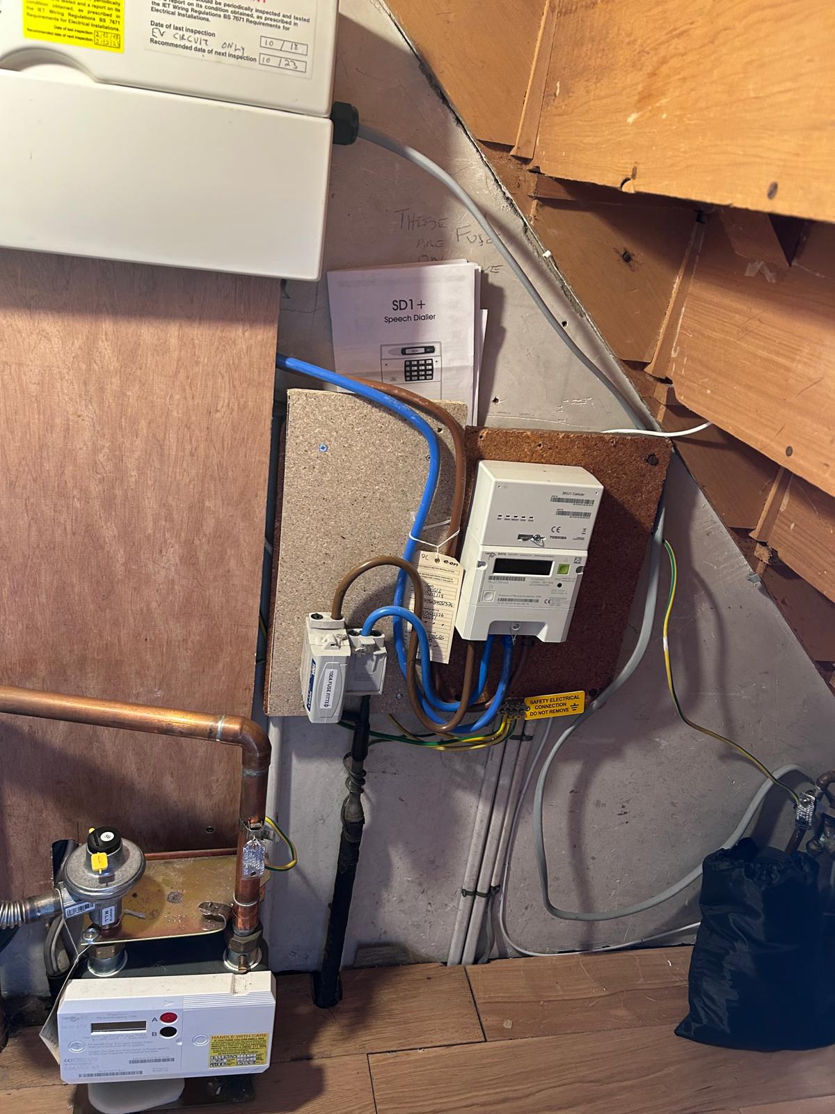

I’ve attached photos of my current fuse board, and also where my current charger is.
As I mentioned, a separate consumer unit will be installed for the new charger.

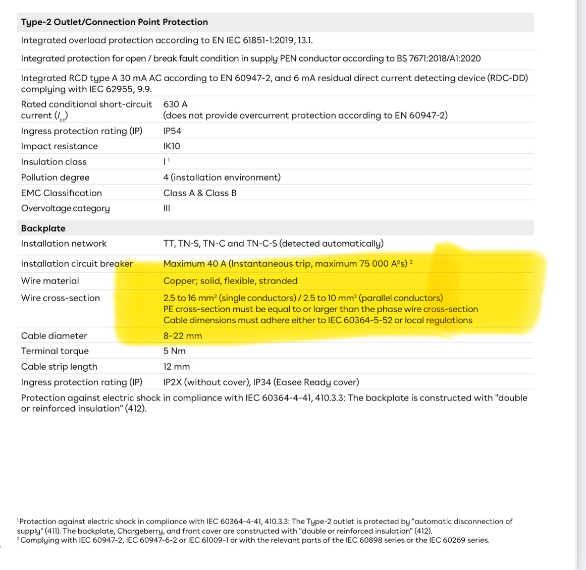

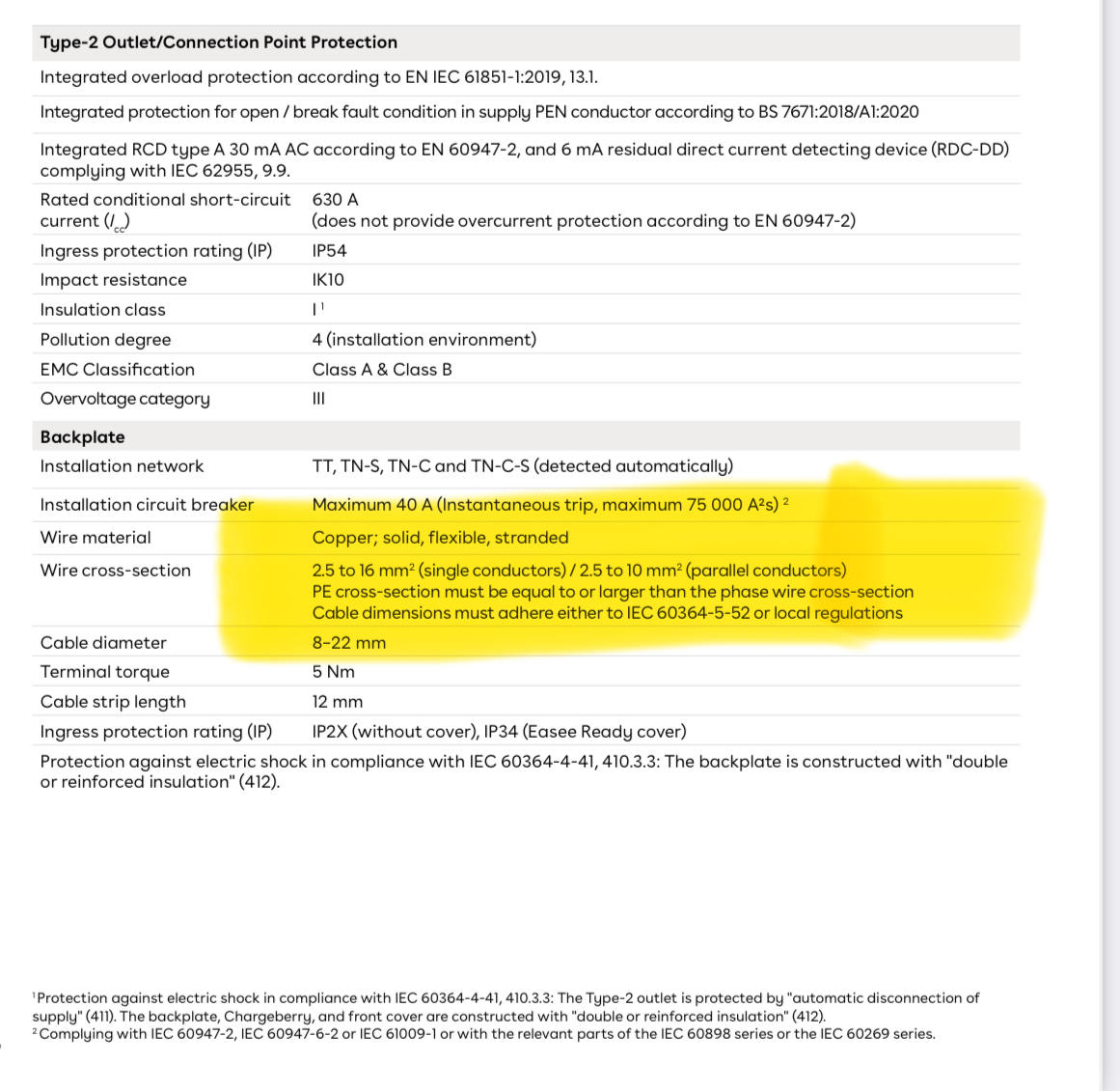

Thing is, I just managed to find the installation manual for the Easee One, and it does state the PE cross section should be the same size or bigger than the phase wire cross section.
So it kind of confirms what some have said, although others disagree.
Look at other quality EV chargers - I very much doubt they will say the same
Just looked at the Zappi unit it only mentions the L & N being 6mm
Makes me wonder if the Easee reflects Scandinavian regulations
That's exactly what it is. They're taking the Norwegian requirements as general requirements. In fairness it could be true that the terminals in their product aren't ideally suited to reduced conductor sizes.
