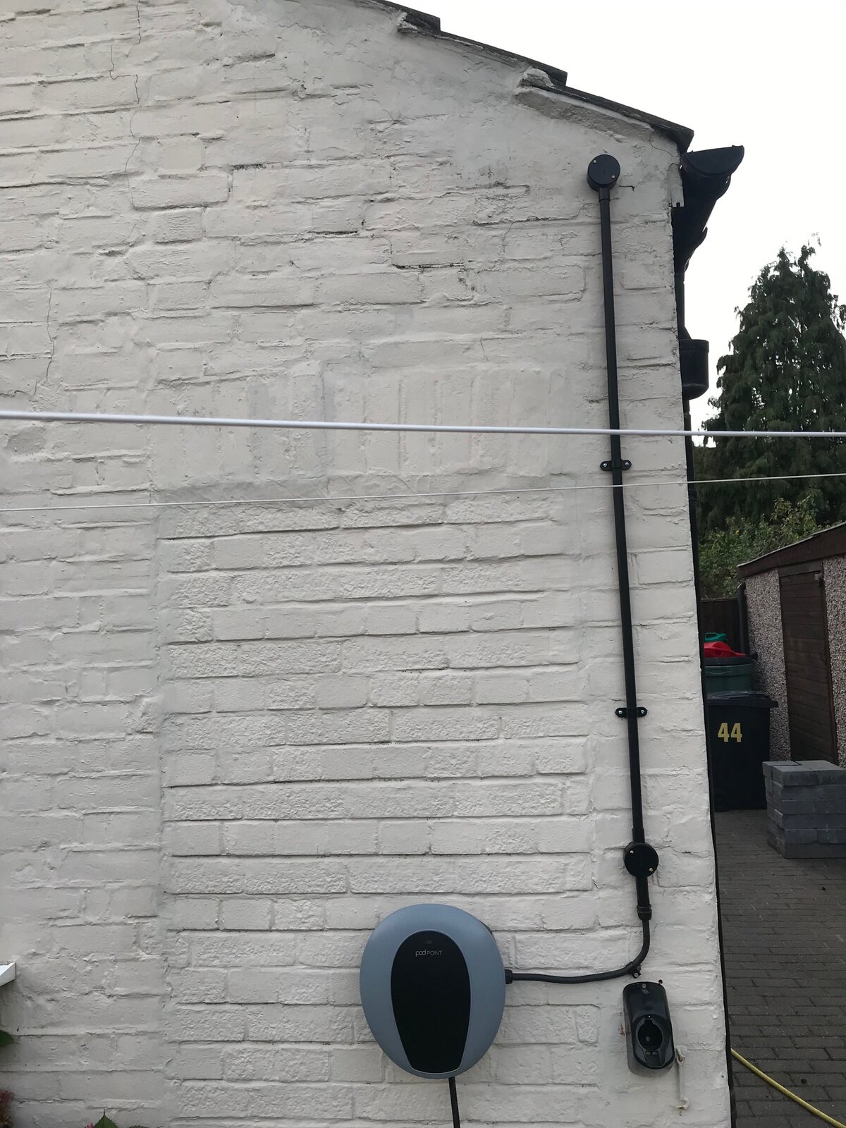

Had a Pod Point EV charger installed and just wanted some confirmation with regard the safety of the installation. I have a 6mm T&E cable running from the consumer unit which is jointed on the outside wall to another high load cable as it goes down to the charger as per the pic.
I question the joint of the 2 cables which are tightly packed in the circular plastic box at the top of the wall as shown in the pic. I raised the question at the time with the electrician and he assured me that everything was fine and its all been signed off. It all seems watertight as you look at it but I do know that the cable coming through the wall has been punched through the back of this box. I must admit, that I expected the jointing box to be a more substantial waterproof affair considering they are high load cables.
Anyway, grateful for any feedback from you guys.

Seems a rough way of doing it, must be tight in that box.
Why not take the EV cable all the way no joints then..cost maybe.
And I think white conduit might of looked better.

I had bought a 10m length of 6mm cable which i thought was more than enough and threaded it through the house to the outside wall. Unfortunately, it proved not long enough to get to the charger and a connection was the only option.
What waterproof external box would be the favoured option as all the jointed cables are packed quite tightly in what has been provided??
If the box has a drain point, likely no problem, or if filled with a re-enterable compound like petroleum jelly then also likely no problem, however my first thought is how do you get the data if using twin and earth, is it all wifi?

Anyway, going back to the original question, I believe the consensus is that the box at the top of the wall is considered safe to pack all the jointed cables so long as its sealed to stop water coming in from the back?
Go back and buy a longer cable

I could get the electrician to install a longer cable so no jointing is required. But if my current set up is considered safe then why do this? My house electrics are all pretty new so minimal work was required around the CU.
Hard to tell from here. But the installer should have given you an Installation Certificate that states that the work complies with BS7671 (he probably signed that he designed, installed and tested the work, so the monkey is on his back... You should also get a Certificate of Compliance with building regulations.
