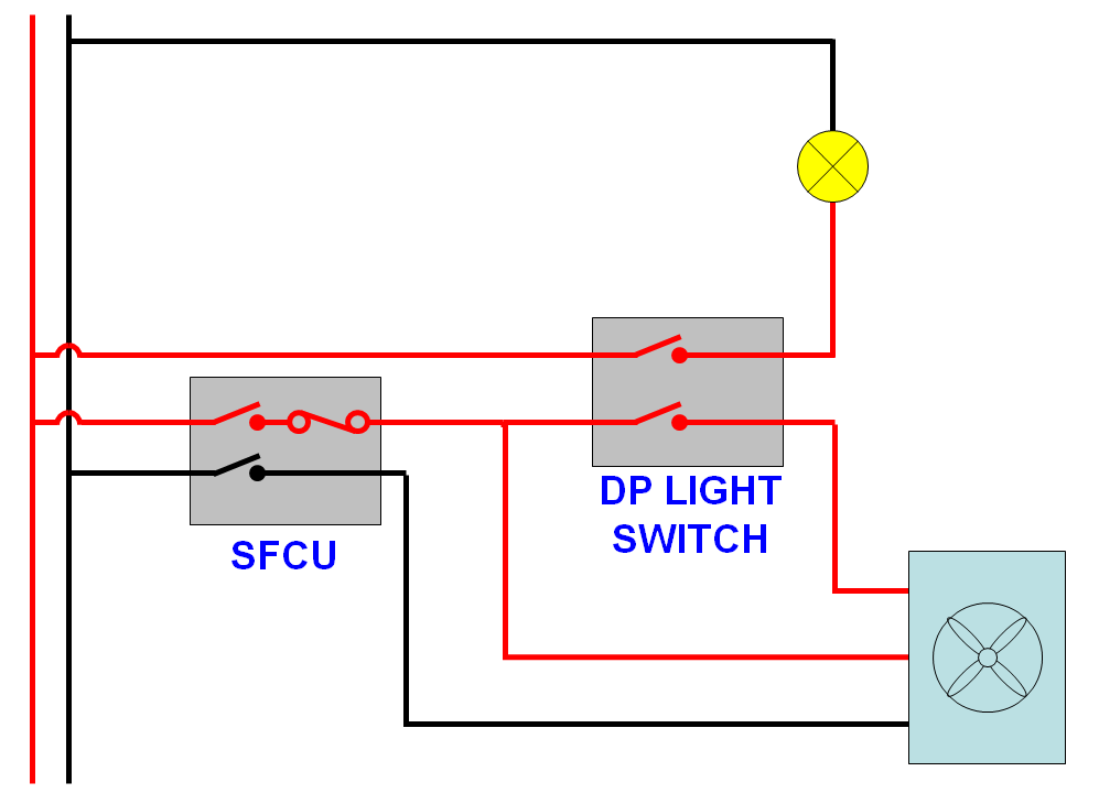

Just to comment on the comments. This is the existing installation that I have inherited from the previous house owners so (for me) it's always been wired this way but I don't know when it was first installed. It is difficult to see from the picture but the connections are as suggested by JohnW2 (i.e. correct). I recognise that some sleeving may be missing on the earths and the switched live isn't correctly coloured to meet with current guidelines/legislation. These are all issues I intend to resolve.
For anyone still interested, and anyone else who is wondering about taking on a similar task, I've now completed the installation of the new fan. Taking into account the feedback from the fan suppliers (they confirmed that a fused spur was required) and all of the other sound advice, I've included both a 3A fused spur and a separate isolation switch. Possibly overkill but for an extra £5 or so I couldn't see a reason not to do it. There are now no sections of cable without outer insulation sticking out of the junction boxes and the boxes are screwed down with the cables clipped. Just for convenience of the cabling runs I haven't used the fuse in the isolation switch to manage the fused spur.

Regarding the query on the fused spur, the manufacturer stated "The wiring diagram does comply and as a manufacturers recommendation, this is the way to install the units". If I hadn't complied with that and there was an issue I assume I'd have no comeback.
Overall, I do now have more screwed connections with the associated risk John has identified, but apart from that is there really any other downside?
Note they say "recommendation".
It makes absolutely no difference to the fan whether you have a switch or not, and
fuses are to protect the cables, not appliances. As such one is not needed.
What do you mean by "both feeds" and "the second supply"?
If you are perhaps talking about separately fusing the L and S/L feed to the fan then, as EFLI pointed out, that introduces a theoretical hazard - if the fan stopped working because a fuse in the permanent L feed blew, if one then opened up the fan to investigate (forgetting to operate the isolator, since the fan was not running), one could be 'surprised' (or worse) by a live S/L if the light was on.
Kind Regards, John
There's always Plan B - replace the light switch with a DP one.
The switched FCU ticks all the boxes, if people want, for 3A fusing (both L & SL), and local all-pole isolation, and has only one fuse, so no concern such as yours.
