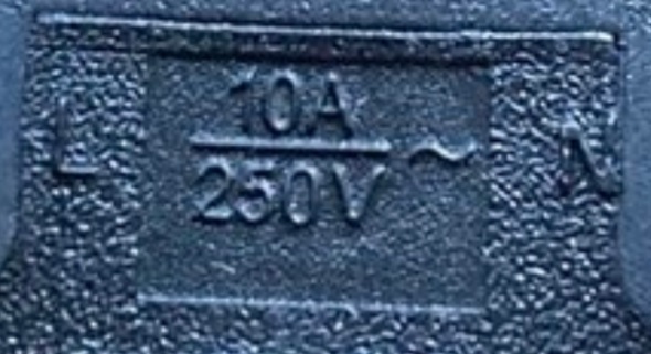

Also interesting to me... Is the plug only rated at 10A? :)
The charger itself is also only rated at 10A

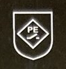

Thank you, I hunted and found an instruction sheet but it says "depending on the regional current grid and the device
version." so no real answer.
But is seems
means "To indicate the function of the in-cable control and protective device (IC-CPD) with switched protective conductor for supplying electric vehicles in charging mode 2." so my worries about loss of PEN are unfounded, and all the protection required is built into the lead?
