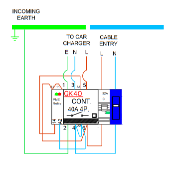

The Garo G6EVPME132 is a single-phase MCB and PME fault detection distribution board that provides protection against electric shock by disconnecting the electric vehicle under charge from the live conductors and the protective Earth of the supply within 5 seconds of a supply fault voltage being detected.
the data sheet says nothing about DC detection.
There are two completely independent problems with a supply to an EV.
One is the earthing arrangement, and it seems a device is used so if the voltage is not within the 207 - 253 volt range it completely disconnects the supply, other methods can be used, like an earth rod so it measures supply earth compared with true earth, or of course simply don't use supply earth, however then looking at enough distance between the two earthing systems so can't come into contact with both.
The 207 - 253 volt method clearly has a problem if there is no auto reset, and any brown out could mean no charged car when required. The data sheet shows
and a copy of 722.411.4 from BS 7671:2018 amendment 1, it would seem there is auto reset
not sure about this, as if PEN is lost then don't really want the unit to be reconnecting all the time, this seems wrong?

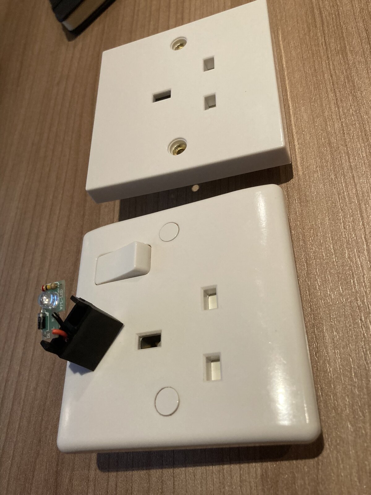

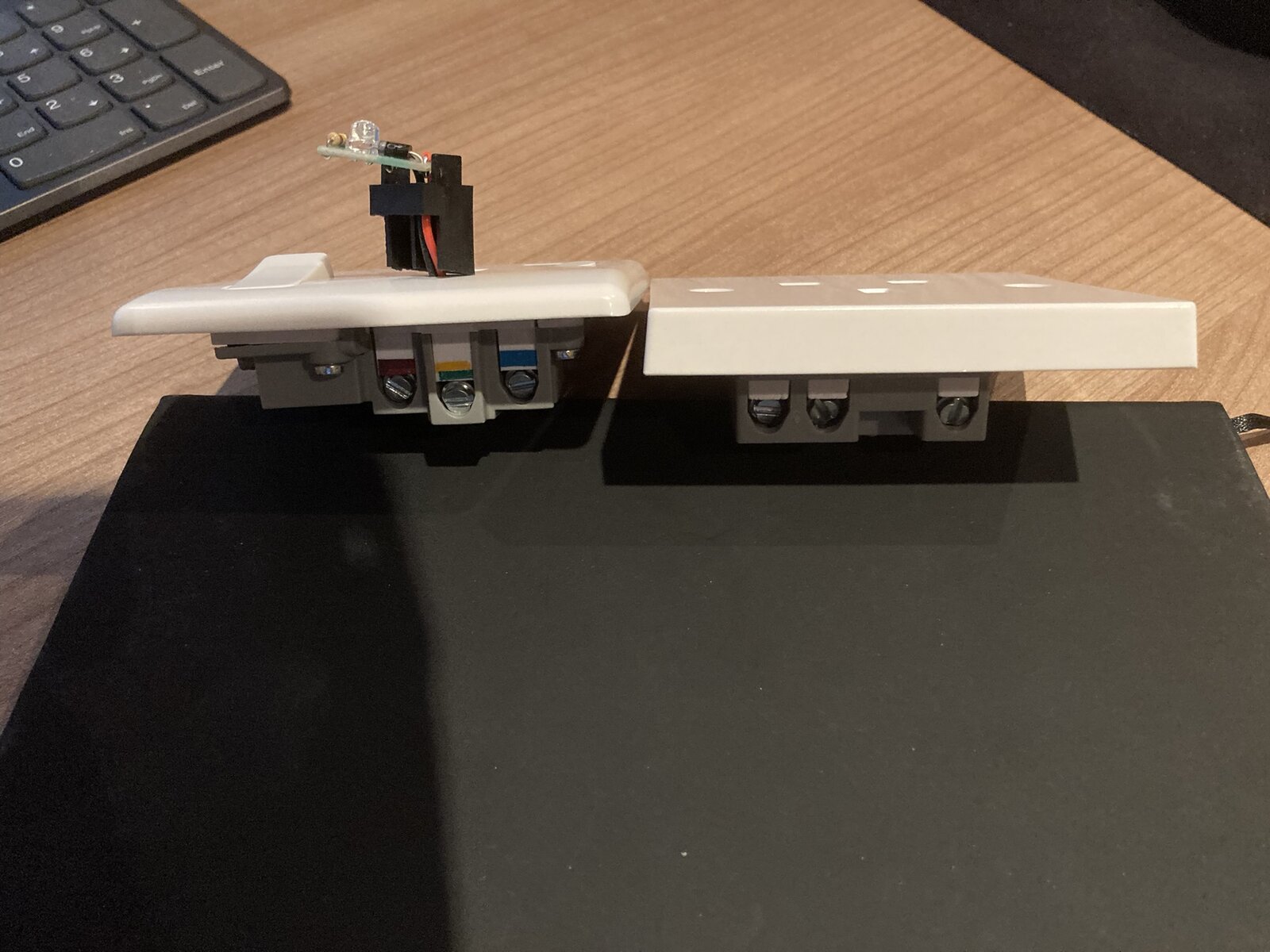

Hi again flameport....apologies for the delay and yet more questions
As advised, i purchased an unswitched BG socket to swap into the housing, but as you can see from the pictures, the profile is significantly different and doesn't sit flush inside
The switch that came with the outside socket is very slim and profiled as you can see here (the left hand one) :
...whereas the standard BG is a square and chunky affair :
I've scoured the internet and it doesn't appear that BG do a slim/same profile unswitched socket equivalent
There are a couple of other possibilities (a Schneider and an MK) at screwfix so i'll give those a go but if they don't fit/aren't suitable :
  • just how much of a deal breaker is it needing to be unswitched, ie, is it just a case of you don't need it so don't have it, or would a sparkie not sign it off as it is switched ?
  • the Type A RCBO....i assume that that just needs to be >= 20A ?
thanks again for all your advice to date, its much appreciated !
