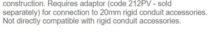

FWIW In one of the industries I've worked within the spec was often to solvent weld the flexible conduit into rigid fittings.NO!! Read the product description.

The female version is better, a short bit of rigid conduit to join it to the besa box, then screw the flexi glands that Harry suggests into the thread, throwing the bush aside
What do you mean by this @SUNRAY?Personally I have never had a problem with solvent welding plastic flexible conduit directly into fittings...

They would need to be Earthed. To enter a PVC BESA box a short stub of conduit into a female adaptor with the bush discarded, and into the kopex adaptor would be the best. But as @Murdochcat asks, is kopex really the best solution here?Why not use 20mm threaded galv boxes and lids, or easier use threaded plastic wiska boxes and make your own junctions

That's the proper way to do itI had to use the corrugated fitting suggested earlier. This screwed on to a female connector. I then needed a short bit of rigid pipe to go from the female connector into one of those round box connectors.
