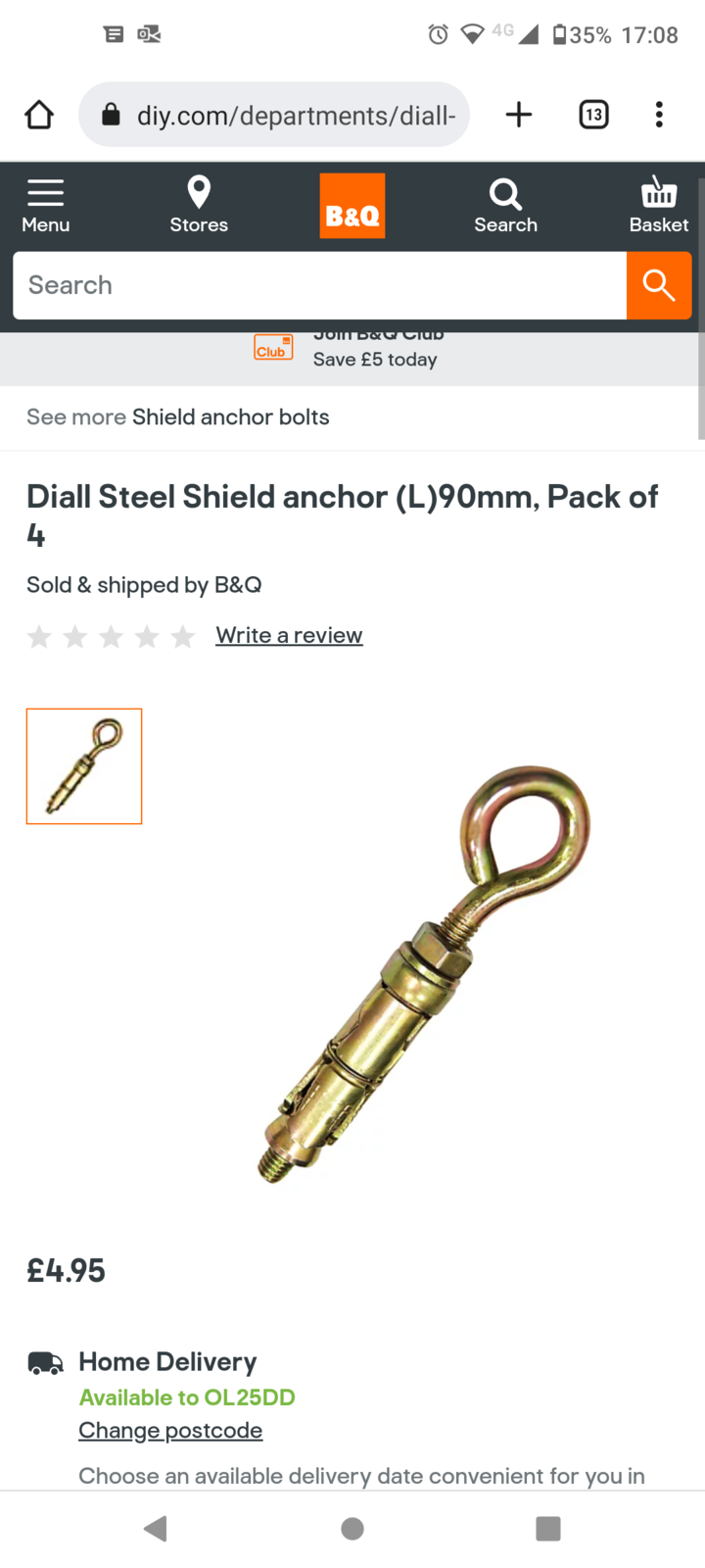

I'm doing some repairs to the house front and had a bit of a scare with the ladder. The problem is there's a deep ground floor canopy that's stopping me put the ladder steep enough and the paving slopes away from the house:
It's threatened to slide down a few times so I'm going to fit some of these across the wall between the windows to anchor the ladder to:
Not quite scaffolding spec but should be effective enough for a ladder or tower. Bolt size is M10 x 90mm and the bricks are solids.
