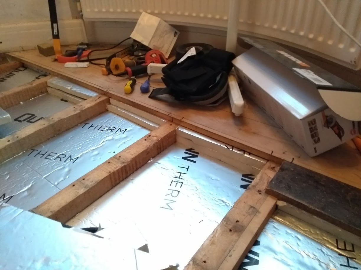

Regarding the floor insulation: my Building Inspector told me to install 80mm celotex between our 95mm joists and leave the extra 15mm gap at the top.
He didn’t mention anything about vapour barriers or taping the gaps. He even advised to not fill the gaps along the walls between the first joists (seen many comments about filling this gap insulation to prevent drafts).
Any advice?
If cold air gets in from outside above the insulation, then this will make it pretty pointless!
So far my best result has been from putting solid board down with rockwool on top.
We have approx 50mm gap between the outer walls and the parallel joists.
How did you get your gap filled? Did you just stuff it with rockwool?

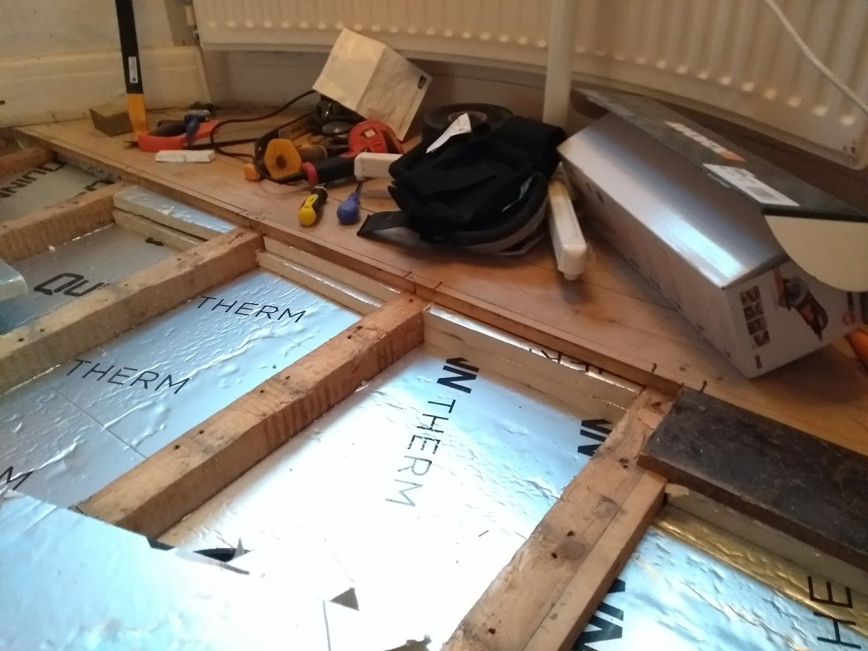

I have gaps on the edge of the room, but air from there cannot get into or above the insulation. On the external walls I also put in insulation boards, so there is no cold bridge once it was all in.
Last year I did leave a bit of floor in the bay without insulation. It looked like this:
wasnt the best job, but the idea being that no air from outside can get into the insulated area. All taped and then wool placed above the boards. Not sure if this is anything like you are doing though!
Yes this is exactly what I am doing.
