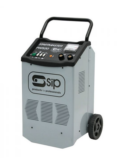

I use something like this View attachment 307604at work, but other than when used to jump start, within ¼ hour the charge rate has dropped to nearly the same as the cheap chargers, so in the main the cheap Lidi charger would do same job.

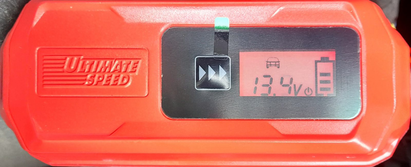

View attachment 307874This one is the latest Lidi one, it does need one to press the button to start the charge, but once started it will continue.

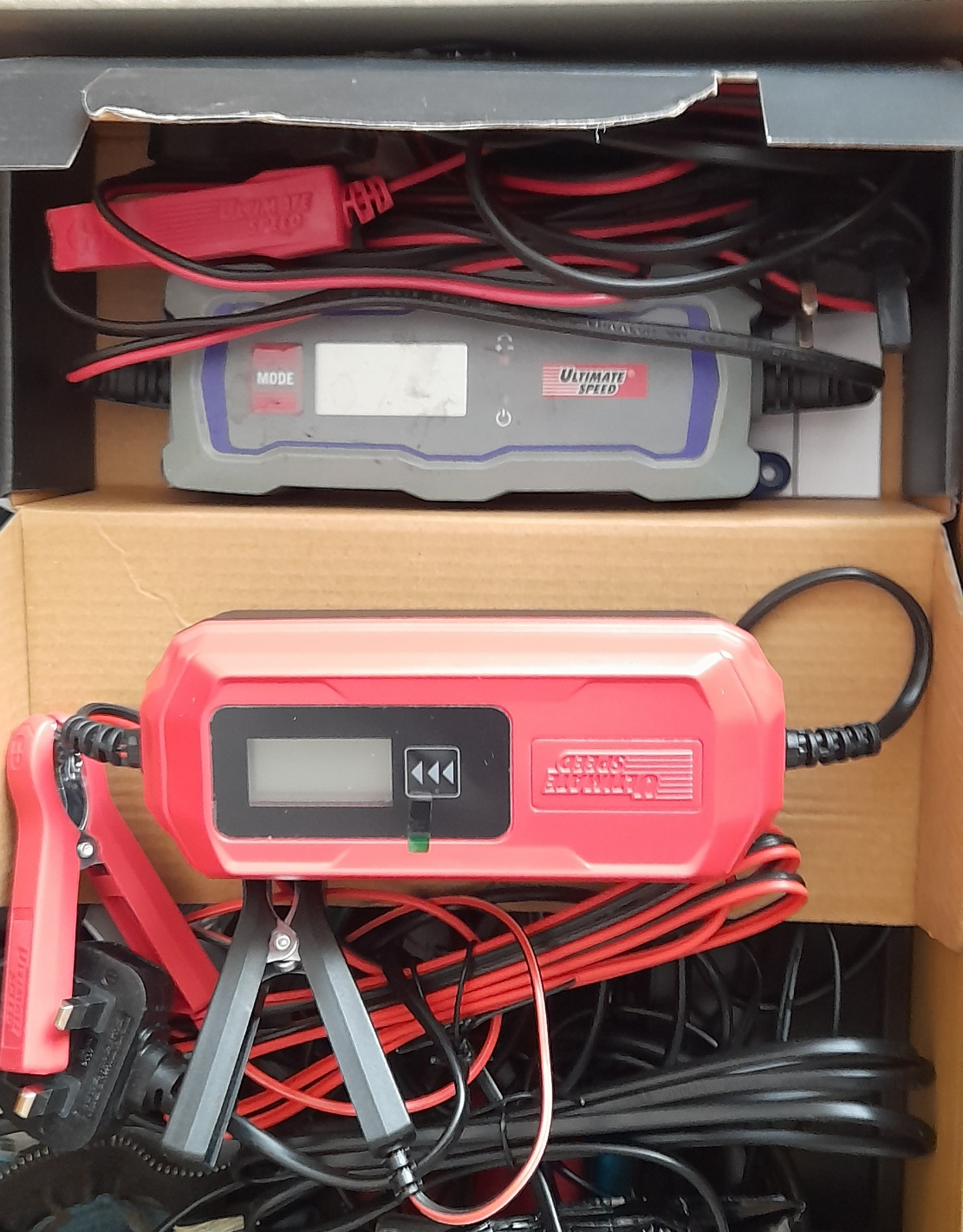

The bigger grey one you bough later, what was its out put and what did you pay for it?
Grey one 3.8 amp (ULGD 3.8 A1), red one 5 amp (ULGD 5.0 D2), the 3.8 amp model will only alternate between 0.1 and 0.8 amp once it has passed through the 3.8 and 3 amp stages, but the 5 amp model will if voltage drops revert to 3 and 5 amp modes, but other wise nearly the same. Seem to remember both models were about £14 each.
There was an earlier model too (ULG 3.8 B1) without the volt meter. Aldi also did one, and there is also the Ring model, and the well known Ctek each has slightly different things.
For what it's worth, the 2 versions I have the button is to select motorbike, car or frost.
Each time I move them I simply clip on the battery and plug in, I don't think I have to push the button each time.
The guy I borrowed one of them from has two, and even he says you need to select the button first otherwise nothing will happen; I mean I set there all night thinking the battery was dead when the charger was switched off

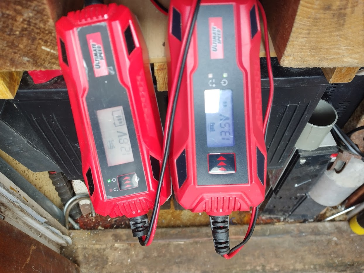

I've just double checked mine, I have 4 (2 of each ULDG 5.0 A1 & B1).
From Powered down, clipping on a battery and powering up. One of the B1's remembers the car setting, the other 3 don't and a double button push is required.
I obviously do this without thinking and typically load 4 batteries in the car, use them and then restack/reconnect chargers at home with regularity. I leave the chargers on permanently so they are always ready for use.
