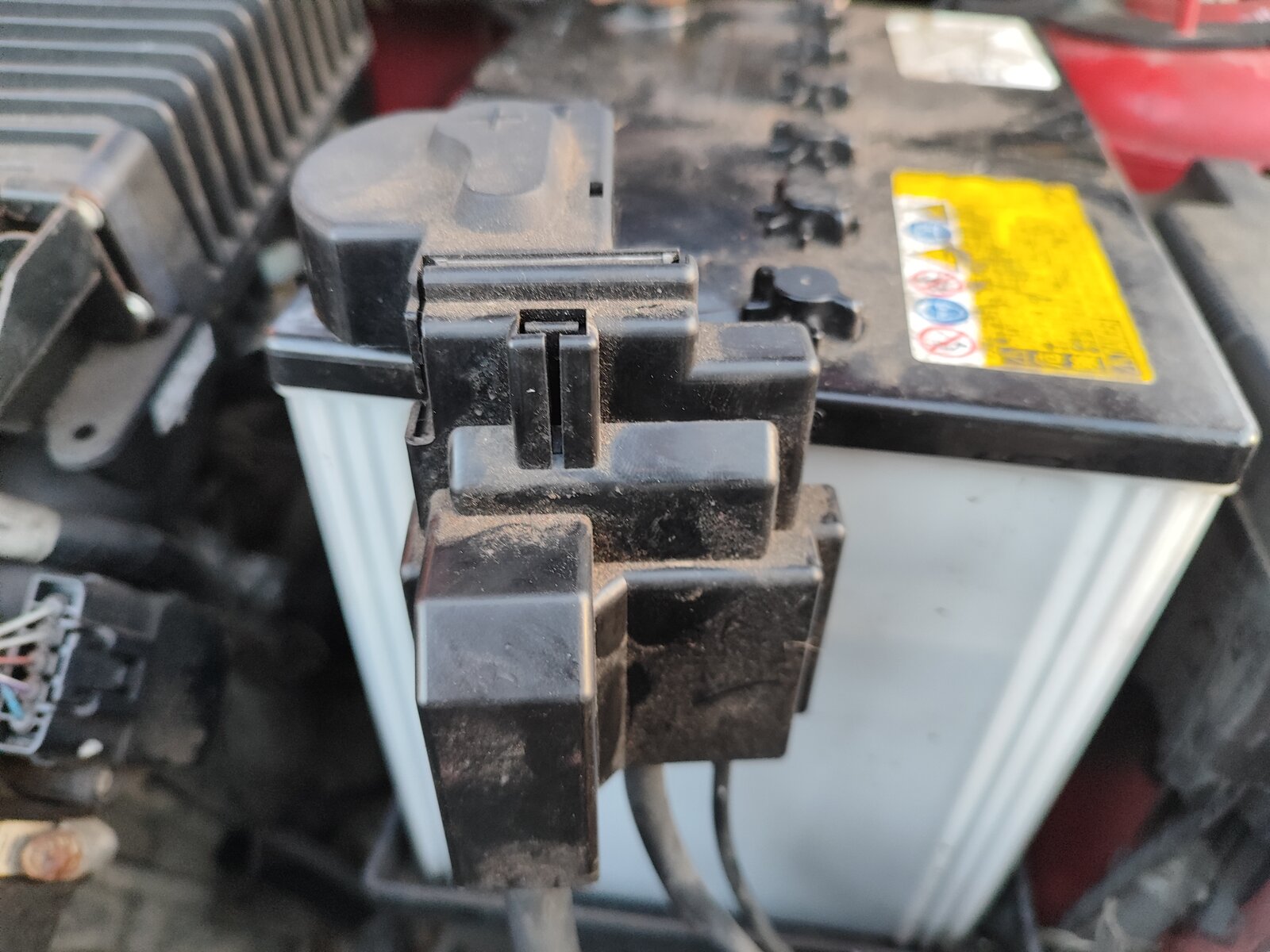

I remember years ago on some Ford cars (Mk3 Escort, Capri, Granada etc.) when changing the battery, people got a similar result as the OP. This was because when undoing the leads, a single wire on the positive terminal had fallen down unnoticed by the side of the battery. I don’t suppose the OP's car has a similar setup, does it?
Or even an earth lead
I don't think so. It looks like this:
