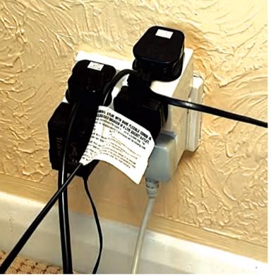

The Electrical Safety Council do a Best Practice Guide which seems to be what most electricians follow when giving a code.
I am not sure I totally agree with the guide to me multi way adaptors and wandering leads are outside the remit when doing an installation inspection and test they are part of the in service inspection and testing of electrical equipment often referred to as PAT testing.
However if we are to include plugged in devices then we should include those which improve the installation as well as cause danger.
