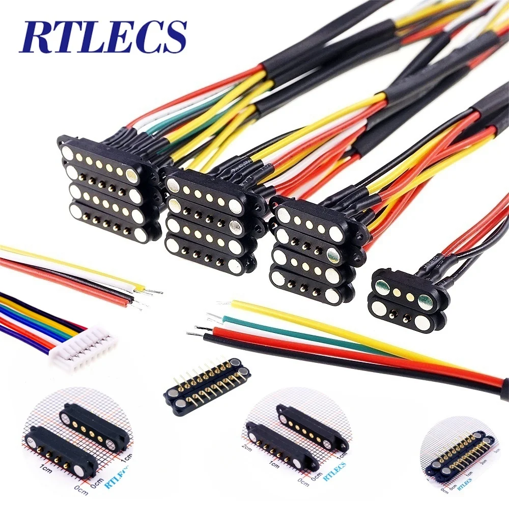

Something which may be of interest to you - for the LED lighting and other ELV connections - are magnetic "Pogo Pin Connectors",
If you wire them correctly, these devices connect themselves magnetically, the correct way around - because of the polarity of the magnets.

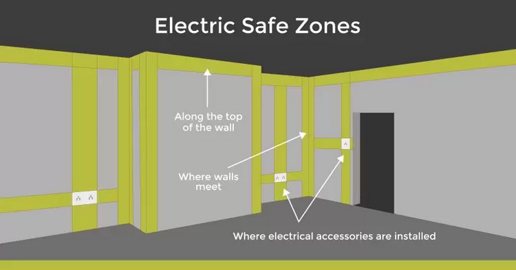

There are electrical safe zones,
so if cables already installed it is too late to change.
