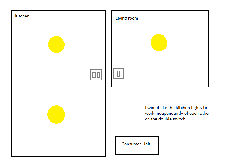

I want to re wire my lights in the house before I plaster and lay carpet upstairs.
My downstairs lights only consist of 3 blooms. (1 in living room on a 1 gang, and 2 in the kitchen on a 2 gang)
given a clean slate how would this be done?
It has 90s wiring and it very sus. It works. But kitchen lights only work off one switch on the 2 gang and not independently of each other unfortunately.
The kitchen light is looped in with the living room lights currently, and the living room switch pulls power from the kitchen switch. So if one is disconnected, they all drop out. But this is besides the point. I'd show current lay out of wires but I expect that's not useful for a rewire. I can run wires where needed.
I want to re wire from the Consumer unit but not sure what the current set up for a circuit like this would be? So, how would you do it? Can you draw on the image?
Thanks a lot. I look forward to learning a thing or two.
I'd like to encourage you, but this is not like painting by numbers.
More importantly, all new work must comply with the current regulations. Do you know what they are?
Secondly, this new circuit is NOTIFIABLE to the local authority. It is an expensive and difficult process to go through, even for someone who has the knowledge and the required sets of calibrated test equipment (needed for the tests and results to go on the ELECTRICAL INSTALLATION CERTIFICATE.)
As I say, I'd like to encourage you, but your route to success is via a competent and registered electrician. He/she will give you the answers that you seek and may even let you run some cables, under their guidance.

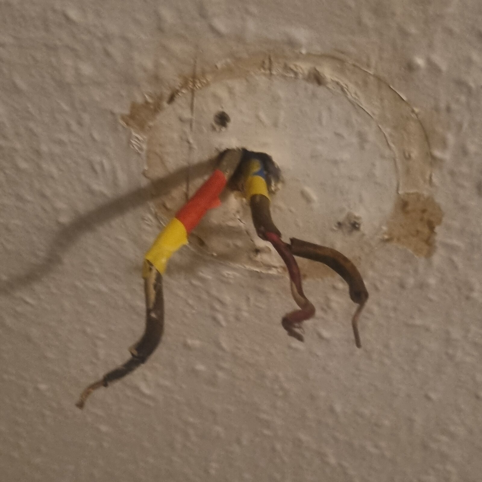

There is black rubber wires under the floor cut, but given I didn't die when I licked it. I assumed it was very old and someone was lazy and left old junction boxes in place under the floors...
Unrelated but I did panic when I saw rubber wires cut leading to junction boxes. Lazy workmanship leaving laying all over the house. this lazy workmanship makes me want to rewires what else they may have bodged.
But in regard to the light circuit. 1993 by the look of it. Some wires now getting short and hard to work with as obviously been cut a few times for new lights etc over the years. Some of the copper ends seem to be pretty oxidized so I have scrubbed them clean. and yes seems to be earths where needed. Just general wear and tear I dont wan tot plaster them in and fix new floors down only to have to change it again later.

By the letter of the rules if you don't touch the cable between the consumer unit and the first rose/switch (depending on how it's wired) then you can do anything you like after that so if that first cable is in good condition then you can 'rewire' the rest of the circuit from there.
