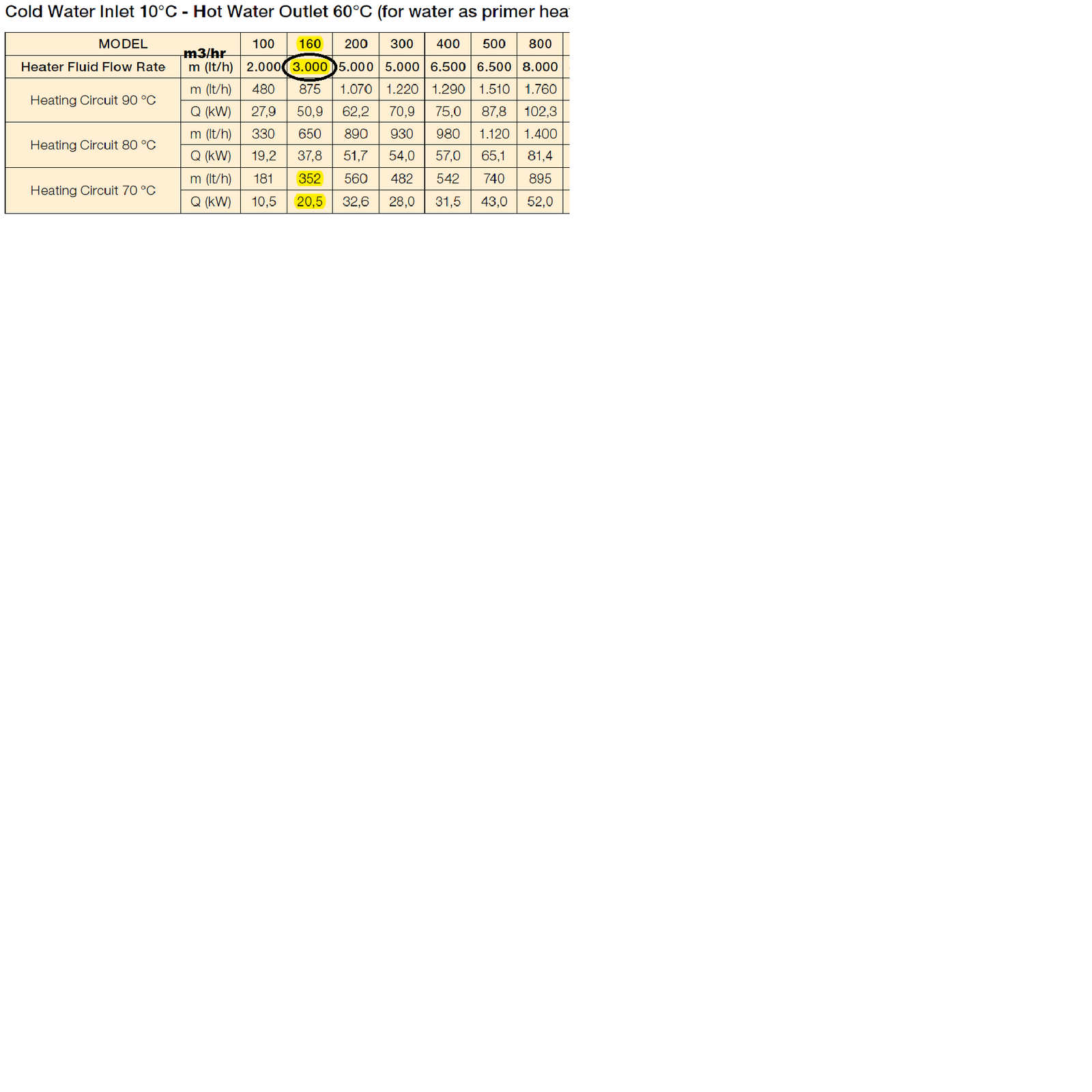

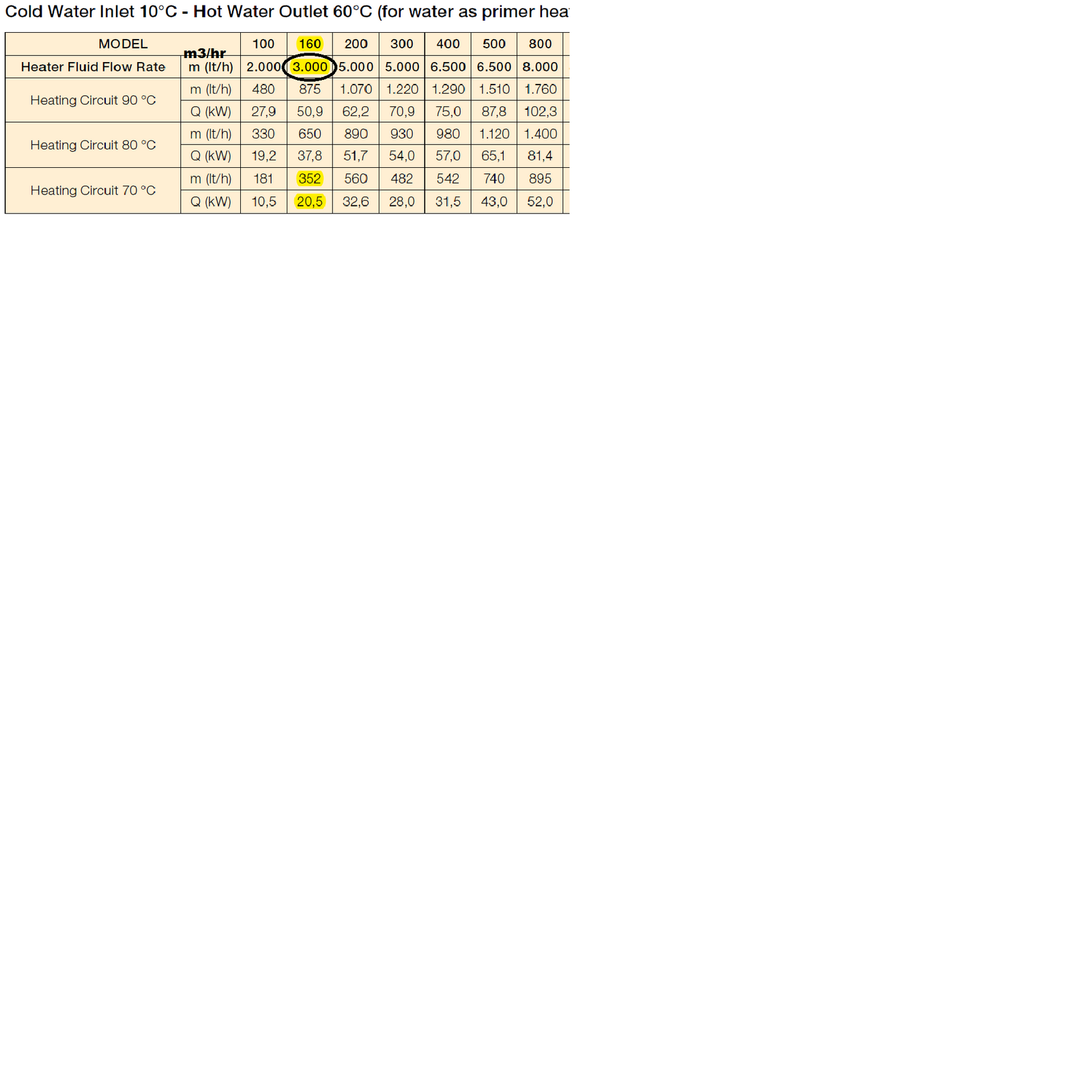

I am installing a dedicated boiler to feed indirect (debatable but I got a boiler for the same amount as viessmann relay box). Another 19kw Vitodens OV!
The flow and return tappings on boiler is 22mm. The spec sheet of indirect says to get 60DegC water is attached.
Math tells me that boiler 19x3412 = 63000btu, With DT of 30DegC it should give 15lit/min HW output. Correct?
Questions : Should I be fine with 22mm or go for 28mm copper pipe from boiler to indirect? The indirect's tapping for flow and return are 1.25" (35mm).
Since the boiler is dedicated to indirect so will only have one loop to indirect, where should the pump be located on flow to indirect or on return to boiler HEX?
The resistance through indirect's coil is 3.2ft. The boiler and indirect are only 20ft apart.

The numbers you've quoted/highlighted above are the continuous HW output at 60C with a boiler temp of 70C,
The primary flowrate is 3m3/hr, 50LPM, your boiler hasn't a hope of supplying this flowrate, most boilers design flowrates are calculated using a dT of 20C so a 20kw boiler would have a design max flowrate of 20*860/60/20, 14.3LPM, this might result in a dP through the boiler HEX of anything from 2.0M to 3.5M, it might be in the boiler MIs. Anyway, for info, 40ft of 22mm piping flowing 50LPM will have a dP of ~ 5.8M alone but 28mm piping would reduce it to 1.5M.
Why are you quoting the continuous HW output from the HW cylinder?, in your case, 352LPH, 5.87LPM at 60C, or 9.78LPM (9.08LPM with 19kw boiler) when mixed with mains at 10C. You installed the cylinder because you didn't want/require a combi.
a 120L cylinder at 60C will provide nearly 200L at 40C so will "last" for 20mins at 10.0LPM, 13mins at 15LPM etc, you will then have to wait for the cylinder to recover which will be a good bit longer than the quoted numbers since realistically you'r primary flowrate will probably be more like 20LPM, you could all ways, if necessary, increase the boiler flowtemp to 80C which would compensate to a large degree.

I have to connect 3-4 washrooms (3 showers and a kitchen, not baths). so Combi was not an option. 5 adults in house using 3 washrooms.
I hav dedicated this boiler to dhw so I don't mind it recovering as we rarely use showers simultaneously.
I have bought wilo pump with max 6m head so you reckon at full speed it should be able to cope even with 22mm.

No, the friction loss depends on the water flow passages, not just the area. Most boiler manuals have headloss data vs flow, but I couldn't find it in some Viessmann ones. But what makes you think that will be a problem? The in-built pump should easily handle that and the HW cylinder headloss.
Getting a bit confused,
IF your cylinder is the ASB1 single coil, 160, then the coil flowrate is only 10LPM (not 50LPM) so 22mm piping will have no problem with this at a dP of ~ 0.3M, and still only a dP of 1.1M if the flowrate was 20LPM. It states a coil resistance of 0.01mSS at 10LPM, what does mSS mean??.
If the boiler is a system boiler with its own in built pump then most of these are now a 7M head pump so no problem in circulating through the boiler HEX and the cylinder coil.
If a heat only boiler then that 6M Wilo will also be fine, presume this (if) heat only boiler can be sealed so pump on the inlet to the boiler with its external EV teed in just before the pump. If a OV boiler then the pump should be installed on the boiler outlet (flow) with, from the boiler, Vent, Cold feed (no more than 150mm apart) then the pump.
