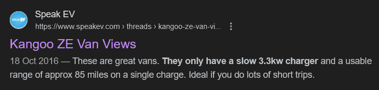

I can't think of any Renault EV that could only charge at 3kW We have friends with a Zoe, which charges at 7kW (max). Renault backed the ChaDeMo charging plug, (now becoming obsolete), but if you have such a vehicle that can't charge at more than 7kW, then just go to the next suitable charger. The car's sat-nav will have them all programmed in, or you could use ZapMap and just set the filters to only show the chargers suitable for your vehicle.
Latter they got a larger battery and faster charge option, the early versions the battery was rented.
Battery rental is £35pm plus VAT (£42pm inc) for 9,000 miles pa. Typical range in summer is 80 to 85 miles, in mid winter around 65 miles.
Yes I know the new version have a lot bigger range and a heat pump for heating, but the old series 1 was a resistive heater.
Other cars often have only single phase charging, so you can plug into a 22 kW charger but still only charges at 7 kW, I had some one complaining the charge rate was low, and I had wondered if the was a phase down, but it seems if a phase fails it auto isolates, the system is to isolate with loss of PEN but it means also isolates with loss of a phase.
The early Kangoo had a 20 kWh battery, this I think went up to 33 kWh with latter models, so 20/3.3 = 6 hours to charge, so if charging at home the low charge rate was not really a problem. Only when larger batteries were fitted did the lower charge rate cause a problem, and when they fitted the larger battery they also went to 7 kW charging.

Only a very few of the first ones. From 2017 they could all chrge at 7kW:
