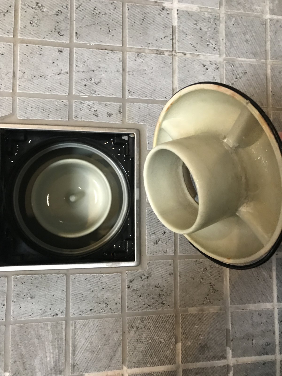

Thanks very much guys, its really appreciated. The smell is coming into the upstairs via the shower drain in our ensuite. I'm going to do some more investigation over the weekend and try and narrow things down. There is one particular drain outside that stinks that I know that the waste from here runs into it. I've popped the lid and tested shower toilets etc and they all run and move freely. I've also left a hose running here to see if it backed up and it didn't.
Thanks and have a good weekend!
Guys I've just been round all the drains and everything is running freely from house to tank with no blockages or problems.
I can now only assume that this problem goes back to us putting bleach into the shower drain.
My uncle mentioned... "that in the olden days... when a tank was emptied you'd put raw chicken in to reactivate the bio system" At first I thought this was mental but its the only other thing I can try!?

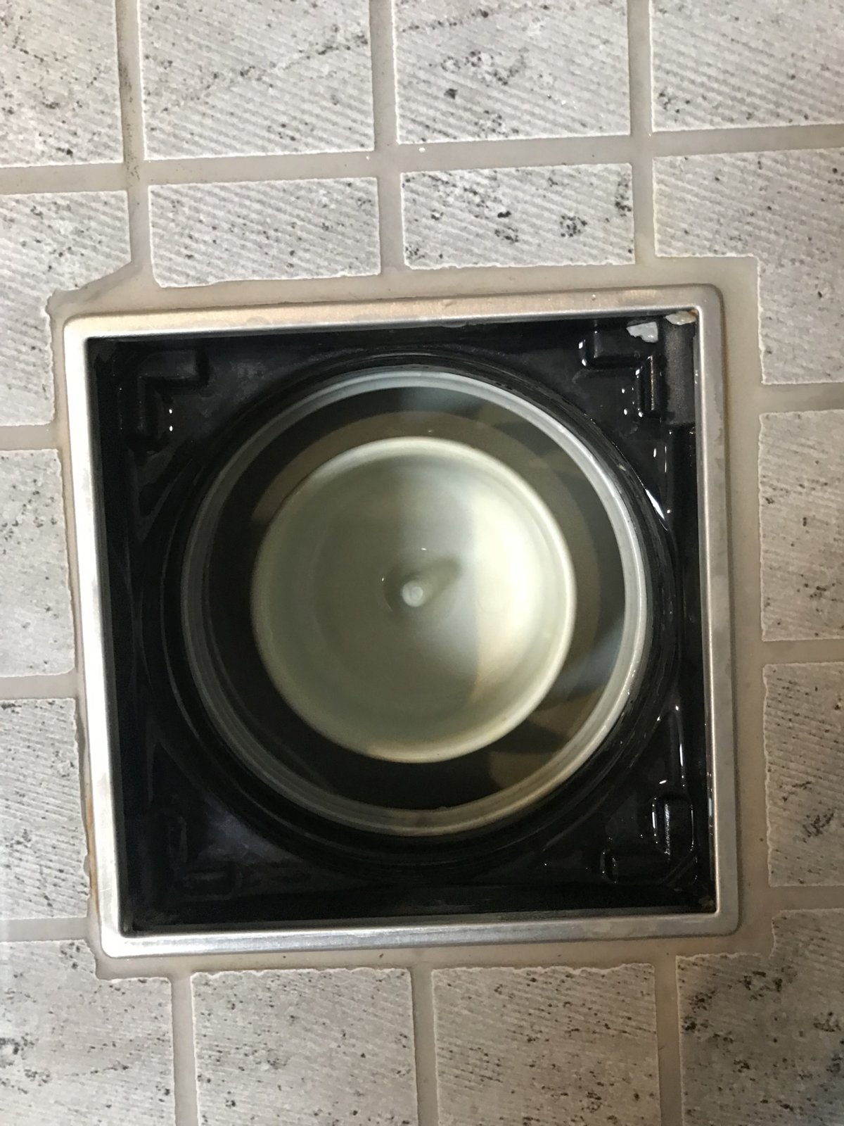

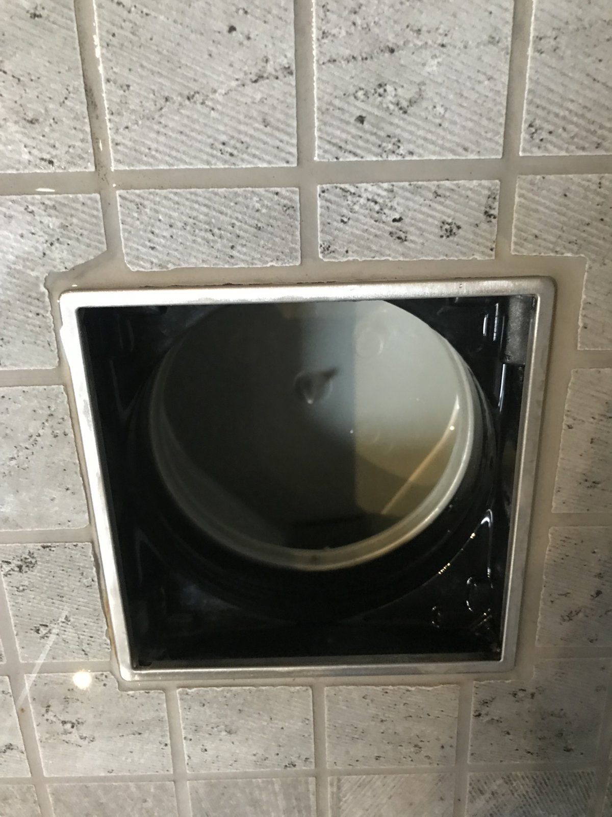

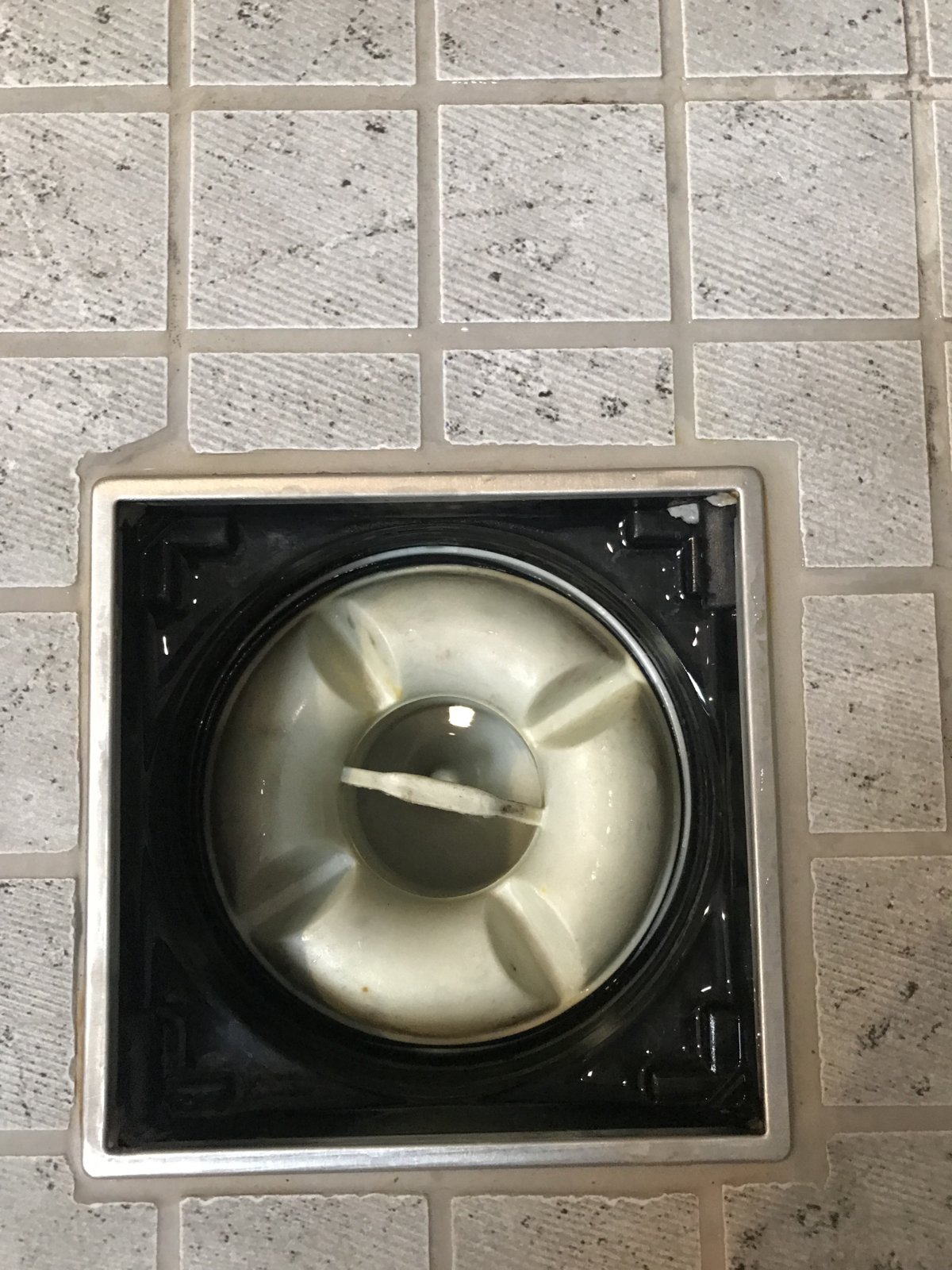

Check to see if the trap is being pulled out of the shower waste
Sorry Dan, can you please explain mate.. I'm not sure what you mean "if the trap is being pulled out of the shower waste"

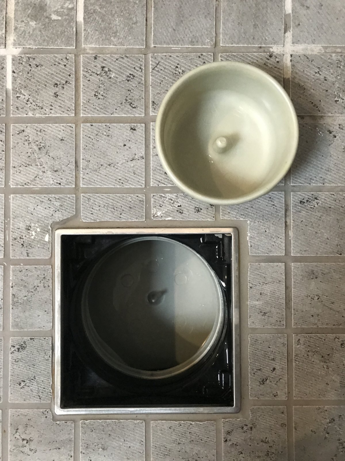

Just had another look at the shower trap and it comprises of the following...
The rubber seal is loose and I'm going to see if I can replace this now. Hopefully onto something! :)
