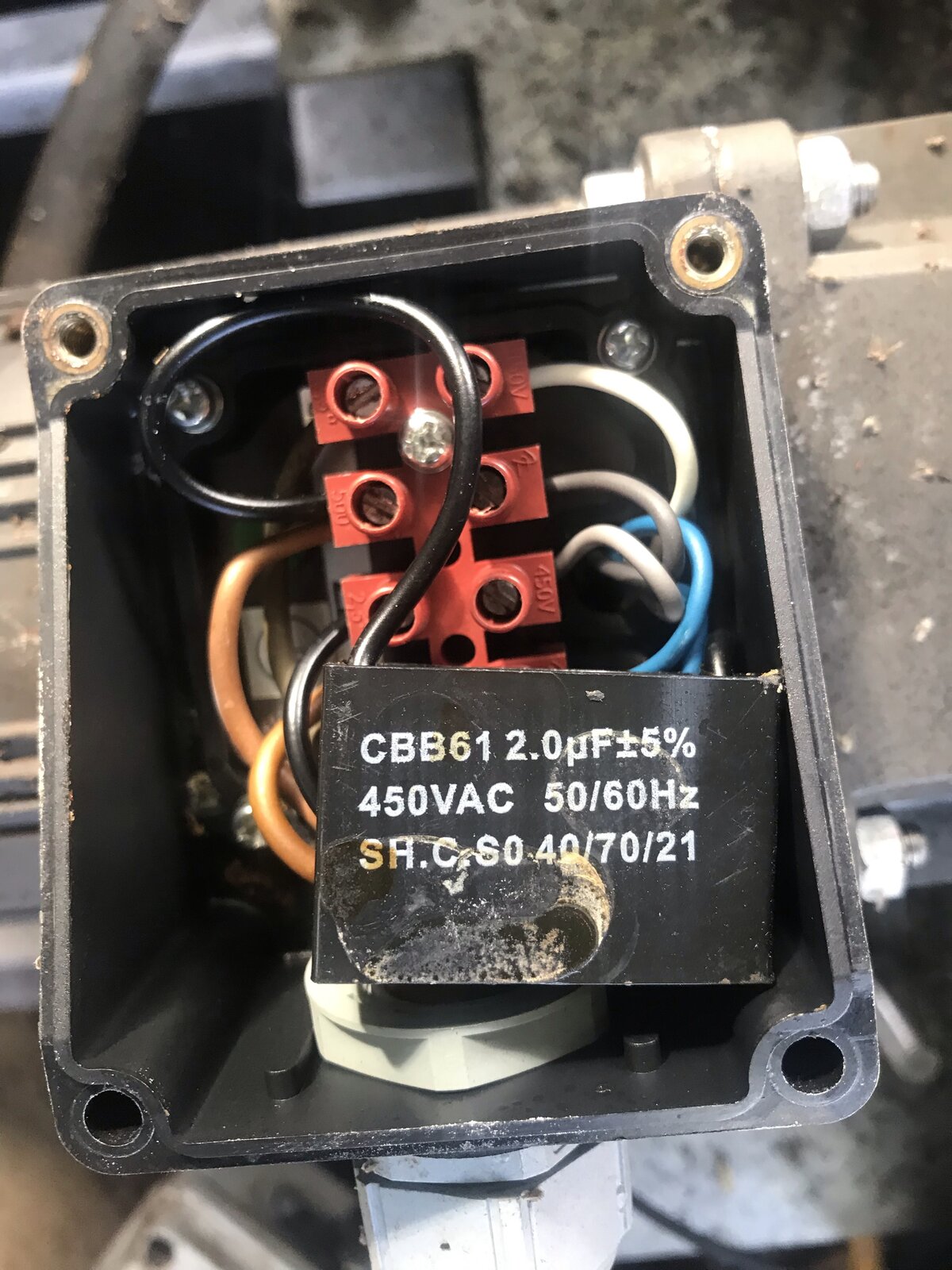

The unit is nolonger tripping out the switch on the consumer united when powered (however still failed to rotate)
There are no signs on water ingress and the capacitor appears in tact.

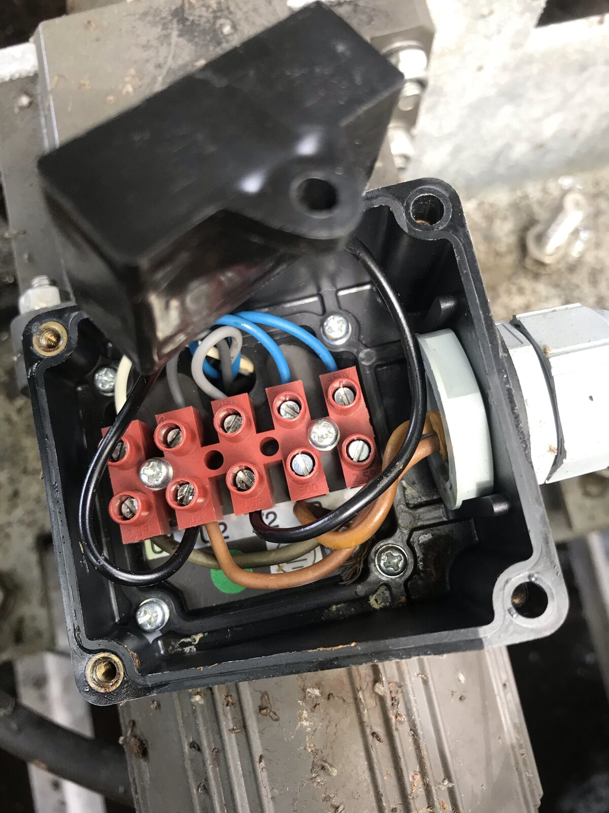

I'm strongly considering wiring a plug directly to the motor and seeing if it will power via an extension lead.. However I'm unsure of what wires are what? Do you happen to know or able to suggest any further trouble shooting so I can illuminate the motor?
I've attached an image here of the wiring and also a more general image of the unit.

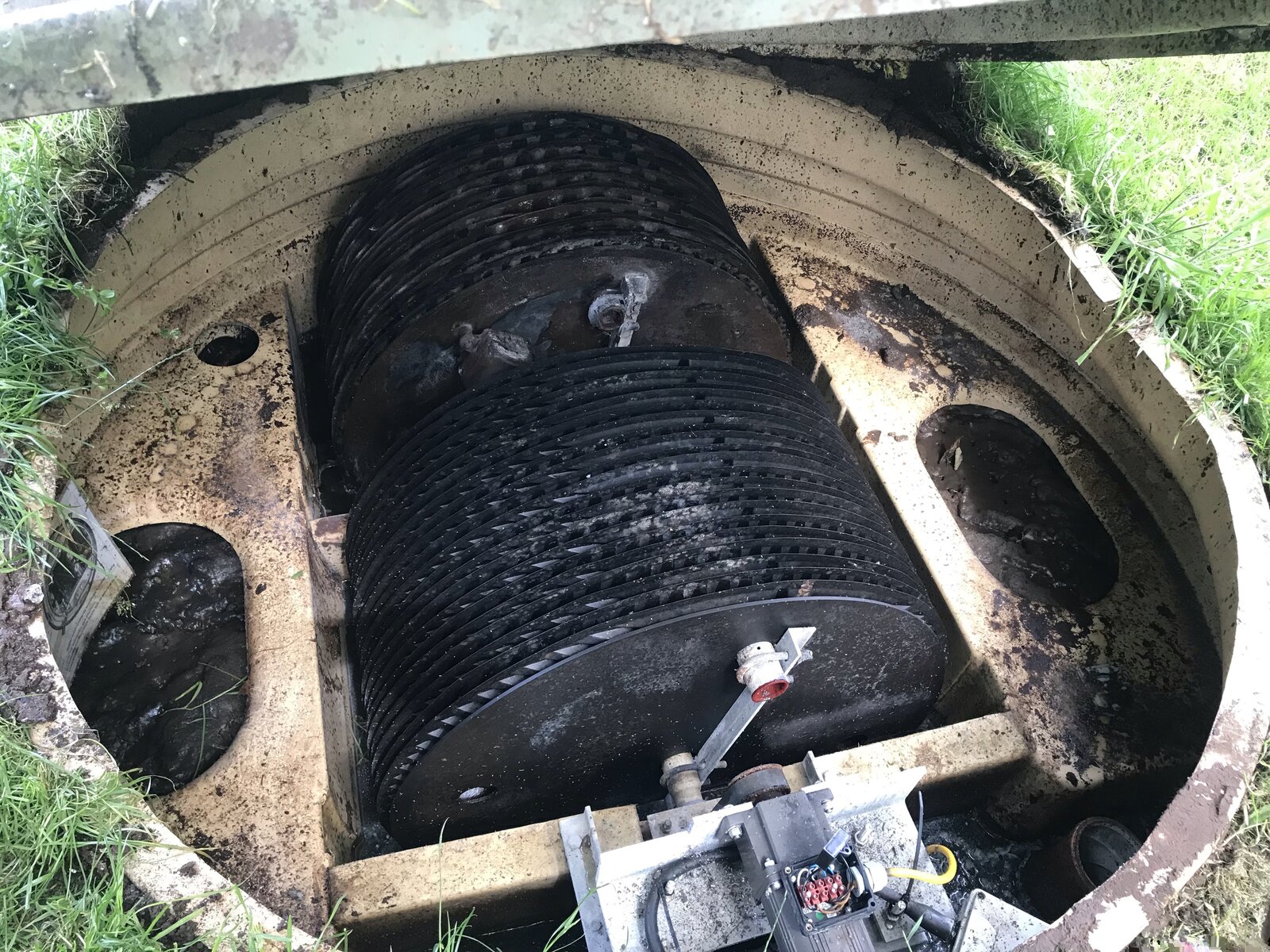

Unit looks to be in excellent working condition, so I dont think you need to worry there, discs are as I'd want to see them and a healthy crust on the primary section. I wouldn't like to hazard a guess on the wiring I'm afraid, it's not my specialist area, and given the situation, it's too risky to guess it.
Only thing I can suggest is, if you feel capable of checking mains voltages with a Multimeter, is look at the power supply into the unit, and check there's 240V there when power is put on to the unit. This would rule out a break in the cable between house and tank. Might be worth posting in the Electrical section, see if any of the Guys in there can elaborate on your setup.

Thanks for that. Does anyone know how to test if one is working?
There is a testing mode on some multimeters but I would leave it to pros, if you dont fully discharge the cap the residule charge can zap the cr@p out of you
You will get a buzzing sound from the motor if cap is fooked.
It is wired in series with start winding to create a rotating magnetic field between windings to start rotation.
If it is not big enough it will not work.

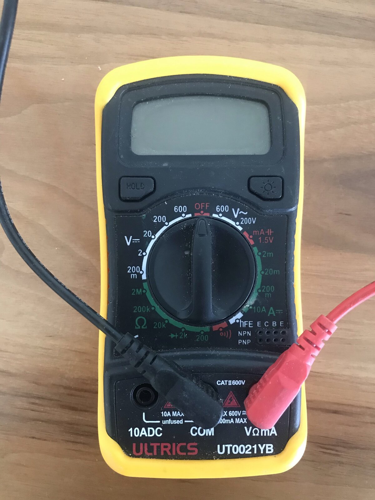

Which multimeter are you using ??
Hi Terry, not yet as I wasn't sure what terminals to test from. However a spark friend of mine has just come back and suggested the following:
"The cores of the incoming cable one will be earth and attached to the casing . The other two look to be going into u1 and u2 . Try between them."
So I'm about to test them. The meter that I'm using is this...

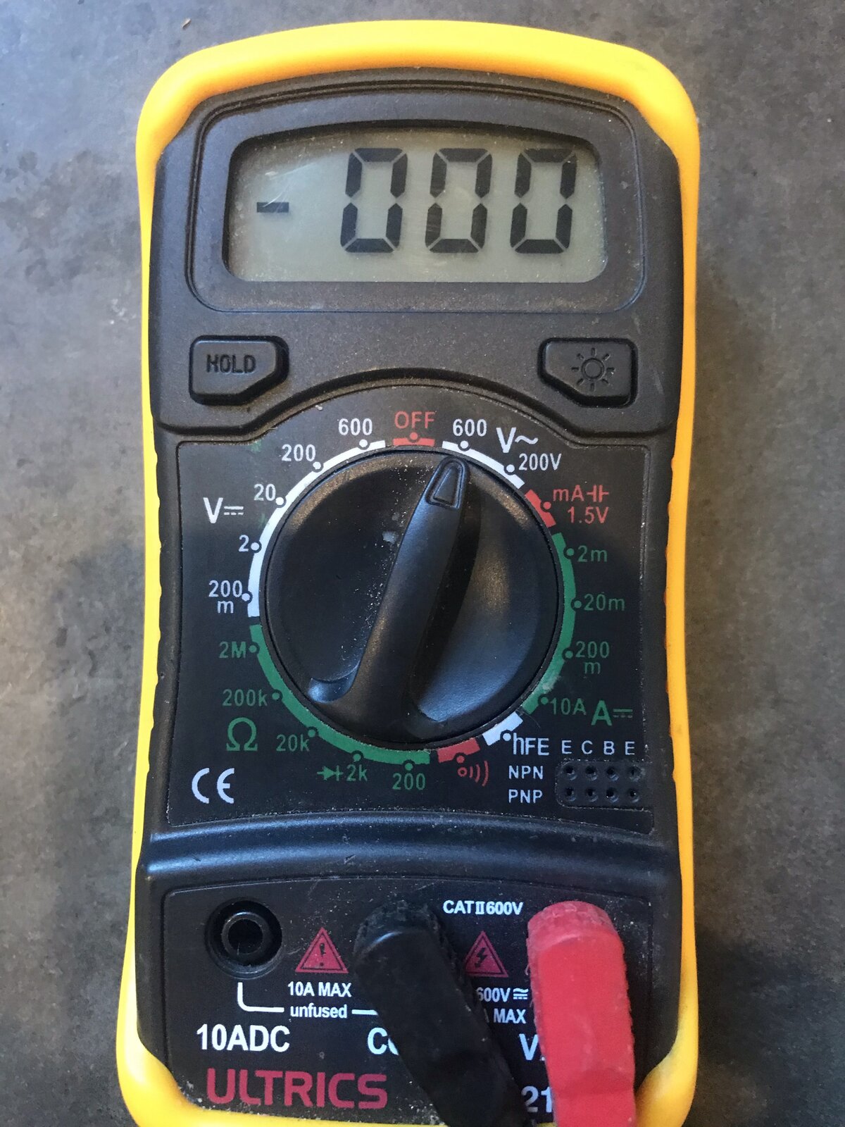

Hmmm, just check the power via the first two incoming cores and received zero with the meter set as below:
That could well be your issue! I think you need to look into providing a temporary power supply to the unit, see what happens then, before going any further. Quite possible the unit itself is fine, and the problem lies with the power supply.
