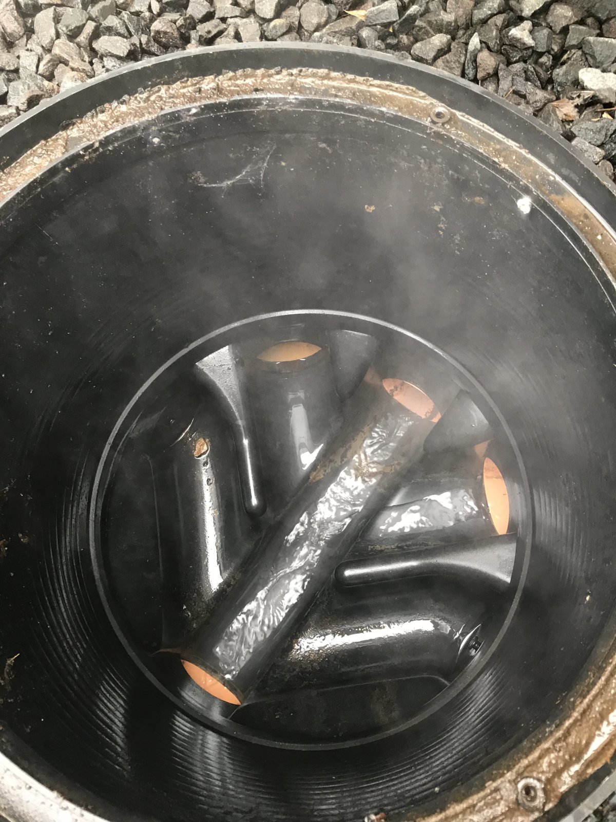

I'm struggling to understand why this particular sewer manhole smells so much when theres no blockage and everything is running freely.

Could be a belly in the pipe, causing waste to lie in the pipe, which could cause a hum. Can you put a photo of the problem manhole up, we might see something that you dont realise is an issue.

Cheers Hugh, you've been really helpful throughout this. Here is a pic of the manhole in question. As mentioned before everything appears to be moving freely down to the tank.
just looking at the venting and one half of the house is vented but the other side in question doesn't appear to have any vents!
Nothing untoward there, sometimes get those chambers especially, where the drains have been laid to too steep a fall, the effluent comes flying in from the laterals at a ridiculous rate of knots and plasters the opposite side, building up in the unused inlet channels. Eventually it causes the chamber to block....
As long as the drain is ventilated at some point, (should be the head of the drain), then that's not an issue in itself, but doesn't answer your issue. Is there a smell at that chamber?
Thats good to hear Hugh. I can't see any vents from this side of the house and yes its this chamber that can began to smell and its the first one that the ensuite hits after leaving the house.
