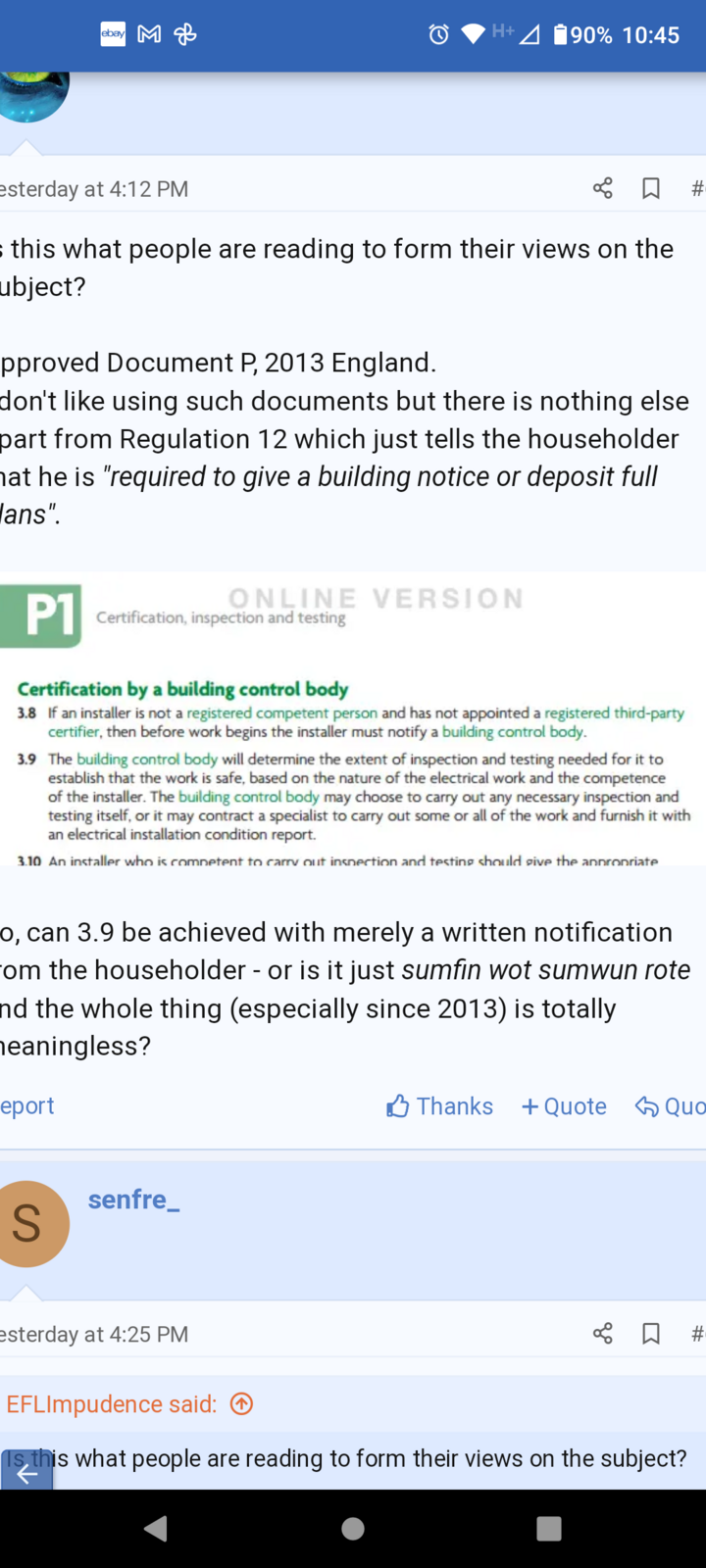

At least one LABC I have found says if they do a final test on a non professional install at the end, it may only be for the notifiable parts. Anything non notifiable may not be tested.
Well, given that the LABC is only involved/interested in notifiable work, I suppose it's perfectly reasonable that should restrict their I&T requirements in that way. Afte rall, if all of the work, no matter how extensive, were non-notifiable, they would not be involved at all. However, as you go on to say ...

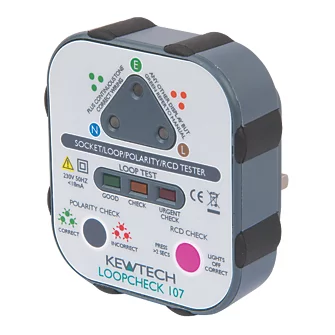

I will be doing testing throughout, and will probably invest a few hundred quid into testing equipment, but something like a multi-function tester would be an unjustifiable expense for me. That will still give me, say, 90% certainty that there are no faults.
But if / when the BCO rocks up with his Megger around his neck, I'll have total certainty. And seeing as they have to do it anyway, why not lean on it..
Now I am confused, to start you say LABC are to inspect and test, they your inspecting and testing? I now also have the problem with lack of test equipment.

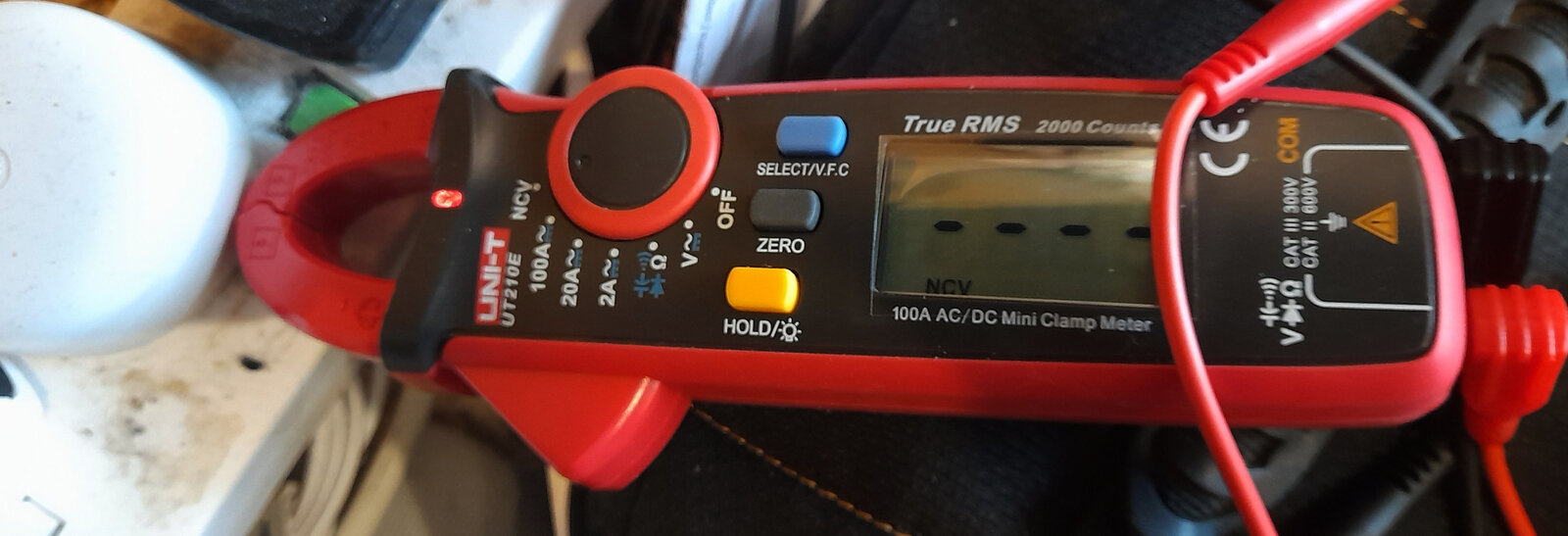

The insulation tester VC60B.jpgand clamp on meterTesting for live.jpg are cheap enough at £35 each, lucky also have my old insulation tester that also does low ohms, but loop impedance tester and RCD tester are darn expensive, I can borrow them, but then still need calibration certificates, so likely best idea is to hire. It seems between £50 to £60 per week, and a plug in tester with loop 1691308571223.pngcosts around £60 so hiring does seem the cheap option, the plug in testers do not go low enough to test a ring final.

Even that section posted a few pages back says that the LA will (presumably depending on the extent of the work) get an electrician to carry out an EICR
