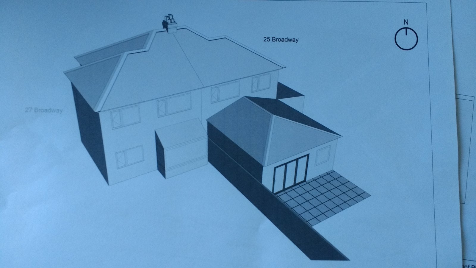

Hi, we wish to build the 6m deep rear extension illustrated above under PD. We are keen to get going ASAP. Initial informal discussion with our attached neighbours suggests they may object (at the time they were considering moving (but now aren't) and said if they were then they wouldn't object - as the precedent would add potential value to their house - if they didn't move they wouldn't be too happy about the effect on their "view" from their bay window) and would probably object.
My question is would this be considered relevant by the Council (and what other relevant objections could their be)? I don't really understand the phrase "loss of amenity" or how much of it has to be lost before the council refuse permission. Also as part of the consultation do we get the opportunity to agree amendments to the design to address valid objections raised or do they just say yes or no, and can we submit a revised application?
I've only just done the drawings and am preparing to discuss with our neighbours so would like to be as clued up as possible. I suspect they may want us to compromise on distance to boundary (it's right up there at the moment) but I'd prefer not to unless it's the sort of thing the council may "suggest" if they get involved - in which case it would be better offered now?
Additional info: the gardens are large - there is another 15m beyond the extension, the ground rises up from the houses so the extension will sit quite low, I have minimised the eaves and ridge heights as much as possible, the orientation means their house/garden won't be overshadowed, they rarely use the garden, proposal fully meets all other PD requirements.
I also have drawings for plan B to show them (out 3m with no regard to minimising eaves/ridge height ) because I suspect they may think that if we can't have 6m we won't do anything.
I'm hoping we can reach agreement, they are nice people but I just think they don't like change and would object for this reason rather than anything specific about the extension.
Any advice or suggestions on how we can get this to work are greatly appreciated.

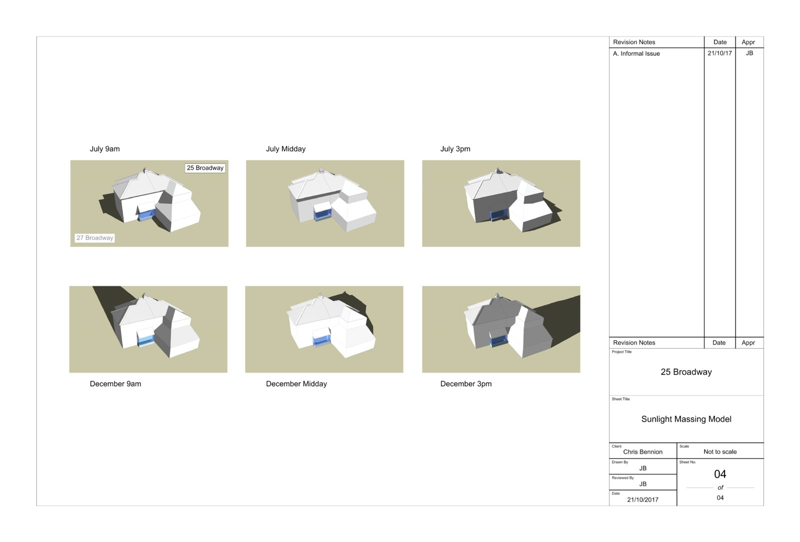

Re: overshadowing and loss of light. Due to the orientation of your houses I personally would rather you had a flat roof - because of the 6m long shadow cast by the roof. Irrespective of low pitched tiles/flatties out of fashion etc. Just my personal opinion if I was your neighbour;)

My student son, who is drawing the pictures, also gave me a sunlight massing model (ignore the second storey) which appears to show limited overshadowing.
It's true that all they will loose is the view into our garden over a 4' fence!

Hi, my son is an architecture student and he did the drawings, I don't know what software but I know he struggled to get the "student version" watermark off and he can't figure out why the front face of the extension roof looks off centre. I think the actual requirements for a PD submission are quite basic - plan view, basic elevations existing and proposed, an OS extract and information about sizes and materials. The 3D ones are more to help my neighbours visualise it.
I think you are placing too much trust in the shading/loss of daylight argument.

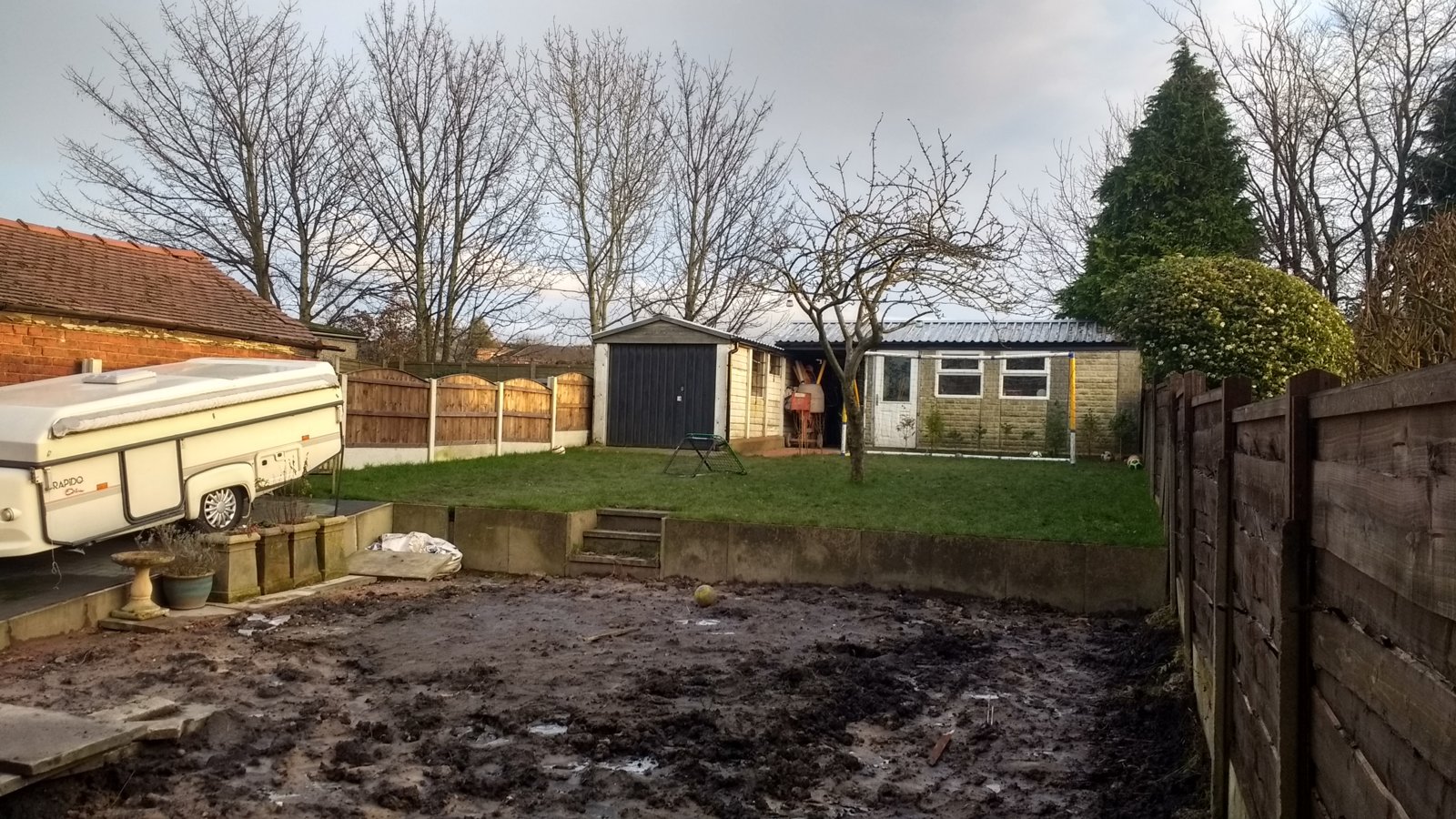

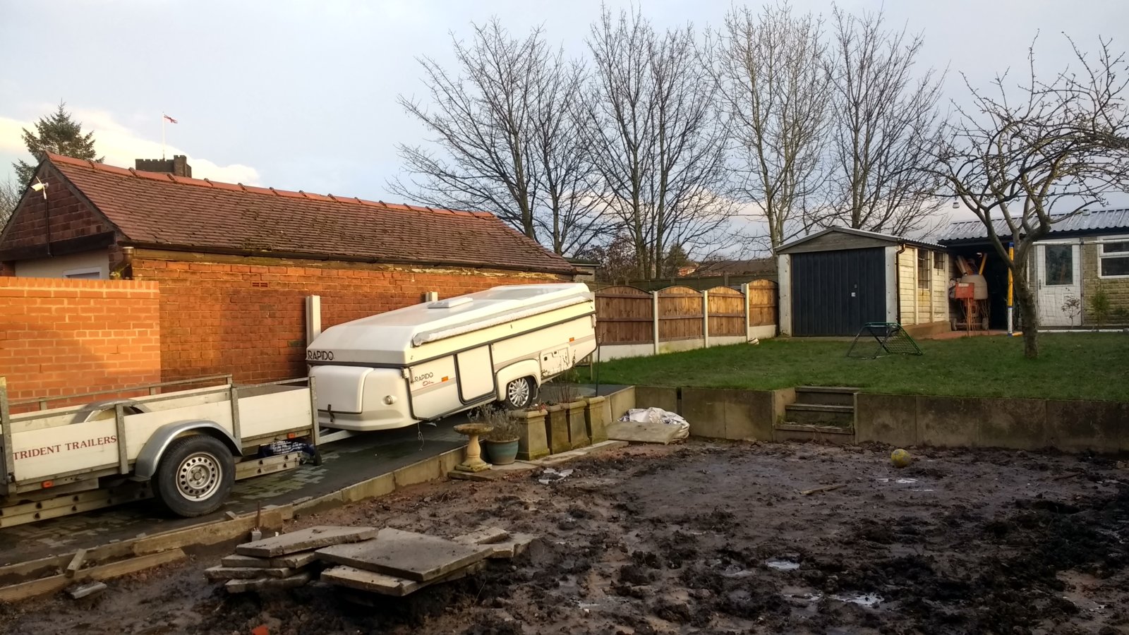

A 6 metre deep extension close to the boundary will be massively overbearing for the neighbour and a huge loss of visual amenity, you are almost building a new bungalow in the back garden. The photo illustrates it quite well from your side of the fence, at present there is a pleasant outlook over gardens with trees in the near distance....imagine that photo with a 3.5m tall 6m deep building in the way. If your neighbour raises an objection I would be very surprised if the Planners accept your prior notification application.
No harm in trying but I wouldn't hold your breath. Good luck all the same.
Thanks, that's a very fair point and gives me an idea of what "Amenity" means in this context. In my defence I would say that their view over my garden isn't quite as appealing (unless you're into garages, trailers, caravans and prefab garages!) and is probably why they keep the curtain facing us permenantly closed!
