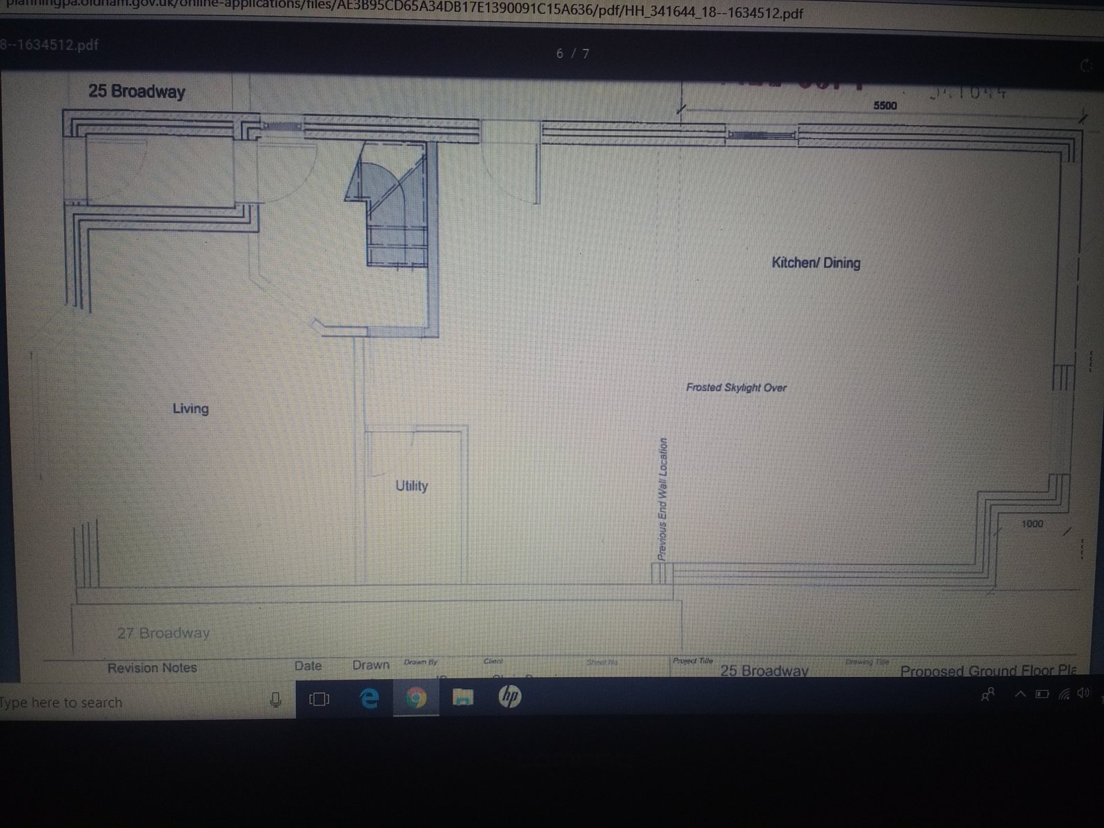

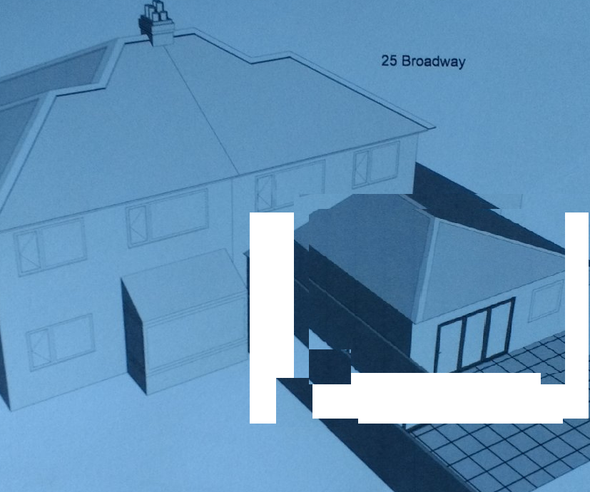

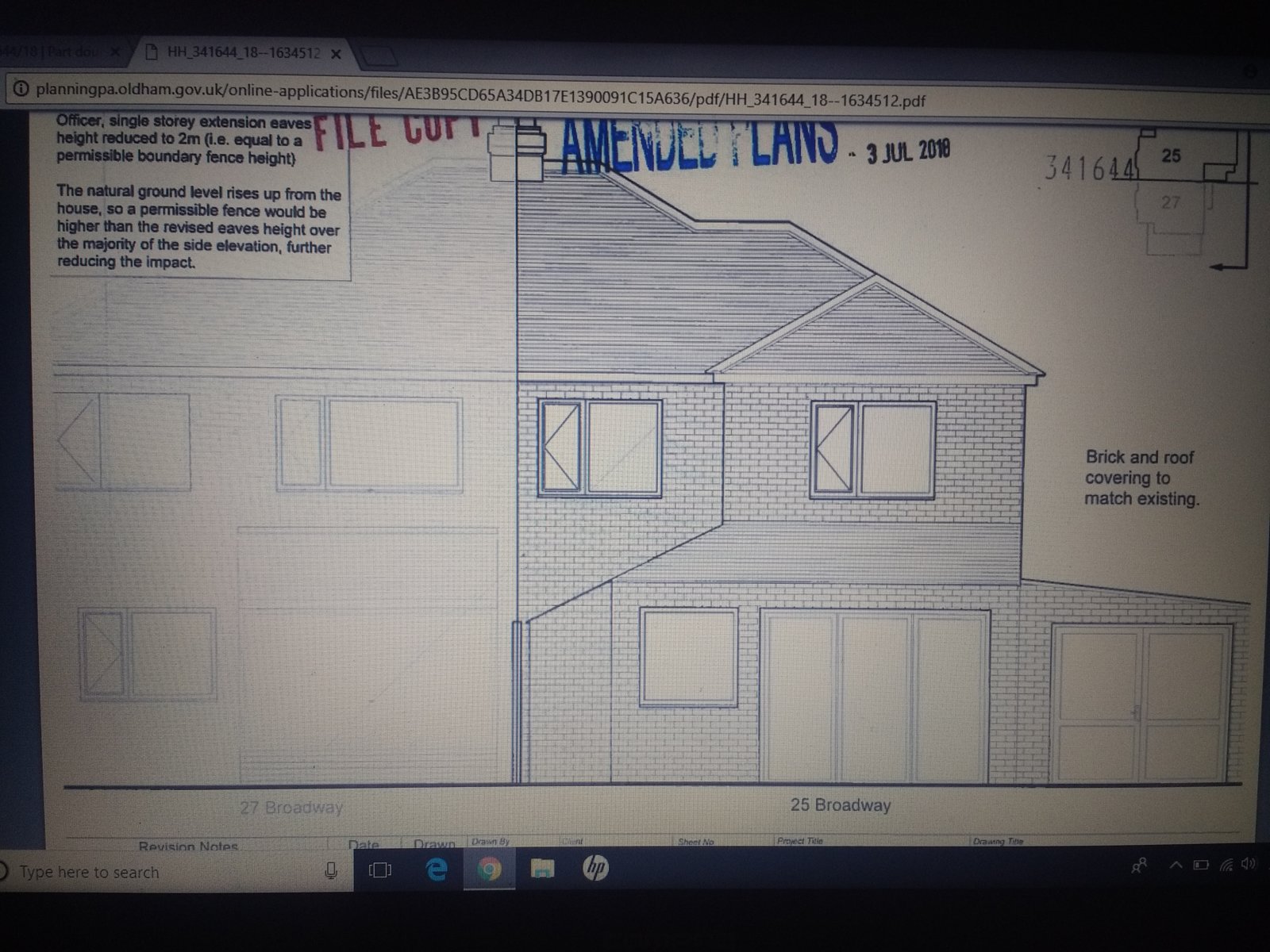

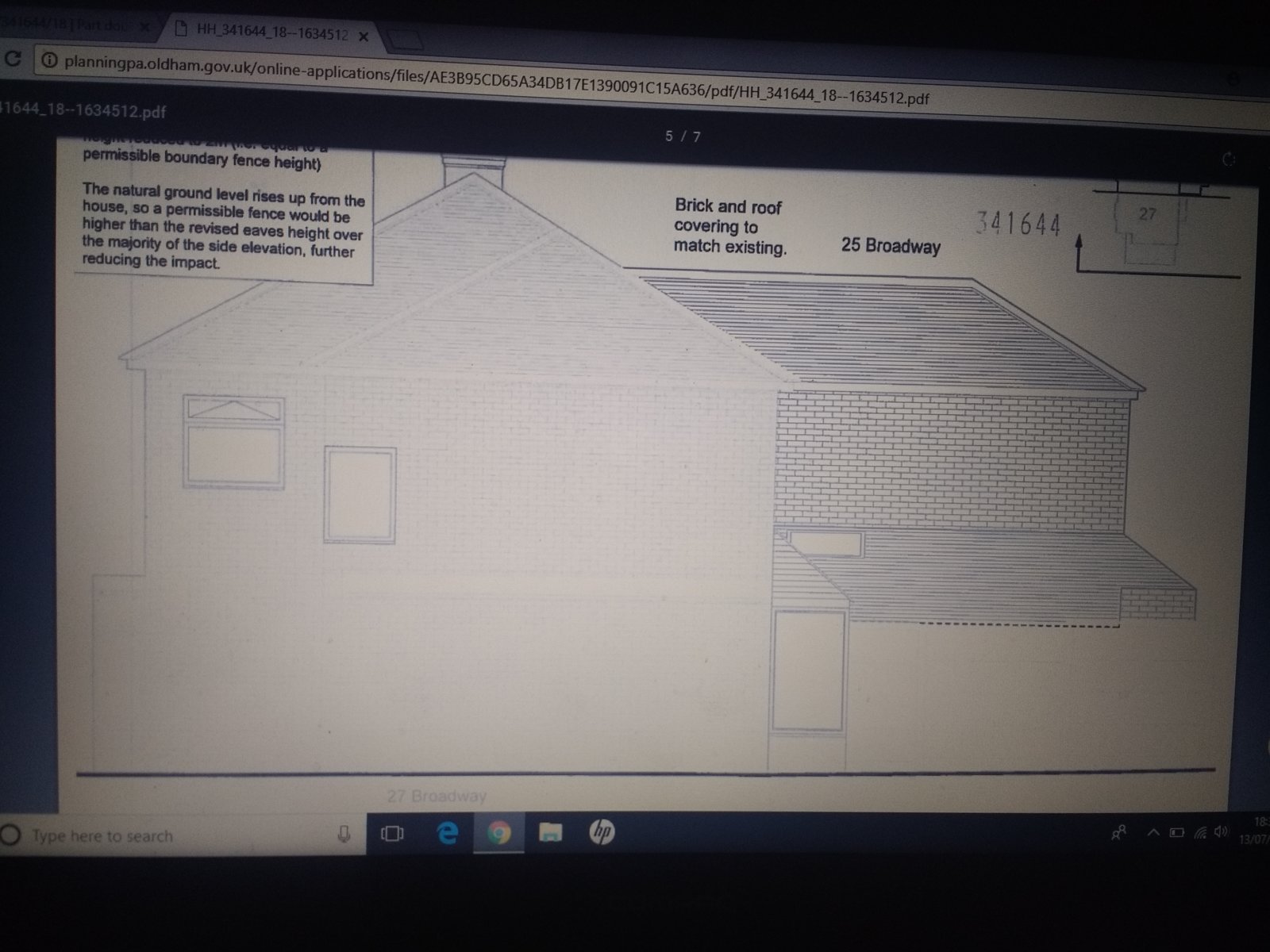

We put in a full planning application for an (only) slightly shorter 5.5m extension with a metre cut out of the corner, but built right up to the boundary, and added a big first floor bedroom (set back from the boundary).
After a bit of negotiation with the planners and the expected objection from the neighbour we reduced the eaves height on the boundary side to 2m and it has been approved!
Personally I think it's arguably "worse" for my neighbour than our original proposal but what do I know.

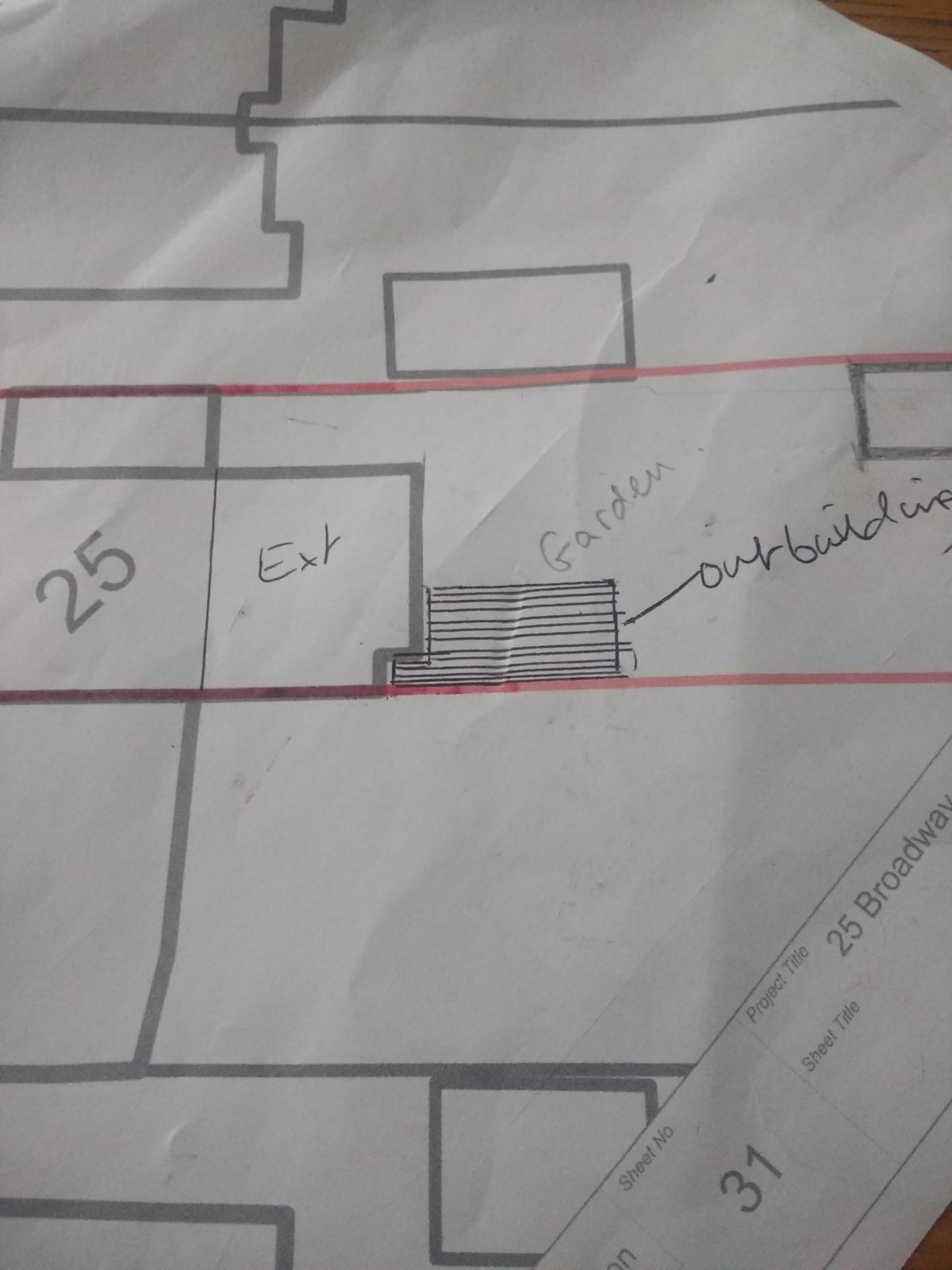

Anyway, I just wanted to ask what the rules are for PD outbuildings - we want to build a detached but adjacent building as detailed in the stripey bit below:
My questions are: height - because it's next to boundary I know it's 2.5m, but our garden slopes up so if it's 2.5 from the highest adjacent natural ground it's going to be at least 2.7 when it gets near the house - is this ok?
Distance from house - how close can I build it? I think it's fairly obvious that it might end up being connected to the new extension in the future, in breach of planning regs (if I think I can get away with it), but at present it will probably need to be separate - I've heard as little as 50mm would be considered separation? Also, should I be building the outbuilding before the extension or doesn't it matter? I know, courtesy of my neighbour, that it will all be brought to the attention of the planners. Should I think about an LDC - to establish the separation from the not yet built extension and because there is a bit of ambiguity over the "natural" ground level further up the garden as we've built it up a bit a few years ago.
