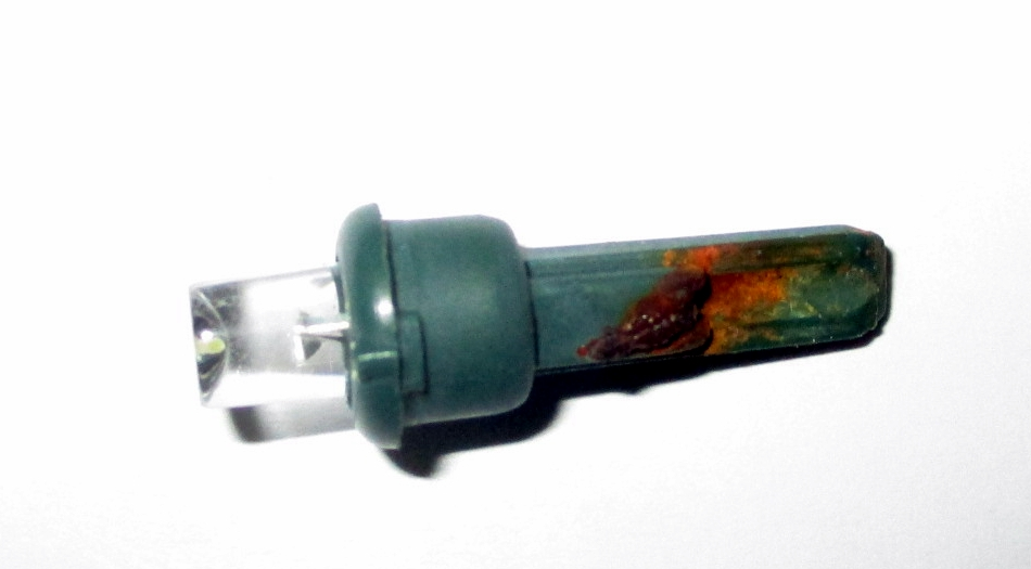

I've done as Andy suggested and cut off the first four LEDs (and their wiring) for inspection.
Somewhat to my surprise, the wire/cable is not too bad. It seems to be 7 x 0.15mm diameter copper. That's about 0.124mm² CSA which (for a pair of conductors) should amount to a resistance of about 355 mΩ/metre. The LEDs are 200mm apart, which means that, at the supply end of the chain, where the current will be greatest ( a bit under 100mA), the VD between two adjacent LEDs would be under 7 mV. Whilst I accept that there has to be a dividing line somewhere which represents 'the last straw', it seems fairly unlikely that a difference of voltages of <7mV between one LED and the next one would result in one, but not the other, failing.
In any event, that is moot , because it transpires that the LED elements (even though 'cheap and nasty') have not 'failed' (which puts paid to nearly all of the suggestions that have been put forward). Although it remains the case that the wires 'disappear' into a solid lump of plastic, it transpires that (once one has removed the coloured 'envelope') the actual LED elements are 'push in (hence answering aptys's question about soldering). When I pull them out, the 'push-in' contacts were seriously corroded (see example photo below) and, when I cleaned the contacts up, all the LED elements worked fine.
The corrosion might simply have been the consequence of storage in the damp cellar. However, some of these sets (I'm not sure of which) have, in past years, been used outdoors, so it is possible that the was some water ingress and that they were put away with water (or, at least, moisture) inside them.
So it seems that the mystery is almost solved. I certainly know why the four LEDs in question "weren't working", but I think I'm still going to have to accept the (what I would have thought very unlikely) co-incidence of this not only happening to four LEDs simultaneously, but to the first four in the string 'just due to chance'!

I powered up a string of LED lamps this afternoon and found that most of them were not working. Very annoying as they are ( were ) used in a sign pointing to one of the Village Christmas Fayre locations. IThe whole thing needs to be rebuilt.
Several LEDs showed signs of corrosion / discolouring in the metal to plastic seal suggesting moisture had got into the LED along the lead frame.
