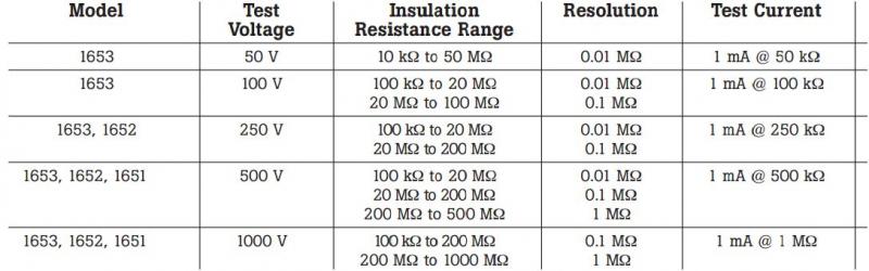

The 1651/2/3 uses 1mA at all voltages, varying the resistances.
To get 100 mA out of 500V, you'd need a resistance of only 5 kΩ (aka 0.005 MΩ). At the sort of IR values we expect/hope to get, the current should only be a handful of microamps.
1mA is the maximum limit of what current it will allow to flow. However, at 500V, you'd only get that 1mA flowing if the IR were 0.5 MΩ or less. At higher IR's the current would be less - e.g. 0.5 mA at 1 MΩ, 0.05 mA (50 μA) at 10 MΩ, 0.005 mA (5 μA) at 100 MΩ and 0.001 mA (1 μA) at 500 MΩ.

Sure, but those tabulated figures are just an elementary lesson in Ohm's Law:
50V = 1mA through 50 kΩ
100V = 1 mA through 100 kΩ
250V = 1 mA through 250 kΩ
and, as I said ...
500V = 1mA through 500 kΩ
I'm sure that, somewhere, it is stated that 1 mA is the maximum test current (which makes sense), but I confess that I'm struggling to find it in the manual.
You obviously cannot be suggesting that the test current is 1 mA for all IRs - as Mr Ohm would tell you, to get 1 mA through, say, 100 MΩ would require a test voltage of 100,000 V - so what did you think the situation was? The current which actually flows is, obviously, simply a matter of the test voltage and the IR - again, per Mr Ohm.
