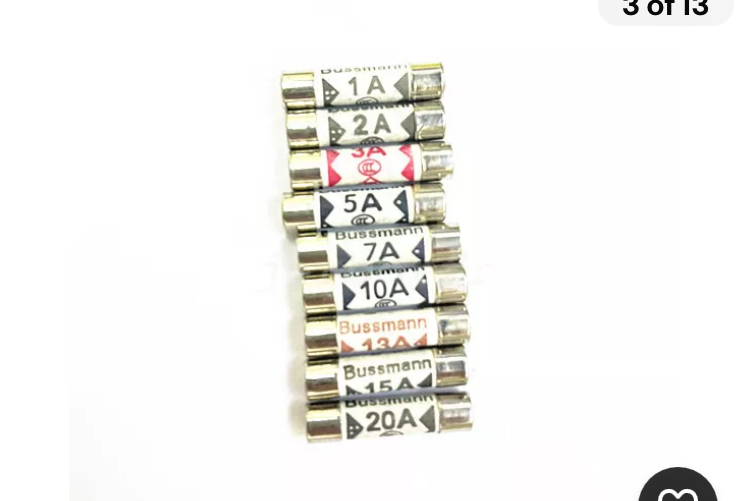

Manufacturer says 15A fuse needed for 2.79kW oven
You cant get 15a fuses that go in plugs.

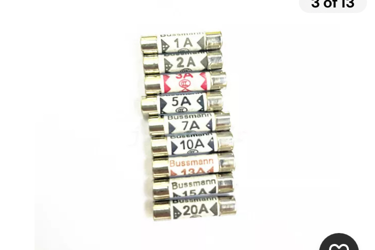

Au contraire! See this set of beauties readily available on a well-known auction site!
As has been said so many times, if a manufacturer believes that their product requires protection which may be greater than that provided by the device protecting the cables which supply it, then they should provide that protection within the product.

And we would all assume they were fakes?
Or not to British standard.
Better than a nail I guess
And we would all assume they were fakes? ... Or not to British standard. ... Better than a nail I guess
I have some ;)

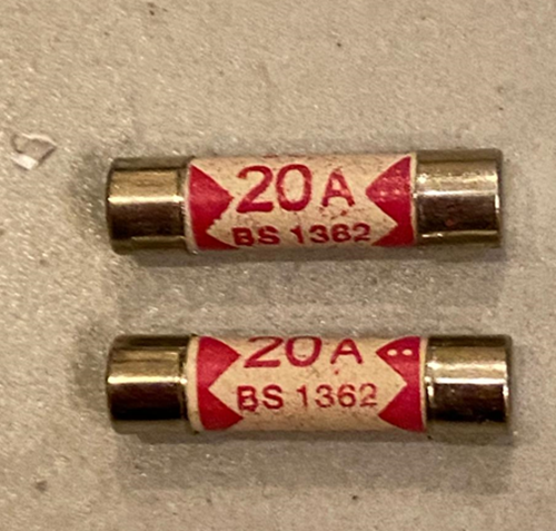

Obviously not to BS1362, although they claim to be (see photo), but I would be far from surprised if they actually 'do what it says on their tin', in the same way that do the (BS1362-compliant) ones from 1A to 13A. The unknown, of course, is whether BS1363 plugs and sockets would be 'up to' currents above 13A, although it would again not surprise me if they were (at least as far as 15/16A)
The good thing about them is that they should would generate Less heat.
And let the MCB trip before the fuse which is typical.
The plug would be up to it. It’s more the socket I worry about

Possibly, but certainly not necessarily, at least in relation to fairly modest 'overloads.. We obviously don't have any data on the "20A" fuses, but if one extrapolates from 13A BS1362 fuse, it could take something like 34A to blow a 20A one - which, in theory, should not cause a B32 to operate (which should take at least 36 to trip. In the case of a very high fault current then, yes, it would be pretty likely that the MCB to probably operate first (with any fuse rating).

The fusing current of a BS1362 fuse is 1.9*In, i.e. 38 A for the 20 A one. The fusing current of a B-curve MCB is 1.45*In or 46.4 A for a B32. So in case of an overload it’s likely that the fuse blows first - provided this plug is the only load on the circuit. In case of a short, the MCB is most likely to trip first with at least a 13 A fuse.
Looking at a BS1363 plug I suspect the weak spot is the fuse holder. All other parts seem quite likely to withstand much higher currents, possibly up to 32 A (nominal current, not under overload conditions) if you managed to cram 4 mm2 conductors into the terminals.
The sockets are a bit of an unknown. I don’t doubt they could be made to warrant a 32 A rating but I‘m not sure they actually are. The contact surface between plug and socket is probably equal to that of a 32 A industrial socket, which is a good start. The questionable bits are the connections between the screw terminals and the contacts, and of course the switches.
That's not much different from the "at least 36A" I mentioned :) I suspect that 1.9 * In is the 'average';, or maybe the maximum. If you look at the curves for a 13A BS1362, the minimum current which should blow it is around 22A - which is what I extrapolated from to get my "at least 36A" for a 20A one.
Well, the magnetic threshold is. However, relevant to 'moderate' overloads (i.e. not 'shorts') a B-curve MCB should operate (thermally), eventually, for any current above 1.13 x In - i.e. about 36.2A for a B32.
Yes, that's essentially what IO wrote. However,there is some 'hit and miss'about it, and I've seen examples of both the things that "one would not expect" - a 13A fuse, but not a B32 operating in the face of a high current fault ('short') or an MCB, but not a 13A fuse, operating in the face of a 'moderate overload' - so one can never be certain (and, of course, sometimes both will operate).
I largely agree with all that - but, as I've said, I'd been far from surprised if a 13A plug + socket could (at least usually) cope with 15/16A, and maybe also 20A (or more).

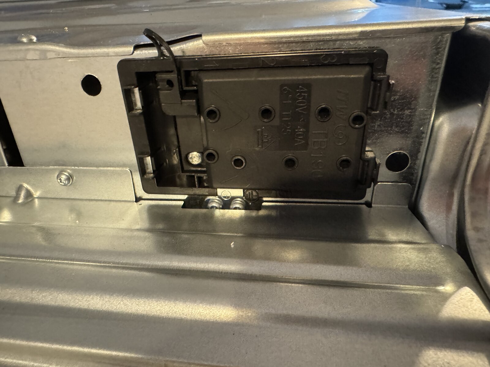

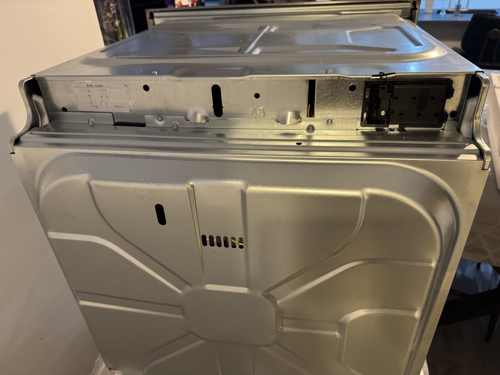

So the oven model from the OP arrive today. Was expecting no plug but wasn’t expecting no cable. Manual says nothing about how to connect cable other than consult a qualified electrician.
I’m quite able to wire a plug to a cable, but wiring a cable to the oven, I’m less sure about. I’m assuming it’s this black plate ?
Any advice appreciated !!
