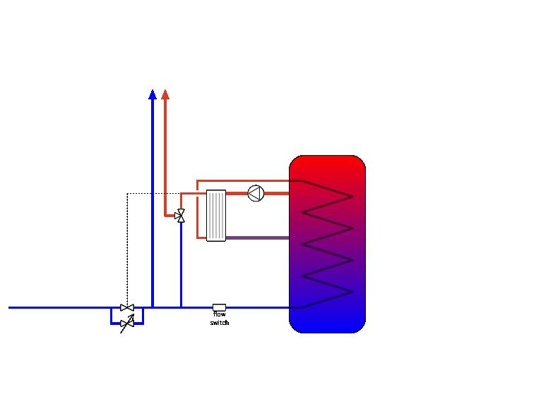

As per my last post, this is an idea I have for restricting the flow if you exceed available heating capacity - either because you've exceeded the heat exchanger capacity, or just because the store is getting depleted and the temperature differential is dropping.
The theory is that the bypass valve sets a minimum flow rate, but under normal circumstances the thermostatically controlled valve will be fully open (hot water is hot). If hot water temperature starts to drop, then the thermostatically controlled valve will start to close and reduce the flow to compensate. Note that the cold water draw off (at least for showers etc) comes from after this restrictions so the pressure balance would be maintained.
Note that this is just an idea I've knocked up, and stability could be an issue. It would be possible to get into a situation where the valve closes because the temperature is dropping, shuts too much, temperature goes up again, valve opens, and so the system hunts. I suspect the answer to that would be to ensure that the response rate of the valve is large compares to the transit time of water through the heat exchanger(s).
Really I'm posting to show that the problem is solvable given the will, and cash, to solve it - and of course the knowledge and skills to design a suitable system.
