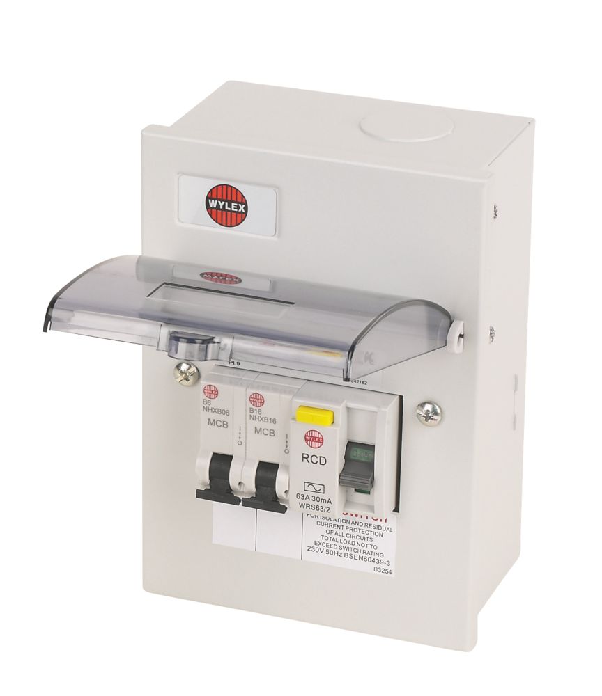

Am I the only person who is 'less comfortable' opening up a CU with an earthed metal case than I am opening up a plastic one? ... and I say that a person who has a reasonably good idea of "what I am doing". I cannot help but think that at least some DIYers, particularly 'dabblers' and those who ignore advice given in places like this (or, worse, do not seek advice at all) are going to be at increased risk if/when metal CUs become more prevalent.
I still do wonder how extensive the 'change to metal' is going to be. Although we appear to be hearing about major manufacturers who have already decided to 'change', I wonder how many will come up with compliant non-metal ones, and to what extent they may be favoured over metal. I guess that only time will tell.

I would also be less comfortable working on a metal CU than an insulated one (although I have often worked on metal dis boards in the past). As for the take-up of metal, that will largely depend on how the manufacturers and regulators communicate with the marketplace. We are already seeing people assuming that all new CUs now have to be metal.
Modern metal consumer units then no, I don't have the same un-ease. its all pretty well shrouded

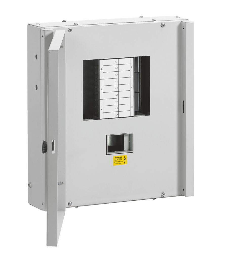

However something like a Dorman smith loadmaster board then yes, plenty of exposed live parts and the cover weighed a lot, had non detachable door which also weighed a lot and would shift the weight distribution.

It's certainly a lot better with modern metal ones, but what I said is still true - even with modern metal CUs, at some level, I still feel 'less comfortable' than with a plastic one. However, my second point is perhaps more important - at least a few DIYers (and probably even some 'electricians') will undoubtedly always do things within CUs which you and I would never dream of doing - and, for them, the presence of lots of earthed metal could surely increase the risks they were facing?

I am sure like myself many electricians have gone into live metal panels and if the panel has been installed correctly there should be guards in place so even after removing the front there is no danger.
There has been many a talk about live working where to measure is not considered as working but where one suspects there is a fault in a consumer unit then it should clearly be isolated before opening and where one is called to for example an over heating fault then the only safe method with a metal consumer unit is to switch off the DNO isolator or if no isolator draw the fuse.
