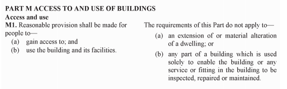

Part M (section 1.18 - 2015 edition) "Access to and the use of buildings" of the UK Building Regulations requires NEW installations to have reasonable access and in particular regard to be made for those whose reach is limited, and for consumer units such that the unit is out of reach of children while being accessible to say those in a wheelchair.
That means means
1. sockets on walls such that their centre line is between 450mm and 1200mm from the ground.
2. Consumer units (and by implication any associated main switches) to be mounted such that the switches on them are between 1350mm and 1450mm from the ground.
There is nothing of course that preclude the continuing use and like for like replacement of existing consumer units etc in their (often dire) existing places where they have often been found. One I know of is in the garage which is very tall and a ladder is required to access the switches, another in a cloakroom requiring you to stand on the loo....

The part m rules say that if something is not compliant then you can't make it less compliant than before. So it should be around 1400, but if it was at 1600 you can't put out at 1800.
Part M says nothing specific about heights and does not, in any case, apply to alterations.
The Wiring Regulations do say similar regarding less safe electrically than before but that would not apply here.

See
https://www.planningportal.co.uk/in...ts/80/part_m_-_access_to_and_use_of_buildings
Scroll down the page and download the PDF of Part M (2015 edition incorporating amendments in 2016)
Go to page 9 of the pdf which is section 1.18
para a) give the heights +/- for sockets.
para b) gives the heights +/-for conusmer units.
That is Approved Document M (guidance, not compulsory or 'law'). 'The law' (Part M of the Building Regs) is only what EFLI posted, in its entirety, in post #25.
