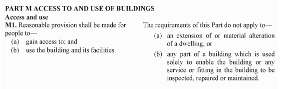

Part M says nothing specific about heights and does not, in any case, apply to alterations.
The Wiring Regulations do say similar regarding less safe electrically than before but that would not apply here.
I haven't found the particular line but taken in isolation that means that if the material alteration is specifically to move a reasonably accessible consumer unit up to ceiling height to keep it out of the way, the law doesn't apply.
That may be the intention, but it wouldn't seen likely given the guidance.i doubt anyone's been prosecuted under that clause of the building regs anyway.
Which line?
Are you thinking that while Part M categorically states that it does not apply to an extension or material alteration of a dwelling - I think commonly translated as only applies to new-builds - it nevertheless applies to a CU, and switches, in an old dwelling?

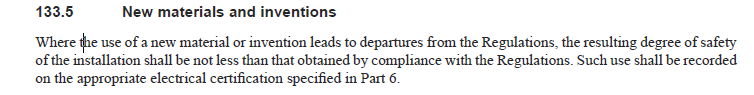

As far as I can make out, and contrary to common belief, I don't think that there is any such statement (about 'no less safe than before') in BS 7671, but there may be in some of the 'guidance' documents (e.g. OSG, Approved Doc P).

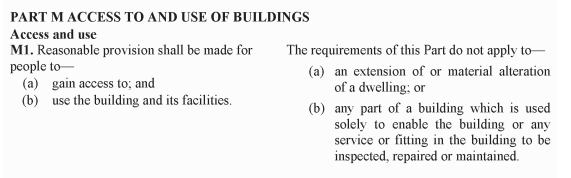

P.S. Ignore the 'attachment'. I inserted the image in error, and can't get rid of it!
All of the height stuff is in part m not bs7671, and in the definitions section of the building regs legislation it defines a material alteration as one that either makes a compliant installation non compliant or a non compliant one less compliant.
So as i pointed out before, it seems a little odd that part M only applies to new dwellings as build or conversion time, but as soon as it's completed you can basically do whatever you like.

Are you thinking that while Part M categorically states that it does not apply to an extension or material alteration of a dwelling - Ithink commonly translated as only applies to new-builds
New builds and conversions
I was just making an observation, that it seems odd that the moment you finish building or converting, you can throw part m out the window and do what you like. Without finding the quote i can't confirm what i previously read. But it was in the guidance anyway.
It does. However, that definition is talking about compliance and non compliance with the requirements of the Building Regs (i.e., in context, 'Part M') which, as we know (and unlike the various 'guidance' documents), and just like Part P, contains absolutely no 'detail requirements' at all.
Kind Regards, John
Even without detailed requirements I'm not sure many people would say moving a cu from 1400 to 2300 was making it easier for people to use it. Even the OP said it was to get it out of the way not to maintain its accessibility. Although it looks like that law doesn't apply to subsequent modifications anyway.
I'm sure that most people wouldn't. However, the definition of material alteration you're citing merely requires that something previously compliant is not made non-compliant, and I'm not sure that making it 'less easy to use' would necessarily make it non-compliant with "Reasonable provision shall be made for people to ... use the buildings and its facilities" (which is the only 'requirement' for compliance), does it?
However, isn't there something very odd about this 'material alteration' business (even when there IS 'material alteration')? 4(2)(b) of the Building Regs appears to be essentially saying that building work which involves a 'material alteration' is 'not allowed', but Part M says that the requirements of Part M don't apply if the work involves a 'material alteration'! I can't help but wonder whether their use of the term 'material alteration' always corresponds to their own definition of the term!!

I'm confused - how do you interpret all of that?
It's a bit of a cyclical reference, a material alteration is one that makes it less compliant, but it doesn't apply to material alterations, therefore is hasn't become less compliant, however it was only excluded because it made it less compliant....:LOL:
