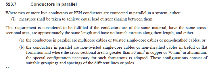

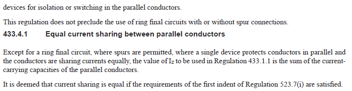

are parallel cables slowed here. So mains earth is 16mm but can I run 2x 10mm.
where I was this was allowed but if it’s not here I won’t do it.
Cheers.
are parallel cables slowed here. So mains earth is 16mm but can I run 2x 10mm. where I was this was allowed but if it’s not here I won’t do it.
Probably not regarded by some as 'ideal' but, yes, 'allowed' ...
... and 523.7(i) says (I'm not sure what counts as its 'first indent'!) ...
Kind Regards, John
