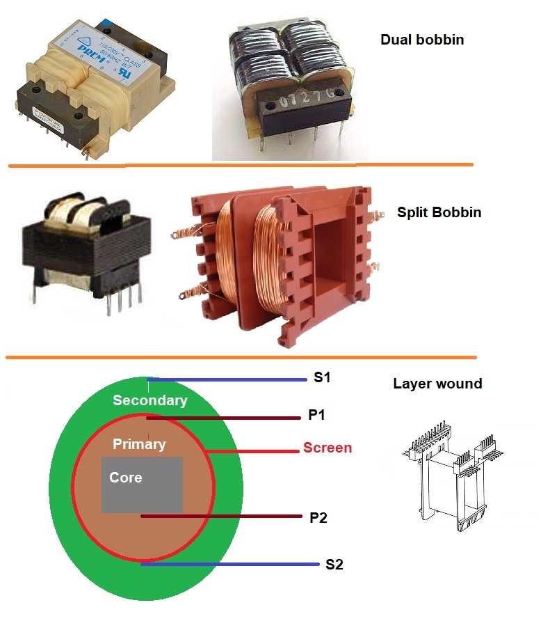

There are two critical components in the isolation barrier in an SMPS ( Switched Mode Power Supply ) between mains voltage and ELV ( Extra Low Voltage ).
(1)
An opto isolator, most often this a dual in line package with adequate ( 3mm ) separation between mains voltage and ELV ( Extra Low Voltage ). If this device does fail then the ELV will no longer be regulated but the isolation barrier is unlikely to be compromised,
(2)
A small, high frequency transformer, one winding is connected to the incoming mains via the switching system, the other winding is connected to the ELV output. In many SMPS units the insulation ( plastic tape ) between the windings is as thin as possible in order to reduce the size of the transformer and hence the size of the unit.
In small SMPS units the transformer is almost always a layer wound device.
(1)
(2)

I was asked to check an SMPS feeding a small 12 V drill as the user could feel a "weak vibration" from the metal case of the drill. The ELV hovers about 120 Vac above ground/Neutral when measured with a high impedance meter, The voltage between ELV+ and ELV- terminals is 12 volts DC.
Yes, it also happens with aluminium bodied Macbooks. The tingle is from the 100uA (ish) that the cap is allowed to pass across the transformer.
And yet, they are still safe to use.
You can get a similar leakage, from the antenna socket, of many TV's - voltage, but miniscule current behind it.
