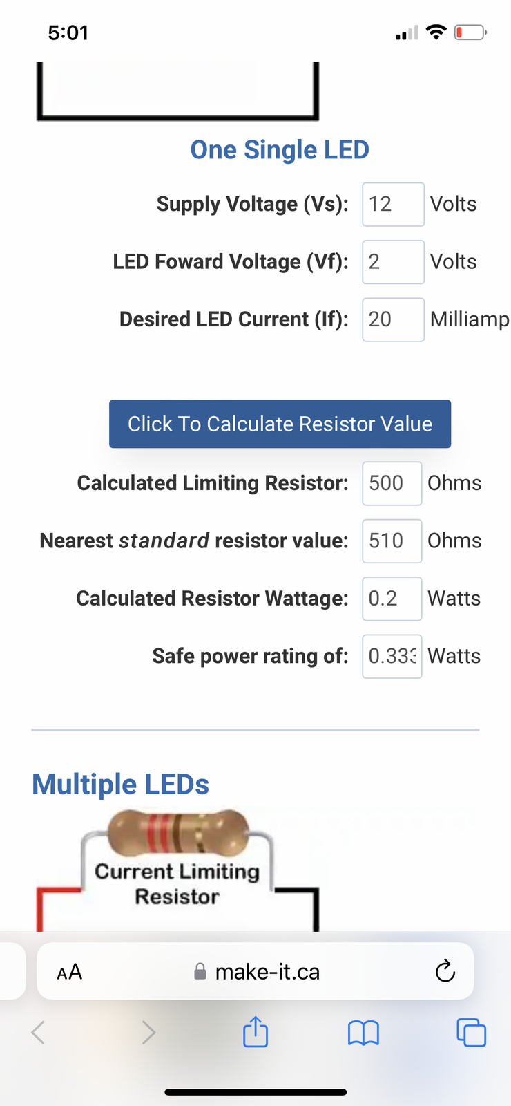

Did you mean 1K there? I have used LED's on 12v so often, that I don't even need to calculate it - 1K everytime.
I am quoting generic spec where the led drops 2 volts and consumes 20mA, not to say there will be others that have different operating parameters and inbuilt ballast resistor
The calculator in following link makes the task easy
I have even encountered leds in optoisolators running off 240 volts ac, voltage obviously reduced, rectified and cleaned to acceptable parameters
I believe your maths may be slightly out with this one
You don’t say Mr Watson
Nothing wrong with maths. Just out by factor of 10 correct value 470 ohms or 510
Which confirms 1K, for a very safe 10mA. ;)
