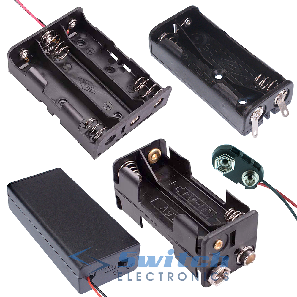

You can run a few dozen LEDs off battery supplies with safety and ease.
That is a very good idea, presumably the batteries would last a good while, given the low demand?
As before:
And with the use of a powerbank, your display wouldn't even need to be plugged in.
If you could utilise a power bank, you would have ample 5V power and it would be easily rechargeable.
I had some Christmas tree LEDs that ran on a couple of AAs continually for at least two weeks

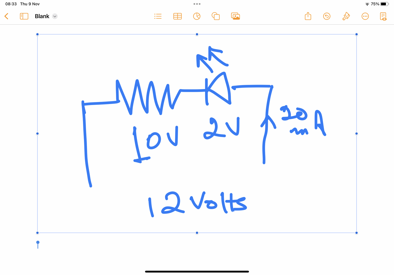

If you chose to use leds, these run at 2 volts taking about 20mA

Resistor value for 12 volt supply R equal voltage divided by current. 10/20mA equals 5k ohms. Often 4.7k resistor used

I'm afraid that is a little backwards.
LEDs are current driven devices, that typically range from 5 to 20mA.
They also have a forward voltage of 1.8 to about 3.3V (for a blue LED).
So, the supplied voltage should be greater than the forward voltage - 2V may not be enough for a blue LED.
Using a 50V supply wouldn't be an issue, we just have to limit the current. I.e.
50V - 2V (forward voltage of LED)/0.01A (10mA) = 4.8K Ohm resistor would be fine.
I believe your maths may be slightly out with this one :)
A 1k Ohm resistor would work.
