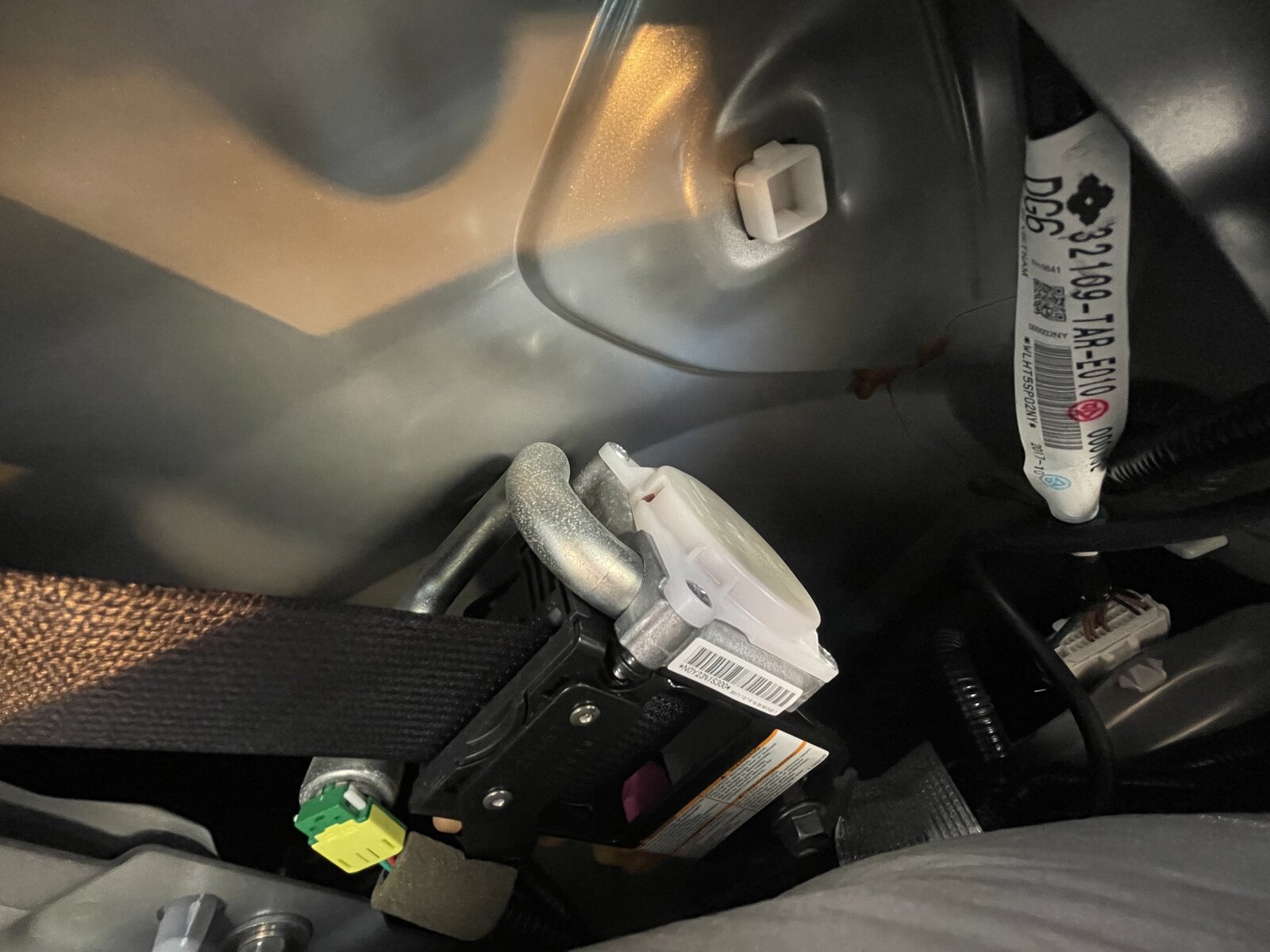

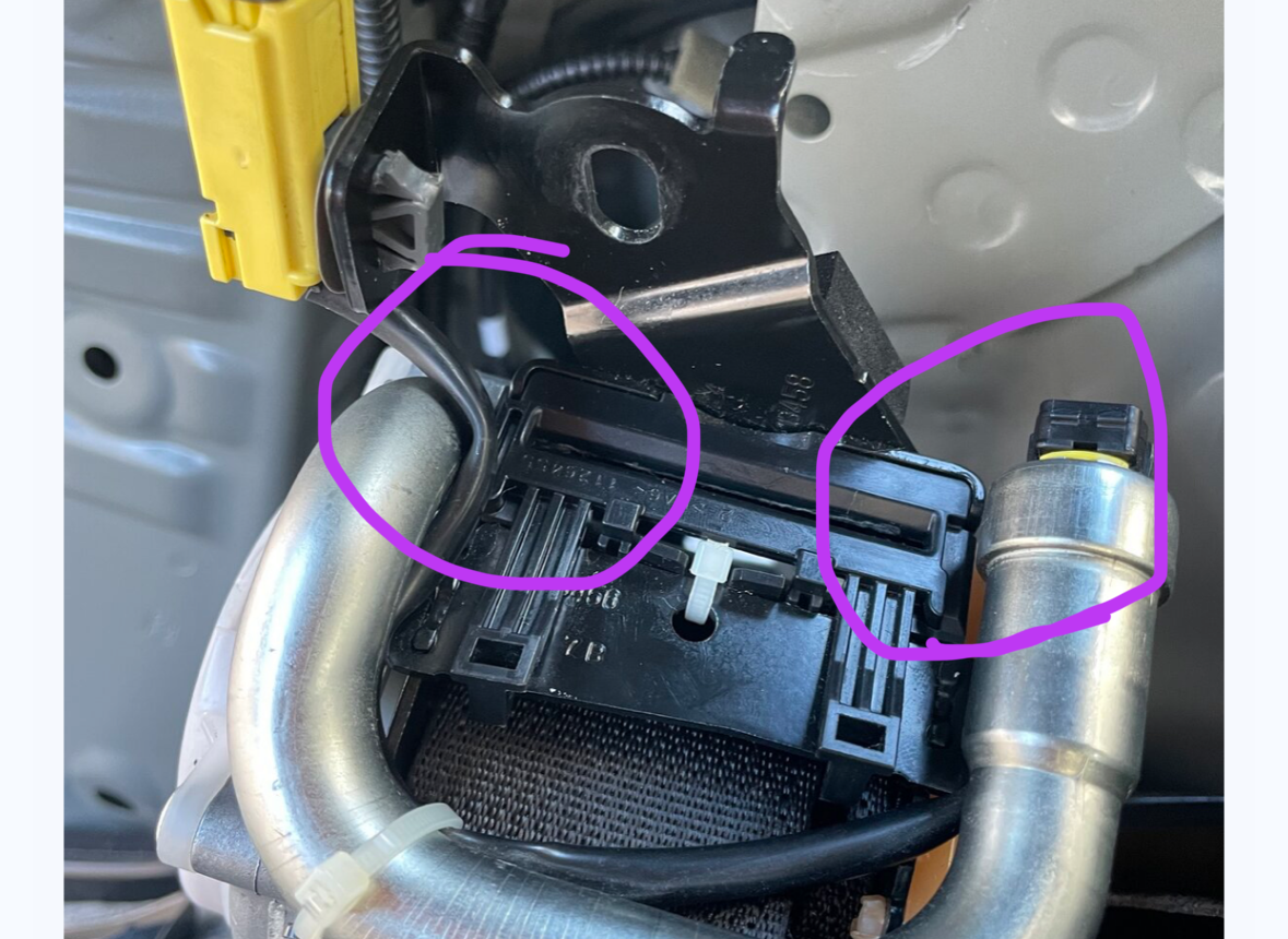

So, I think this was the problem. I think this was cut to reroute around this pipe and basically make sure that it snagged and didn't retract, instead of going through the plastic slot. See picture for the other side below:
Also, do you have the link for that e-bay posting? I think that might be the one!!
But I guess what I was wondering is that if these guys are pros at this, they probably do it in a way that keeps the belts integrity, right? But should probably give them a call to check
I think you need to be really careful there. Everyone will tell you they do it "properly", if you ask!

If you ask them for a couple more pictures they should be able to help, maybe see if you can find the part number off yours
Thanks. I've asked for some additional pictures, although now doubting that it is the correct part. The shape of the pretensioner pipe seems different...

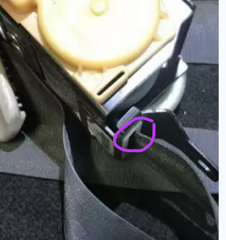

I came to the same conclusion in my earlier post, and posted side by side pictures saying why not
On yours the belt emits from a slot that has the silver pipe near to it on both sides of the slot
On the eBay part posted by thomp that is not the case. Here is why:
If the belt correctly emits from the slot on yours, the sides of the belt will each be approx 5 mm away from some part of the Silver pipe
Now retry and reason that to be true from where you can see the belt emitting on the eBay one:
No part of the silver pipe is anywhere near this side of the belt
The pictures of the item linked by thomp actually seem to be a front belt, judging by other eBay items
EBay item 276935375019 appears to be more like yours, but it has a damaged belt
Perhaps find someone breaking a jazz that looks like yours and ask them for a price on the required rear belt
I presume you've tried and discounted a specialist like this? I don't know then, just a 30 second Google search.

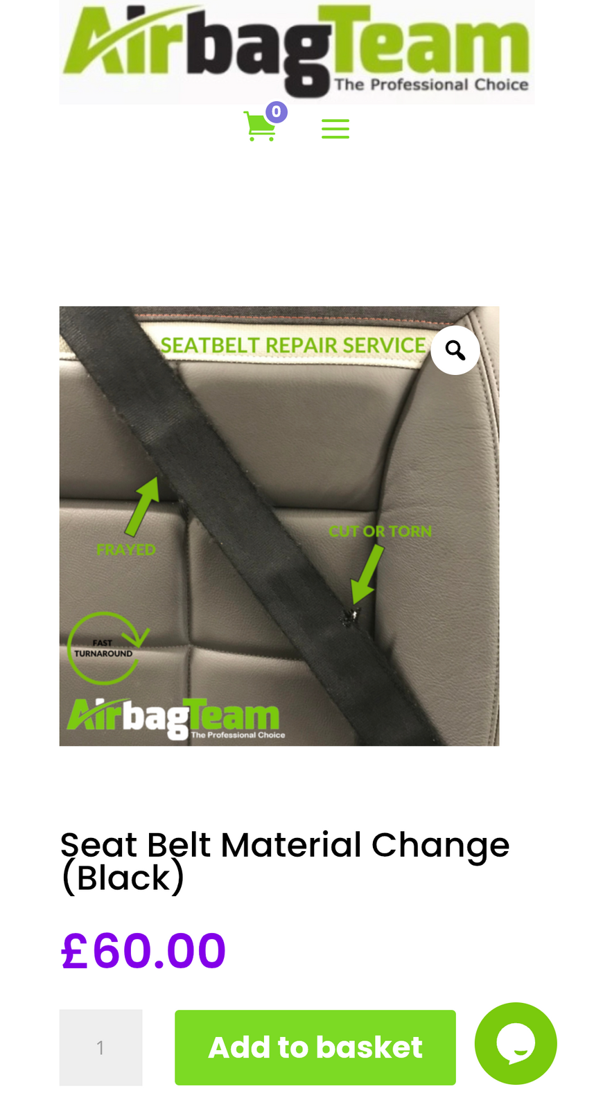

Post #17 gives you a link to a company who can repair your existing belt, who manufacture seat belts for classic and modern cars. You would have had it back by now.
I would disconnect the battery and leave for 30 minutes before touching it. It may be alright but a company called airbag reset or something like that can always interrogate the system and sort it for you.
I’m pretty sure most scanners would clear the fault if it showed up, once the belt is reconnected.
