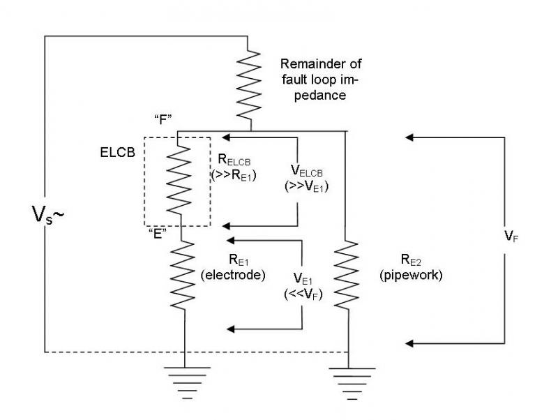

There is no problem with a voltage-operated ELCB in having metallic pipework or other material bonded to the installation (and hence to the ELCB's "F" terminal) and in contact with the earth itself, so long as the reference electrode (connected to the "E" terminal) is located so that its resistance gradient area doesn't overlap with the gradients of any of the other "unintentional" earth electrodes. For similar reasons, it's necessary that the conductor connecting the ELCB to the reference electrode is insulated so that stray parallel paths which would shunt the coil can't be formed (e.g. by running a bare conductor across structural steel in earth contact).
So long as there is no overlapping of the resistance gradients, the earth electrode will still provide a true earth reference and the ELCB will trip when the voltage on the "F" side (installation & bonded pipework) exceeds a certain level.
It's also important that the resistance gradient area of the earth electrode doesn't overlap with similar gradients from neighboring installations, otherwise a fault on that other installation which raises the potential on its earth rod will also raise the potential on the "E" terminal of the ELCB. If there is bonded pipework or other metalwork on the "F" terminal, that will then provide the true earth reference, resulting in the ELCB tripping due to faults on a different installation.

I must be missing something here ....
So long as there is no overlapping of the resistance gradients, the earth electrode will still provide a true earth reference .....
I'm with you, and agree, so far ....
... and the ELCB will trip when the voltage on the "F" side (installation & bonded pipework) exceeds a certain level.
... but now I get slightly lost. If the "F" side is robustly bonded to the pipework and if (as is likely, particularly in the largely pre-plastic pipe days when voltage-operated breakers were common) that pipework is ('unintentionally') also at (or trying to be at) true earth potential, then it would seem to me that there would be no (or, at least, not enough) potential difference between "E" and "F" to trip the ELCB. If there were a substantial fault current to earth, that would obviously raise the potential of both the intentional earth (electrode) and the unintentional earth (pipework), but they would both move in the same direction and, if both intentional and unintentional earth impedenecs were equal, or near equal, there ought to be no appreciable pd between them, even under major fault conditions.
Can you help me understand what it is that I'm missing? Thanks.
What you're not taking into account is the resistance of the trip coil in the ELCB, which is high in relation to the electrode resistance. Obviously any amount of current flowing through the resistance of the electrode to earth will raise the potential at the electrode by a certain amount, but in this case that current is limited by the relatively high resistance of the coil, so the voltage rise, even on a dead short L-E in the installation, will be small, unlike the voltage rise on the "pipework earth" on the "F" side of the ELCB, which is limited only by the loop impedance via that pipework electrode.
With an ELCB, the old Wiring Regs. specified a minimum size conductor between the ELCB and reference electrode of only 7/.029 (or 2.5 sq. mm. after conversion to metric), because the only current it would ever carry is limited to a very small value by the resistance of the ELCB's coil.
OK, in terms of what I wrote, I deserved that :) I confused matters totally by talking in terms of the potential of the earth electrode and the potential of the pipework. In terms of functioning of the ELCB, those potentials are irrelevant, per se; what matters is the pd across the ELCB coil (i.e. between its 'E' and 'F' terminals). However, despite introducing that confusion, my 'belief' (probably mistaken!) that the 'unintentional earth' will undermine functioning of the ELCB remains. Furthermore, I certainly didn't overlook the fact that the resistance of the ELCB's coil is high in relation to the earth path resistance - since that is central and crucial to my argument (since it results in most of the fault current going through the pipwork, rather than through ELCB to earth electrode). To understand 'how I see it', please consider the following rapidly created diagram, which hopefully is fairly self explanatory.
Initially, consider the situation with no bonded pipework - i.e. RE2 does not exist. For illustration, assume that RE1 is 10 Ω, RELCB is 200 Ω and that there is a fault which just results in the threshold value of VELCB for tripping (say 50V) to arise. It therefore follows that the current through the ELCB and earth electrode is 250 mA and that the 'remainder of the fault loop impedence' (forgot to give it a symbol on the diagram!), assuming a supply L-E of 230V is 710 Ω . Now consider that same fault but with bonded pipework (hence RE2) present, and with RE2 = RE1 = 10 Ω (quite plausible). RELCB, RE1 and RE2 together are equivalent to a single resistance of about 9.55 Ω, hence total loop resistance is about 719.55 Ω and total fault current about 320 mA. Of that total, about 305 mA will go through RE2 (i.e. through pipework to earth), and only about 15 mA will go through the ELCB to the earth electrode. The voltage across the ELCB coil (between terminals 'E' and 'F') will therefore only be about 3 V, far far too little to trigger the ELCB (assumed to have a 50V threshold).
If it is true that bonding to pipework which provides a low resistance/impedance (I really don't think there's much reactance involved, except in the ELCB coil, so the two will be very similar!) will not have a seriously deleterious effect on the functioning of an ELCB, there must still be something major that I'm missing.
