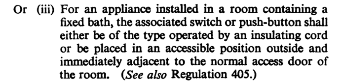

There was a requirement for switches for fixed appliances in bathrooms to be of the pull cord type, but only if the switch was in the bathroom, and that last appeared in the 13th edition in 1962.
However even then it was permitted for the switch to be located outside the room, so the 'electric board' person was still wrong.
That requirement was removed in the 1966 edition.
This may be where the 'pull cords required for bathroom lights' mess originated from, although it was only ever a requirement for fixed appliances. Lights never needed a pull cord in bathrooms or anywhere else.
The fan heater had it's own integrated pull cord operated switch. The switched FCU was outside, above the bathroom door (where most people have such such switches/protection).

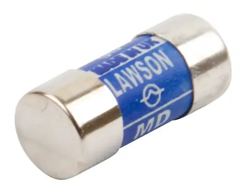

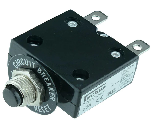

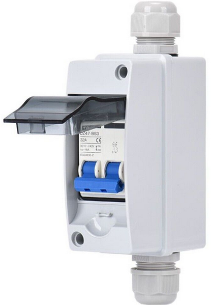

I do feel we need a 16 amp fused connection unit taking a fuse something like this 1702937185686.png for use on cooker supplies and the like to feed ovens, but from a radial not a ring final, and it would need to be made clear not for use on a ring final. Mainly to allow a 32 amp or larger supply to feed multi items designed for Europe where a 16 amp supply is standard.
However I also see the problems, some one is bound to try fitting one on a ring final. But to me these 1702937578909.pngmay do the job, but are not aesthetically pleasing and I would not want one on my kitchen wall. I am sure a unit like a cooker connection unit could be produced to take one 16 amp fuse. However also the appliance could incorporate an overload like these 1702938102367.pngso it could be safely supplied from a 40 amp supply, or even a panel fuse.
