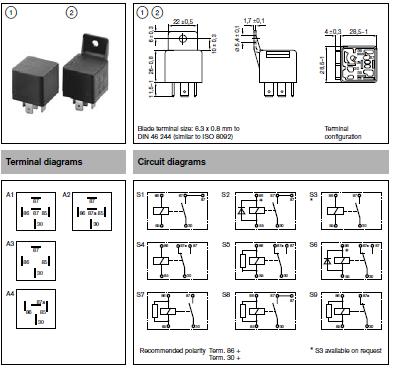

Sorry I made a mistake on some versions the two contacts are not linked but it seems with bosch they are sorry.
But there are other relays available like here like this
maybe not longer made was a long time ago I did auto work. There were some relays used on ford which had different pin config but can't find any now.
I think the one he was using originally was a 25 or 30A relay - standard in a car.

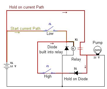

Well I could not see anything wrong with original diagram. Two thoughts spring to mind.
1) Diode had gone short circuit.
2) Been replaced with wrong relay. I think it was ford who used one corner of coil and other corner for contacts. The numbers remained the same but physical position changed and I have seen a few people caught out with it.

No, the current cannot flow in the direction you have indicated on the diagram as the diode prevents this.
If you missed the diode out of the wiring then yes, you could overload the switch. As I have said on a number of occasions now, you need to fit the diodes. As you look at a diode the white line corresponds with the line across the diode on the diagram.

Yes the diodes wear in place
A diode is not there to reduce the current it is there to allow an electric current to pass in one direction and to block the current in the opposite direction
It’s a 4 pin standard 20/30 amp car relay as seen in the original schematic
And a 5 pin would not helf since 87a is just a common and not for reducing current

Dose not matter which way the pins are placed on the relay just as long as you follow the diagram on the rely with relation to numbers
Other wise the sequence would not work

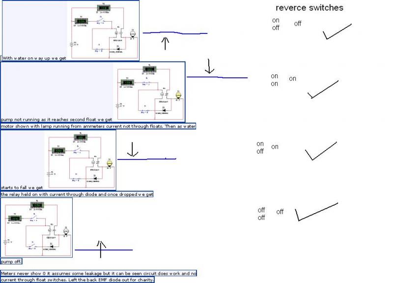

I have looked at your diagram again and swapped the switches round in the diagram
The sequence now works
If you are so sure that the current wont blow the switches then I think I will make a circuit up on my desk

U1 and U2 are not required only inserted to show no current through the floats.
K1 is coil of relay.
This is the same diagram as you already have. Do you know how to test a diode as I think that is all that is wrong.
Master diagram as I say same as what you have only re-draw so I could run it in simulator program. The diode across relay contacts is built into relay it is not in your circuit.

I don't think it will work with a capacitor in there, all it will do is charge up and block the DC current from flowing.
I still don't see what was wrong with the nice and simple diagram I drew before, 2 diodes, 1 car type relay and a couple of float switches. Or use 2 relays, one as a pilot relay to control the other which is then used to control the heavy load.
