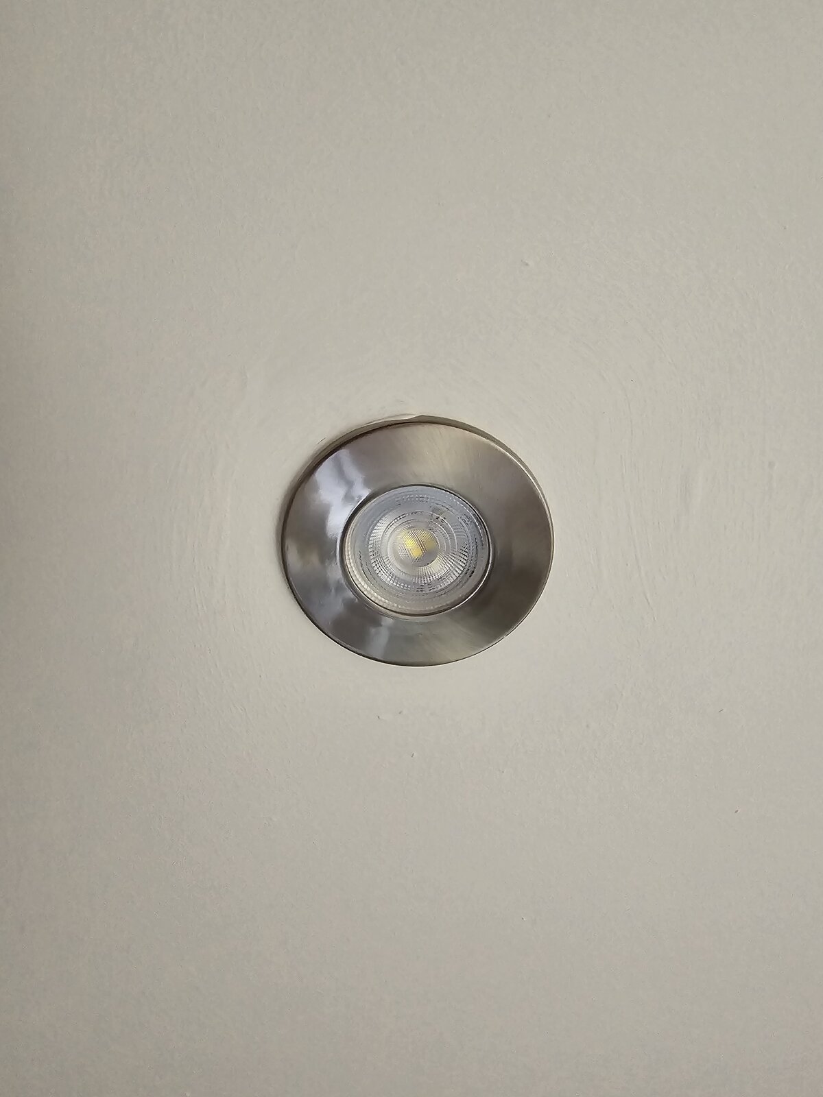

Yes those are LEDs.
As for your quote, there is a minimum load on the device. I think from memory, it's 5W.
Which again, is odd - coz I have 3 4.5w LEDs being switched by another Quinetic switch downstairs without issue ‍♂️

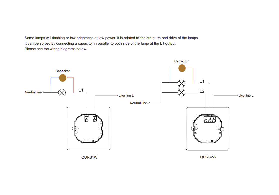

Just got the email from quinetic:
And the diagram:
This is how they look, I assume LED. Can't get to them to check wattage... View attachment 349152
Also, just got off the phone with Quinetic Tech support and they have said to email them and they will provide me with instructions on how to attach a capacitor at each end to resolve this - does that sound right at all?
At each end, no, it doesn't sound right. But the diagram they sent you suggests it can be done in the ceiling rose.
Apologies, I just got the wording wrong because they said "both side of the lamp"
Does that diagram sound reasonable then/is this done all that often? Any advice on where to get one of those capacitors and how one would safely wire them? The last time I messed with capacitors I was 8 years old taking apart old electronics with a soldering iron...

But they presumably are all switched together, so the load will be 13.5W.

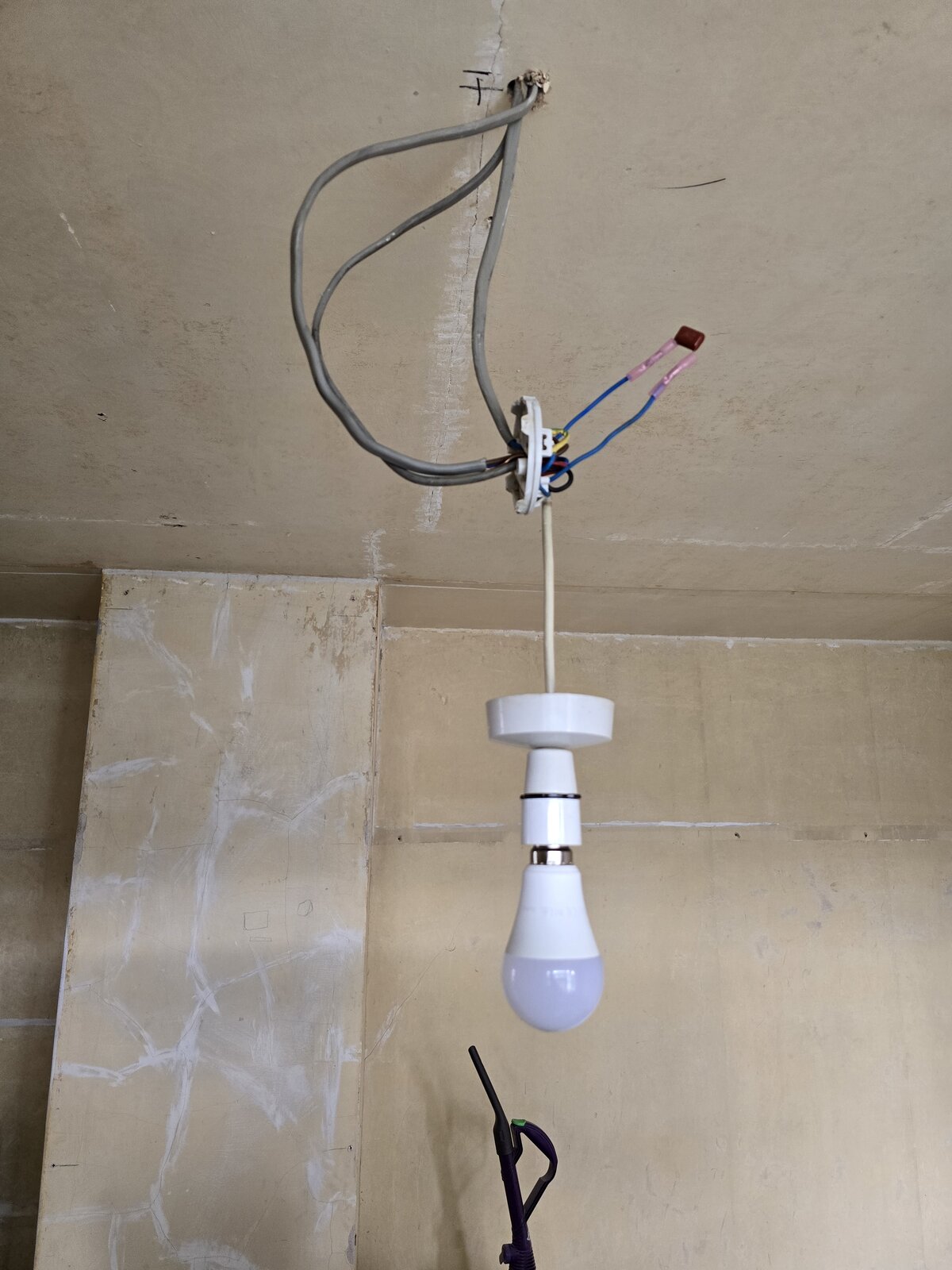

Gonna be fitting the capacitor today, fingers crossed this will be it...
Well, it worked! Currently just a temp job since I will be replacing the rose/light after decorating but at least I know it works!
