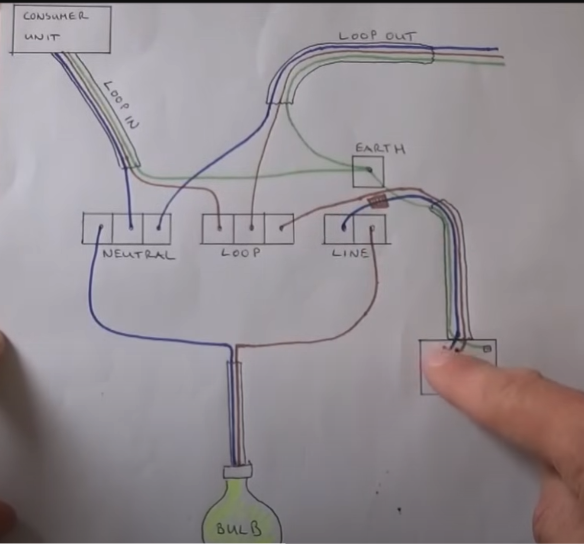

I've been watching a video and it would appear the pendant is connected correctly based on the below screenshot:

Could loop in and loop out wires being the wrong way around cause this? If so, how would I even check which is the loop in vs out? I do have a multimeter.
That wouldn't make any difference - though I suppose you could confirm if live really is live, and neutral really is neutral.
By that, I mean if L and N were reversed somewhere further back towards the start of the circuit.

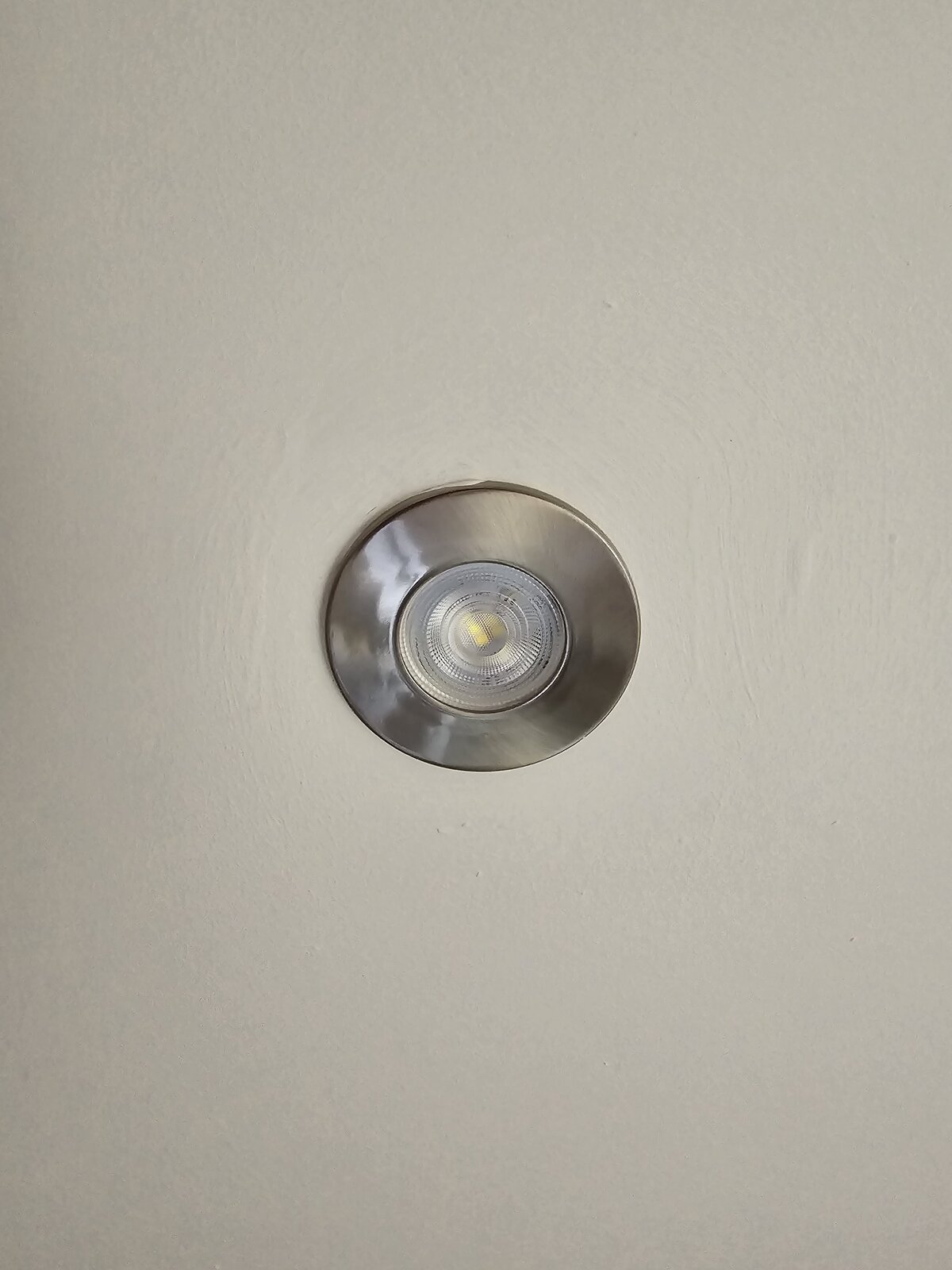

Well, you know it works on the light bulbs in the other room.
What kind of light bulbs are they, how many are there and what wattage are they each?
This is how they look, I assume LED. Can't get to them to check wattage...

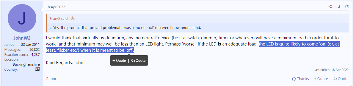

Also, just got off the phone with Quinetic Tech support and they have said to email them and they will provide me with instructions on how to attach a capacitor at each end to resolve this - does that sound right at all?
Yes those are LEDs.
As for your quote, there is a minimum load on the device. I think from memory it's 5W.
